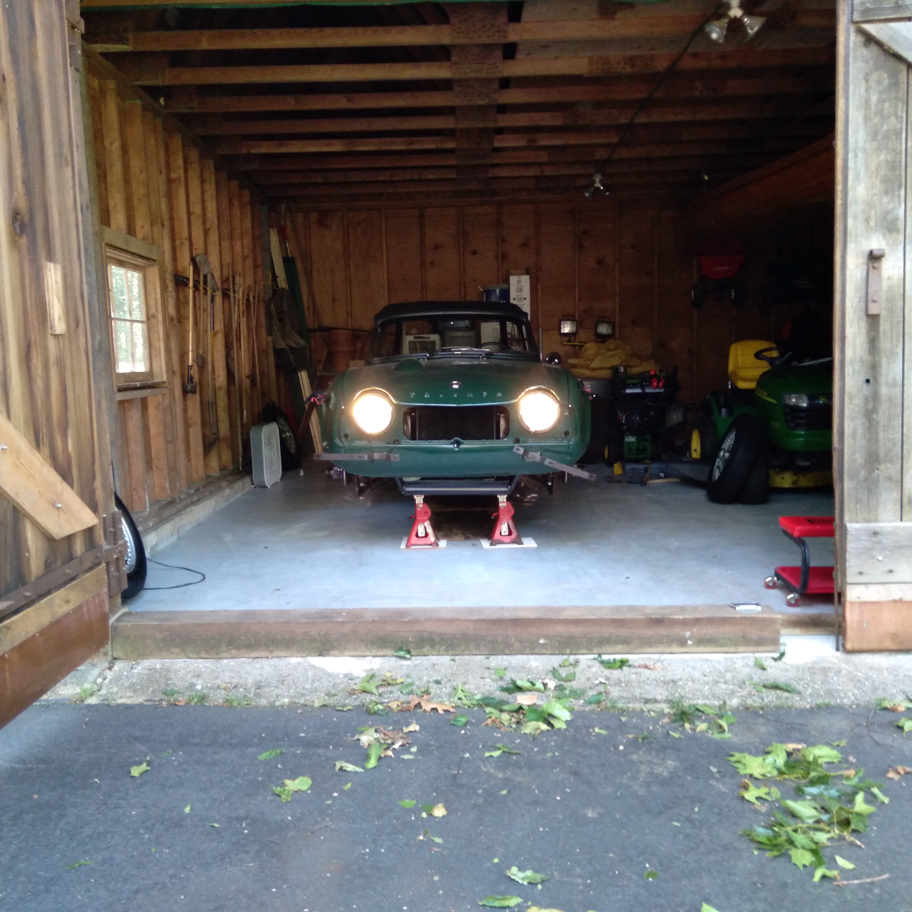

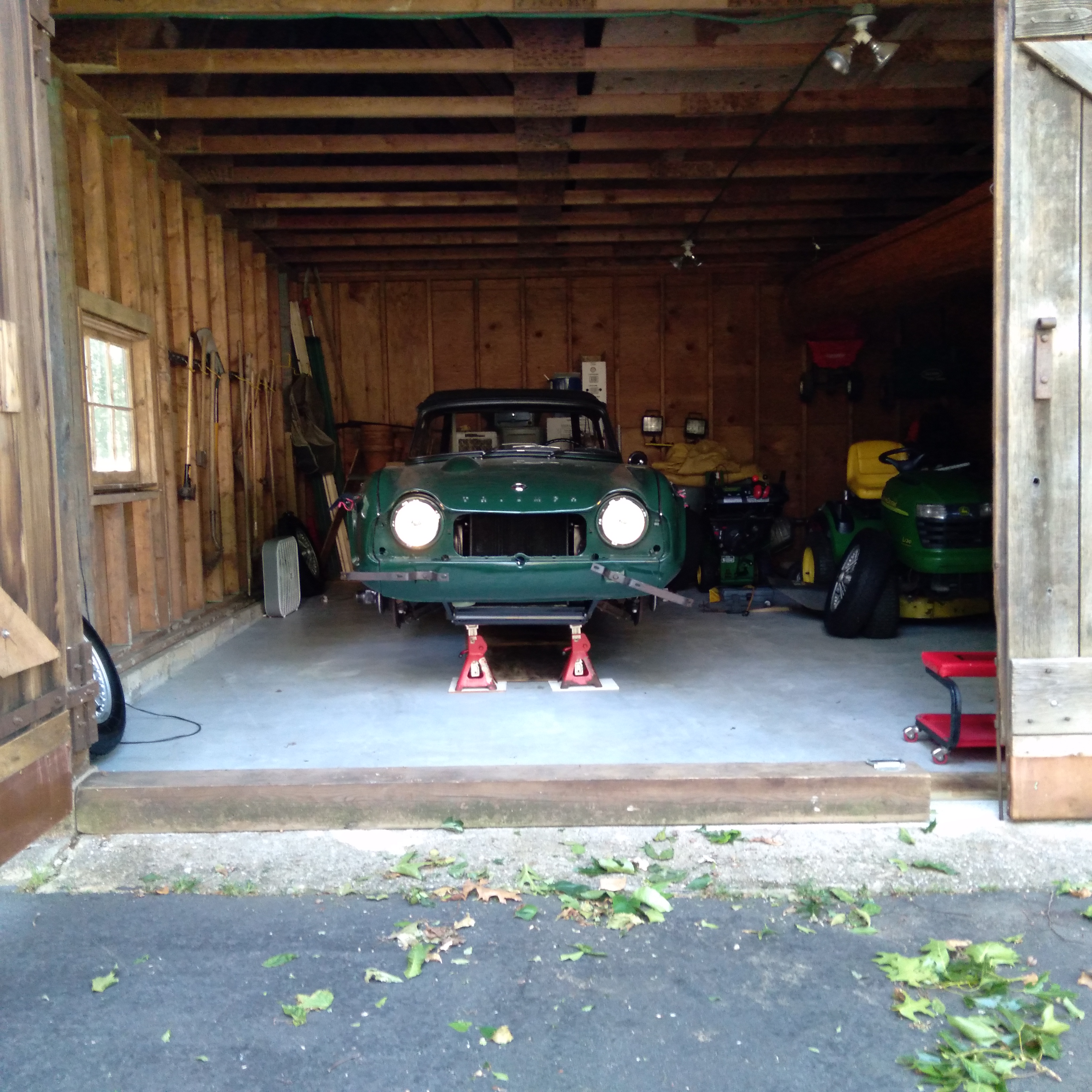

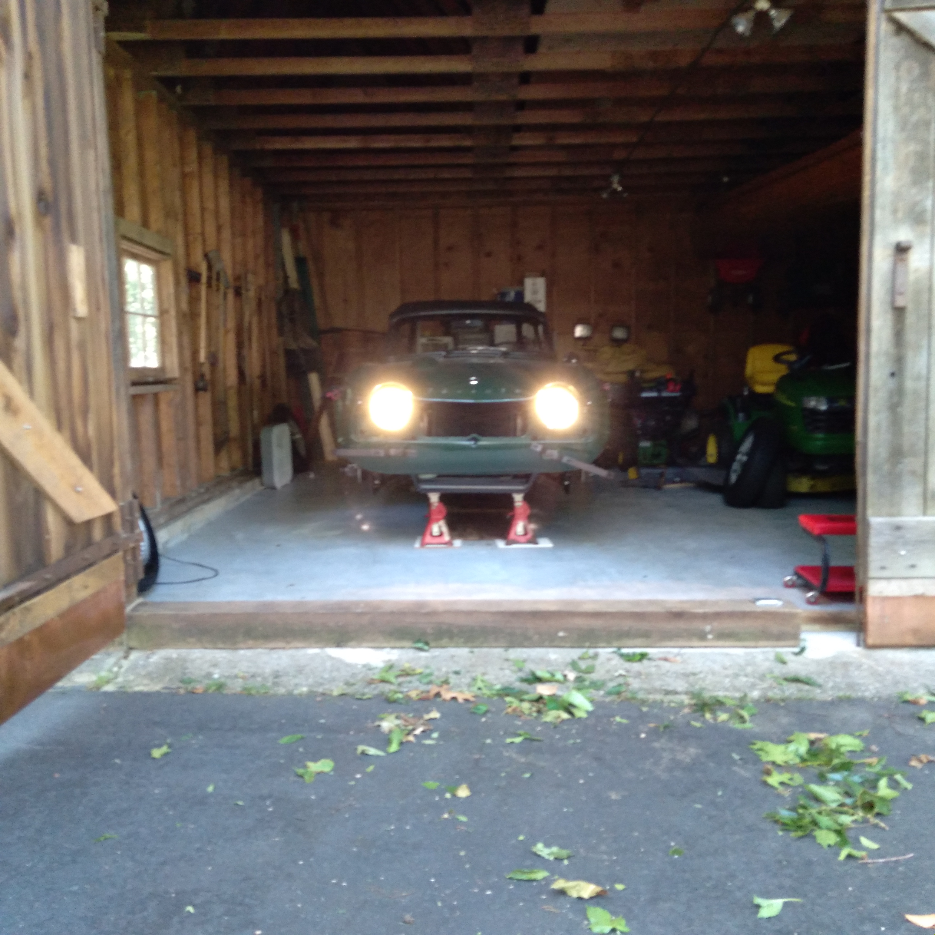

As an aside, I ended up installing a reproduction tri-pod headlight with a "city/side light" feature which accepts a 5 watt T10 bulb. I also got from ClassicCarLED's a warm white LED T10 which consumes 1.5 watts and wired that to the (+) side of my ignition coil - so now that functions as my DRL without having to turn on my parking lights on (they come on with the ignition key). Photos here (hopefully files are not too large)(on jack stands with front grill and bumper removed for other work):
Bob
