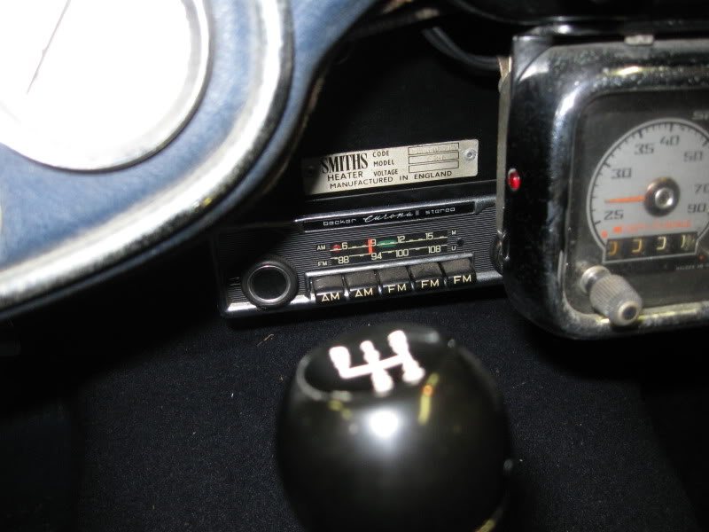

My radio is installed on the bottom of the heater box:
Today, I had to drop the bottom plate of the heater box to get to the back of the radio to install an auxiliary cable that will allow me to play tunes from my iPhone through the car radio. As soon as I dropped it down, I saw a goodly supply of chewed acorns. I had cleaned the box out a few years ago and also at that time found mouse nests in the steel heater ducts running across the front of the car. So the little s.o.b.s are getting in there somehow, most probably through the hot air vent. Rather have them hanging out there than in the wiring or upholstery, though.

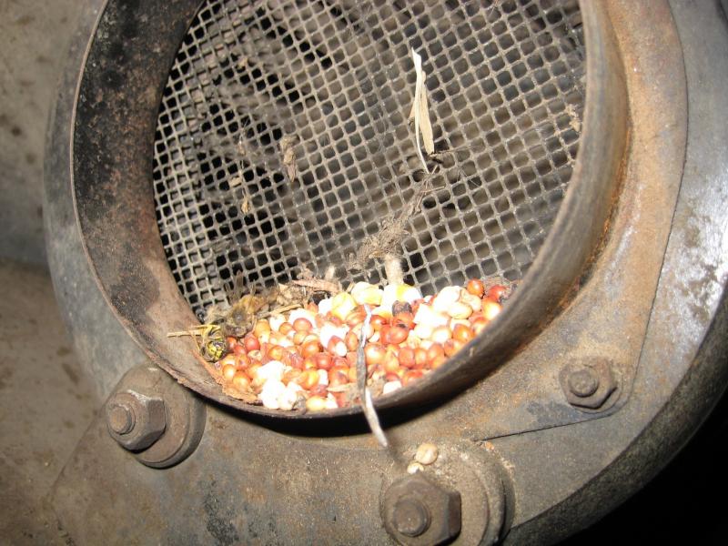

Chewed acorns? I'll see that and raise you some bird seed. I think Donald Healey must have had a soft spot for little critters, so he designed a warm spot for them to gather.

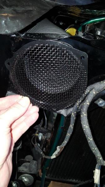

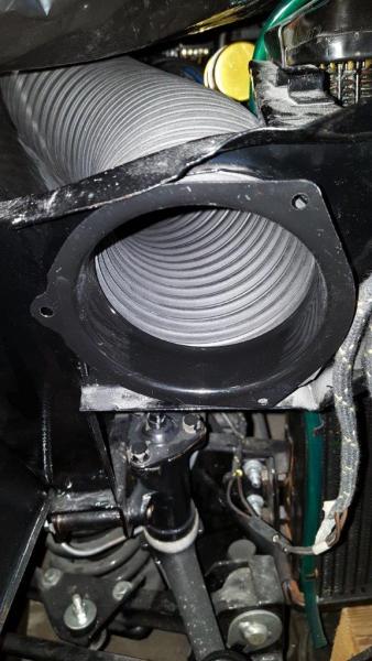

I ordered and received parts meant for the cold air at the fire wall. See attached pics. They are not attached to the car yet. I haven't decided how I'll install yet.

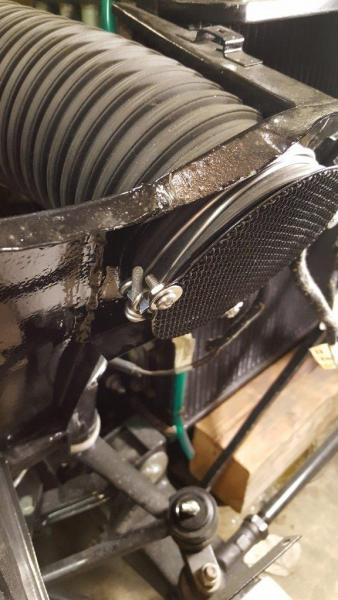

I did install the screen that I mentioned earlier in this thread. I decided to put the clamp on the outside of the frame so that it would have more area to clamp to. It doesn't look too bad given that it's completely out of sight.

Couldn't you just drill three (3) holes in that bulkhead, and bolt the flange onto the inside, sandwiching the screen in between? It would look far more like it was intended to be assembled that way, and the clamp would be inside (and more protected from the elements, at least direct road-spray) when the time comes to replace the hose...

Hey Randy. Yes, I could drill and mount the flange the way that you describe. I might just do that.
