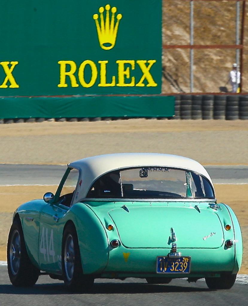

If you can't find a US source with good stock, I replaced my rear plexiglas window using the one AH Spares offers with seals. Fit nice and tight, happy with the results.
