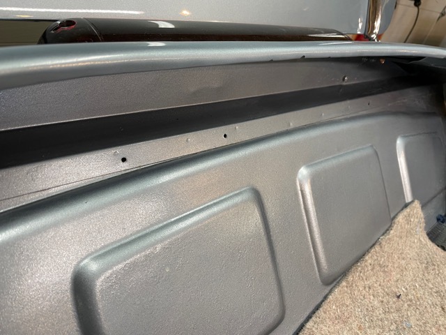

I’m about to cover these holes across the back of the cockpit with vinyl. They have armacord on the back side. What attaches here?

Don't know if mine is OEM or a PO's efforts but I have them on my BT7 and they have pop rivets from the boot side thru the top edge of the armacord, presumably as belt/suspenders approach in addition to the glue for the top of the armacord.

Thanks so much! That makes so much sense. For now I will cover them up then. If the armacord needs suspenders lately then I will address that then.
