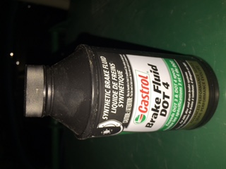

Healeysince59
DoT 4 BF is not synthetic, just a better glycol:
Castrol Dot 4 is synthetic
I asked Castrol about this and their answer was all Dot 4 is synthetic
