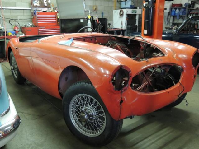

Well, some time has passed and I passed my information to the British Motor Industry Heritage Trust. They came back with a 1960 3000 Mk 1 with chassis number H-BT7-L/12120. Which is kind of what I expected. I couldn't get any other good body numbers off the car in the time I had. I checked a couple pieces of cockpit trim and didn't find anything, but I should have checked them all. They say the original car was black with red interior , but my car was repainted red, but now that it is stripped, its obvious it was originally British White. The mechanics swear it is a BN4 with a 3000 engine which is making more sense. But they think it was manufactured that way.
I suspect that the 3000 (built in 1960 engine because it has the pre-carb configuration) engine was put in a BN4 body at one time (after original purchase). I will continue to search for identifying body numbers on the chassis/body.
I suspect that a 1960 Mk 1 Engine will easily fit into a 1956 BN4 body/chassis - correct?
Regardless of what it turns out to be - I'm excited. Its stripped of engine/trans/wiring/interior/chrome and about to get bead-blasted and painted original white. DSCN1395.jpg
