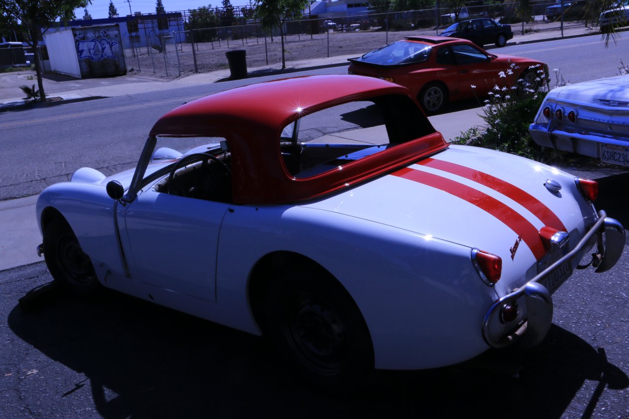

Paint shop broke a lug bolt off on rear drum. Do you think a Napa store would have some? As many cars had these.

Not likely since no modern cars use anything that small. You'll have to order from one of the usual suppliers.

Love the paint job, very nice!
thanks Best part is I got her back home with out catching fire or crashing it. Now I need to start on the 56 year maintenance scheduled. First thing in stall new lug bolts on the rear. Paint shop used a heavy wrench and broke one off. Stop the fuel pump from leaking. Adjust the valve train so all the push rods Line up with the rockers and set gap. The noise rattled my head all the way home. Then install new Bushing front and back. New swivel pins and then a sway bar.
