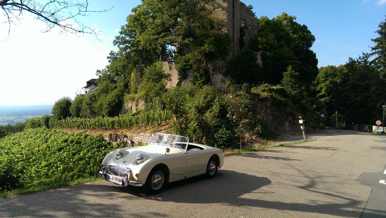

Hey!
Just wanted to give a feedback.... changing the coil solved all my problems.
Thanks a lot for your advice.
Just went of for the first real drive.
