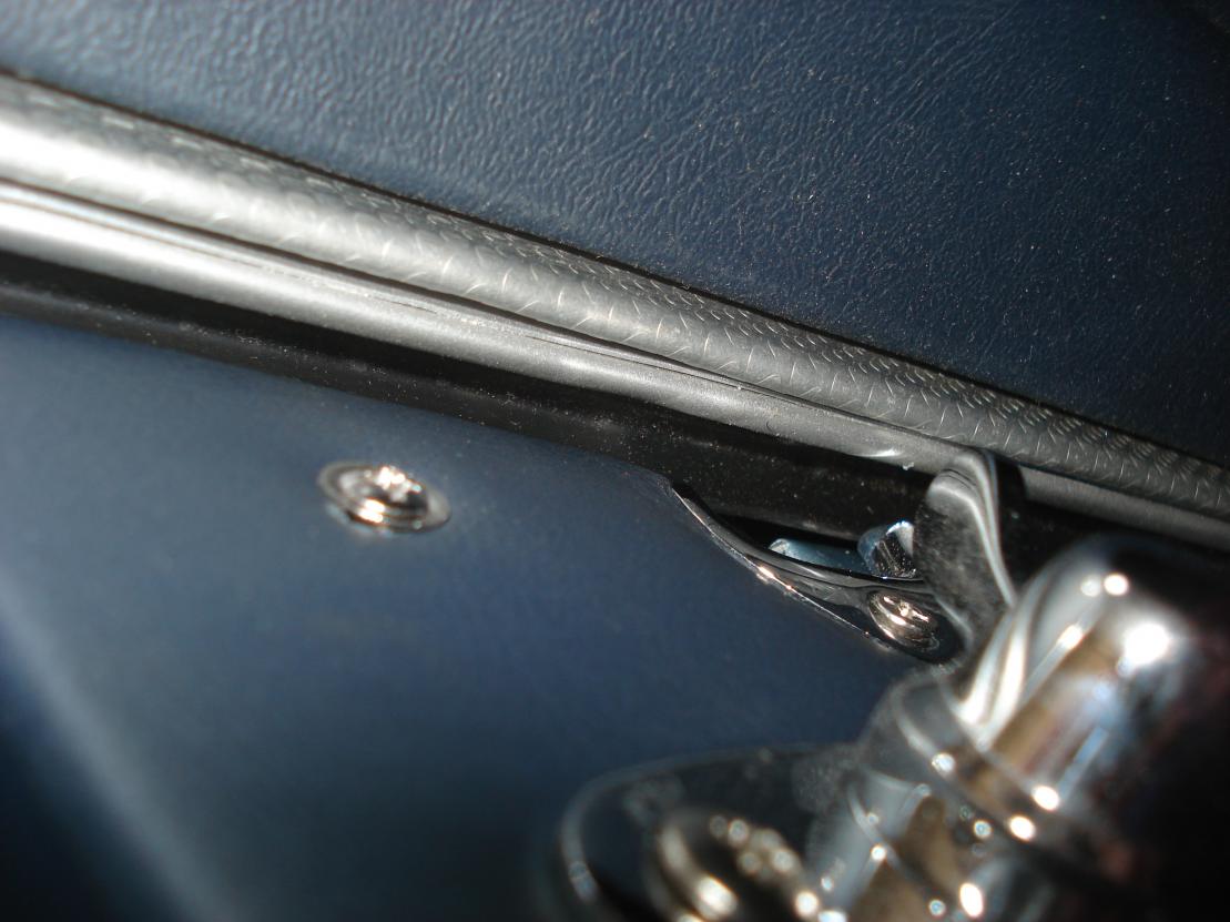

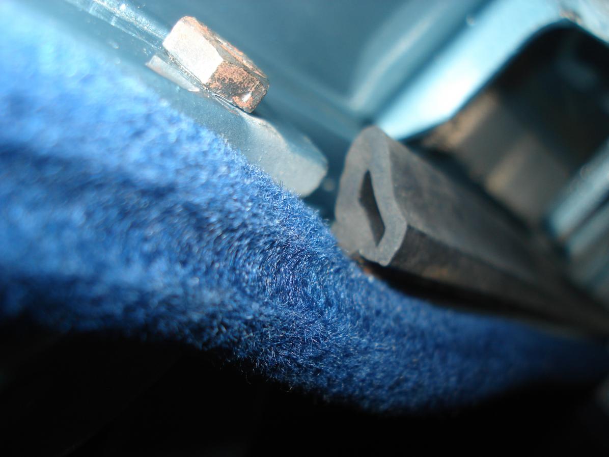

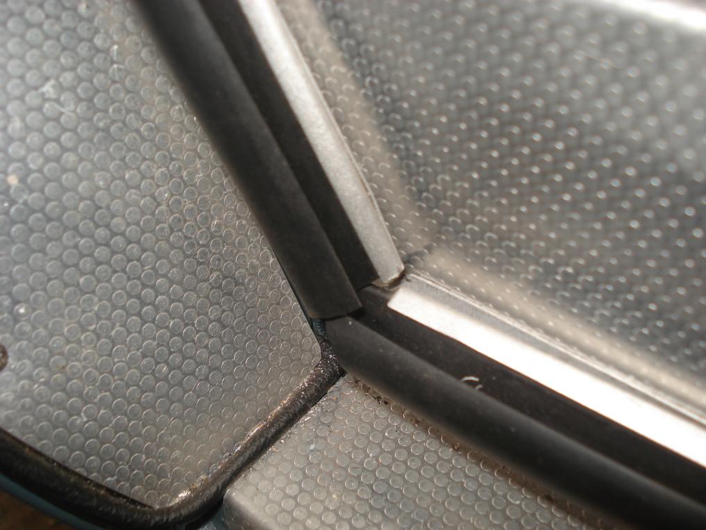

healeyblue
Do your door seals look like mine in these photos. These were taken of the passengers door. I too had a very hard time closing the doors after installing these seals until I realized I had them backwards. Then I thought I was screwed because I had already cut and mitered them to fit, but realized I could exchange them from the drivers door to the passengers door and they would be cut correctly. I hope this is your problem.

Ahh! Well, I must thank you VERY much "Healey Blue" because I see from your photos that I too put all the seals on backwards! I'm glad you thought of swapping seals side to side, VERY clever! Thank you so much. Time for a bit of seal removal. Nuts!
- Paul B.

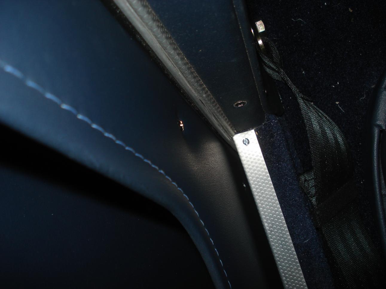

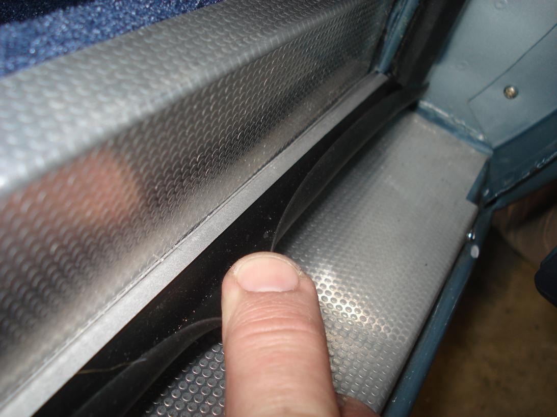

healeyblue
I am not referring to the seal tracks. My problem was the aluminum finishing panels that the seal track screw on top of. The new ones from Moss did not sit all the way flush with the inner rocker which effectively moved the seals outward towards the door almost a 1/4 of an inch. Once the seals were rotated and the aluminum panels were beat flush (remove one screw at a time and use a wood block to hit with a hammer to reshape the panel then put the screw back and repeat on the next screws) then the doors closed smoothly and the seals are properly seated. I am attaching a couple pics showing how little room there is with the door closed so all this needs to be right.
