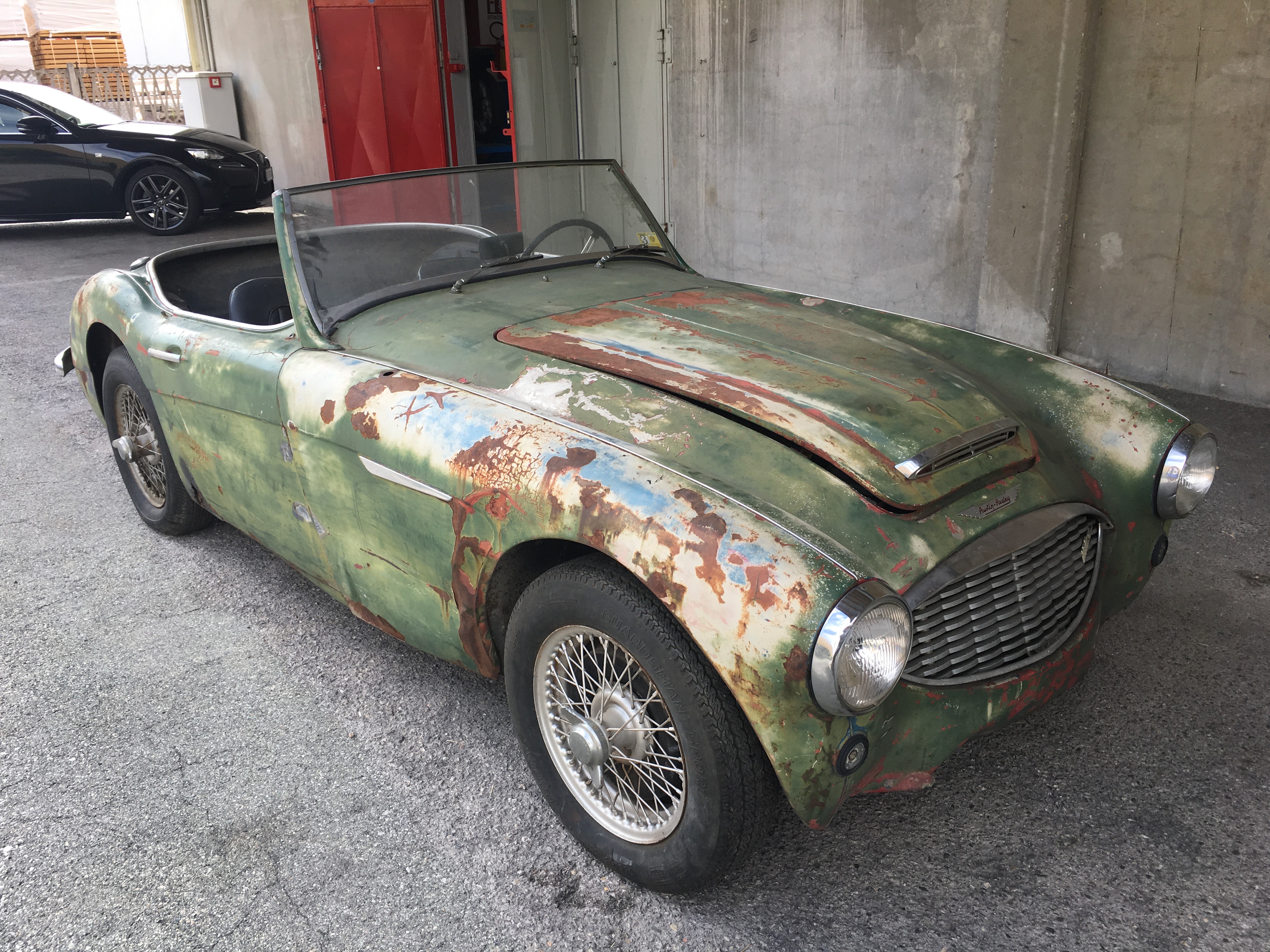

I'm always looking for a lockable handle for the BN4. But now I would like to do a little history of this car.

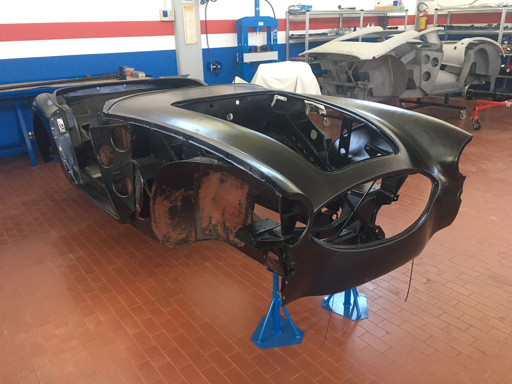

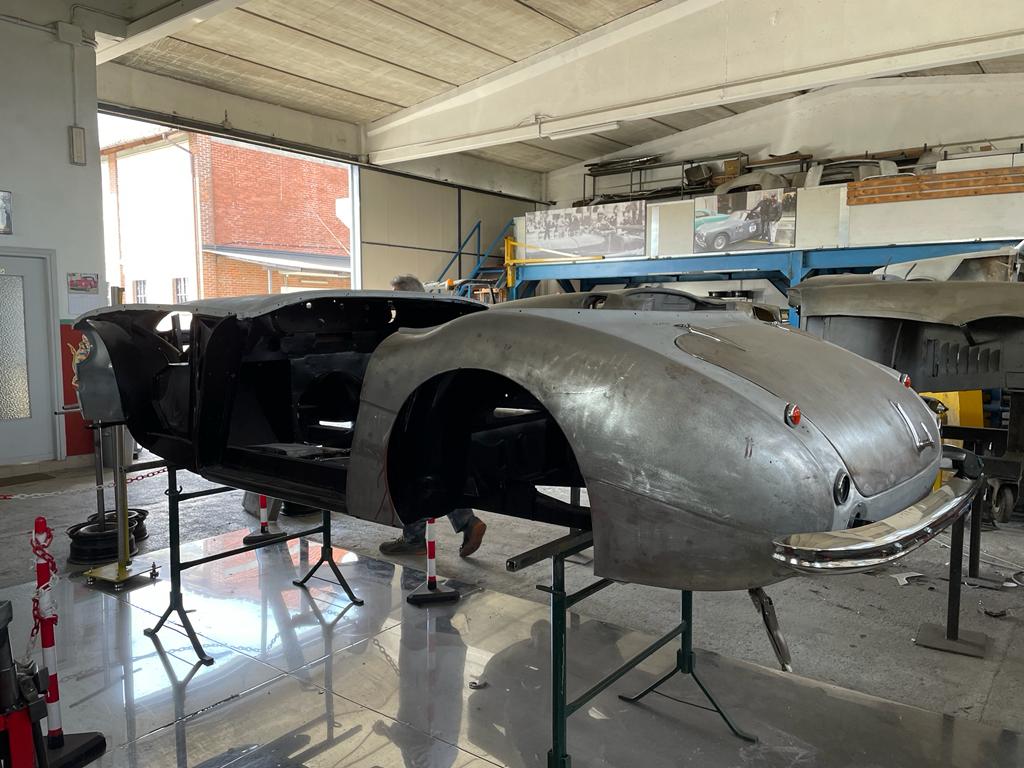

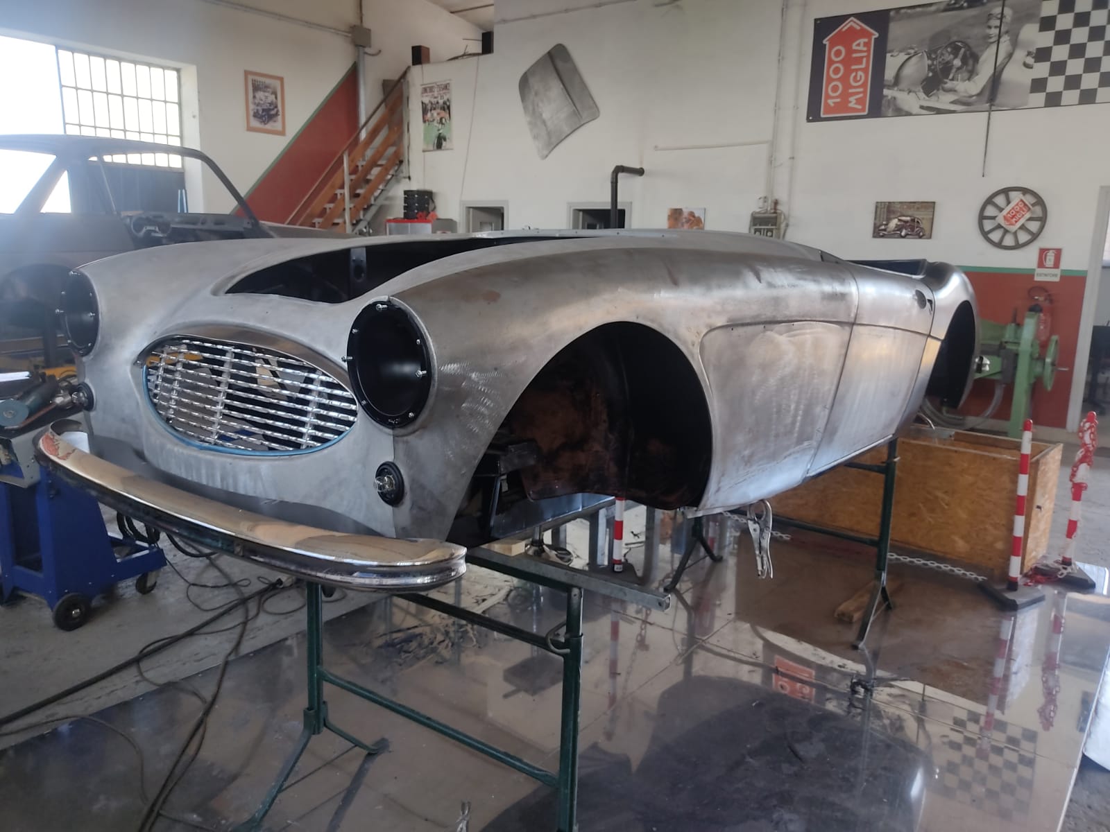

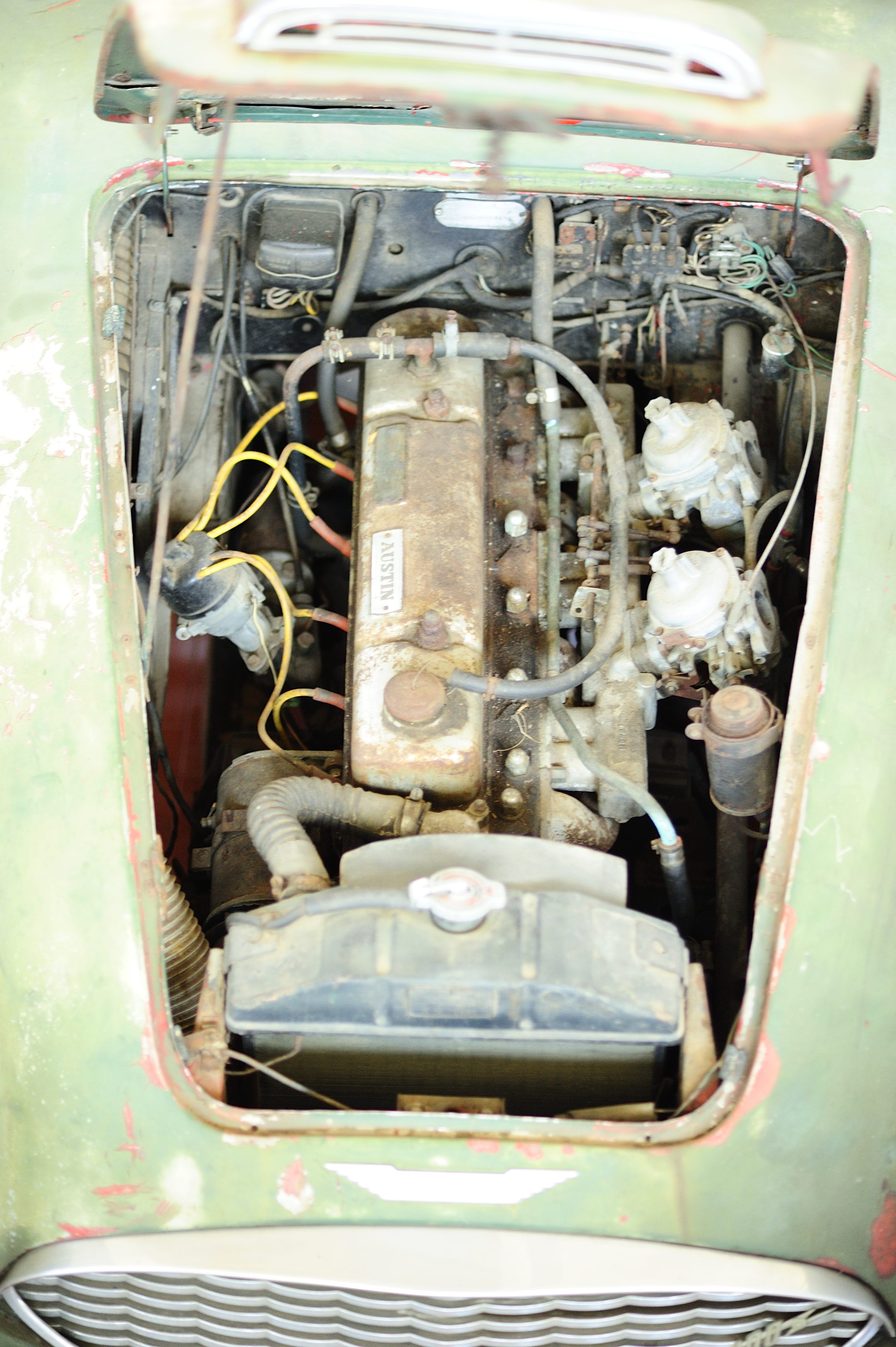

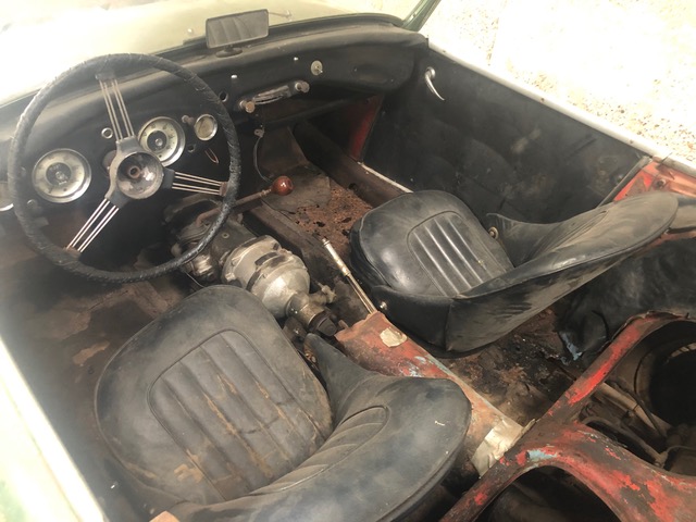

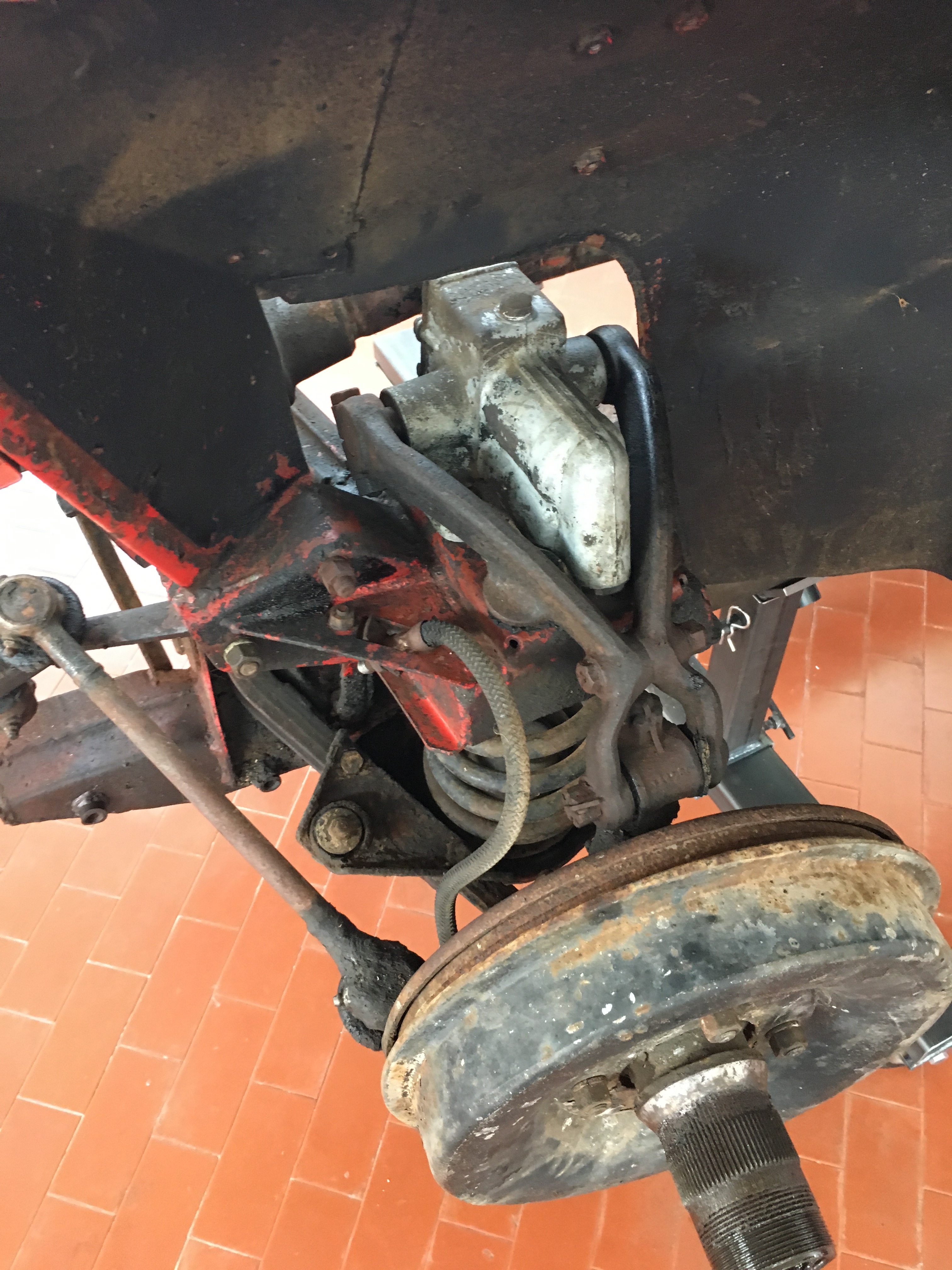

Comes from the USA, production March 1958, chassis no. 59194, matching numbers. It was built in Abingdon in the period of overlap in the two BN4 locations, therefore with the characteristics of those manufactured in Longbridge.
Rather battered, we began a complete restoration.
Here are some initial photos.

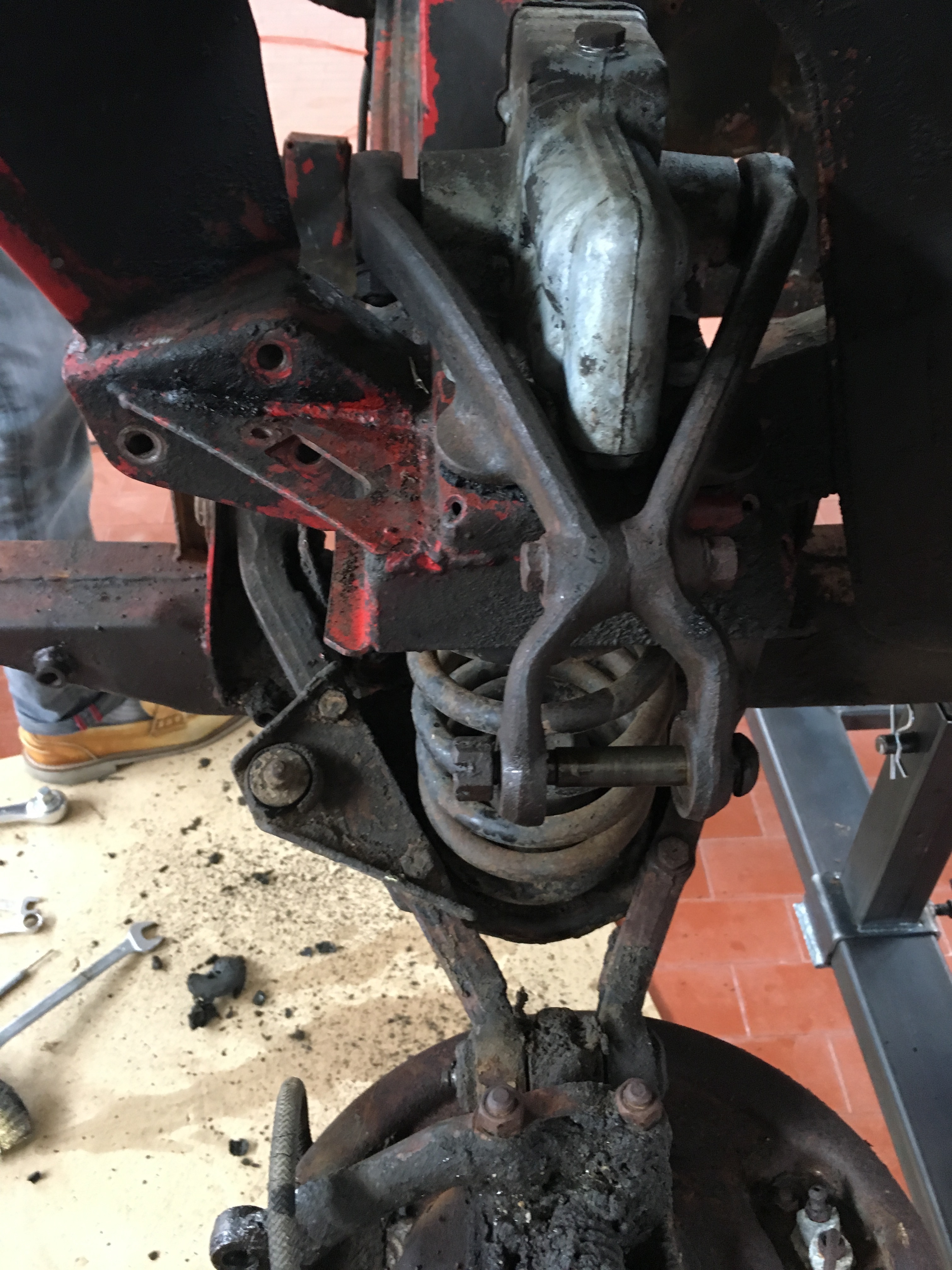

Acton51

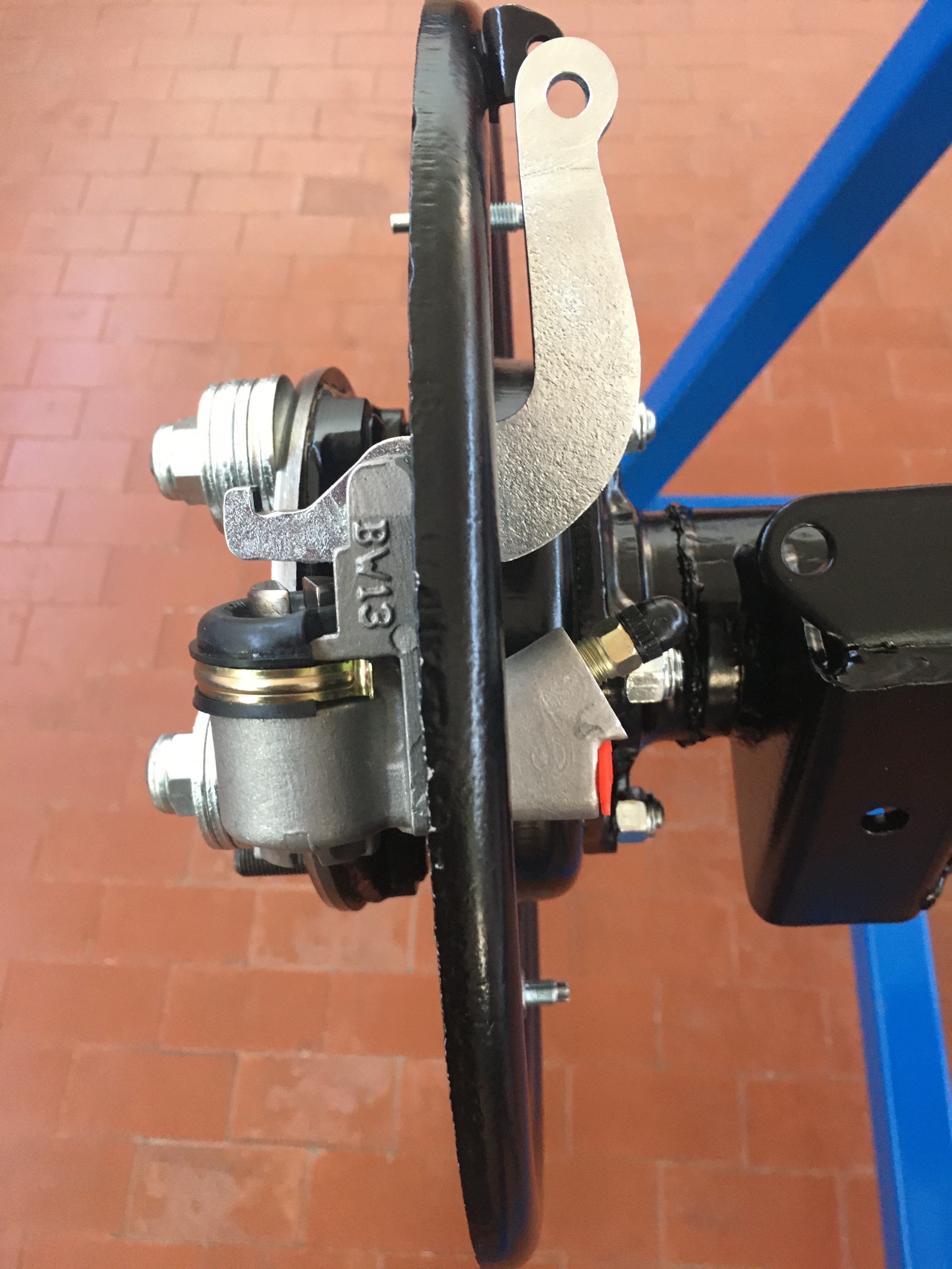

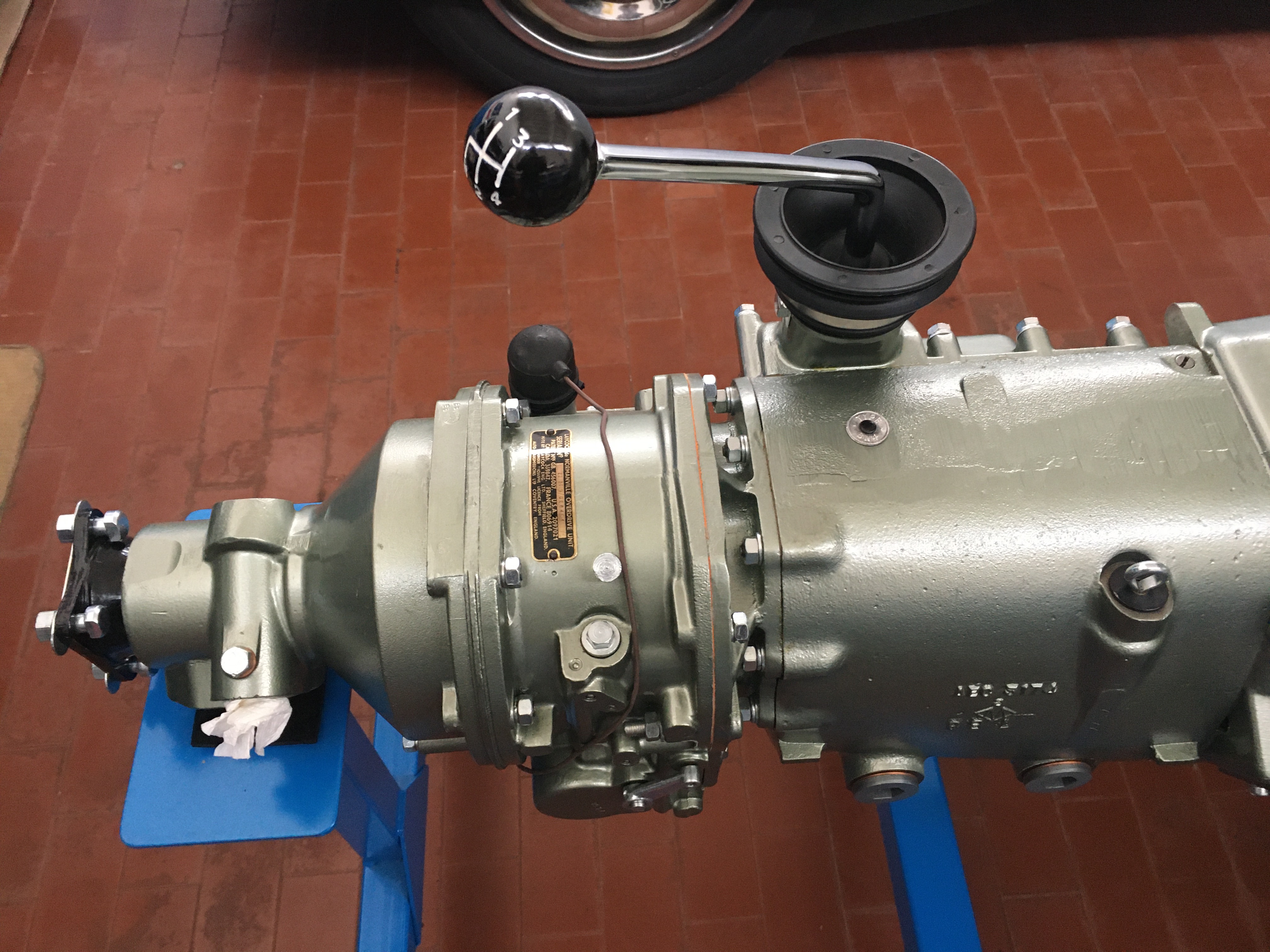

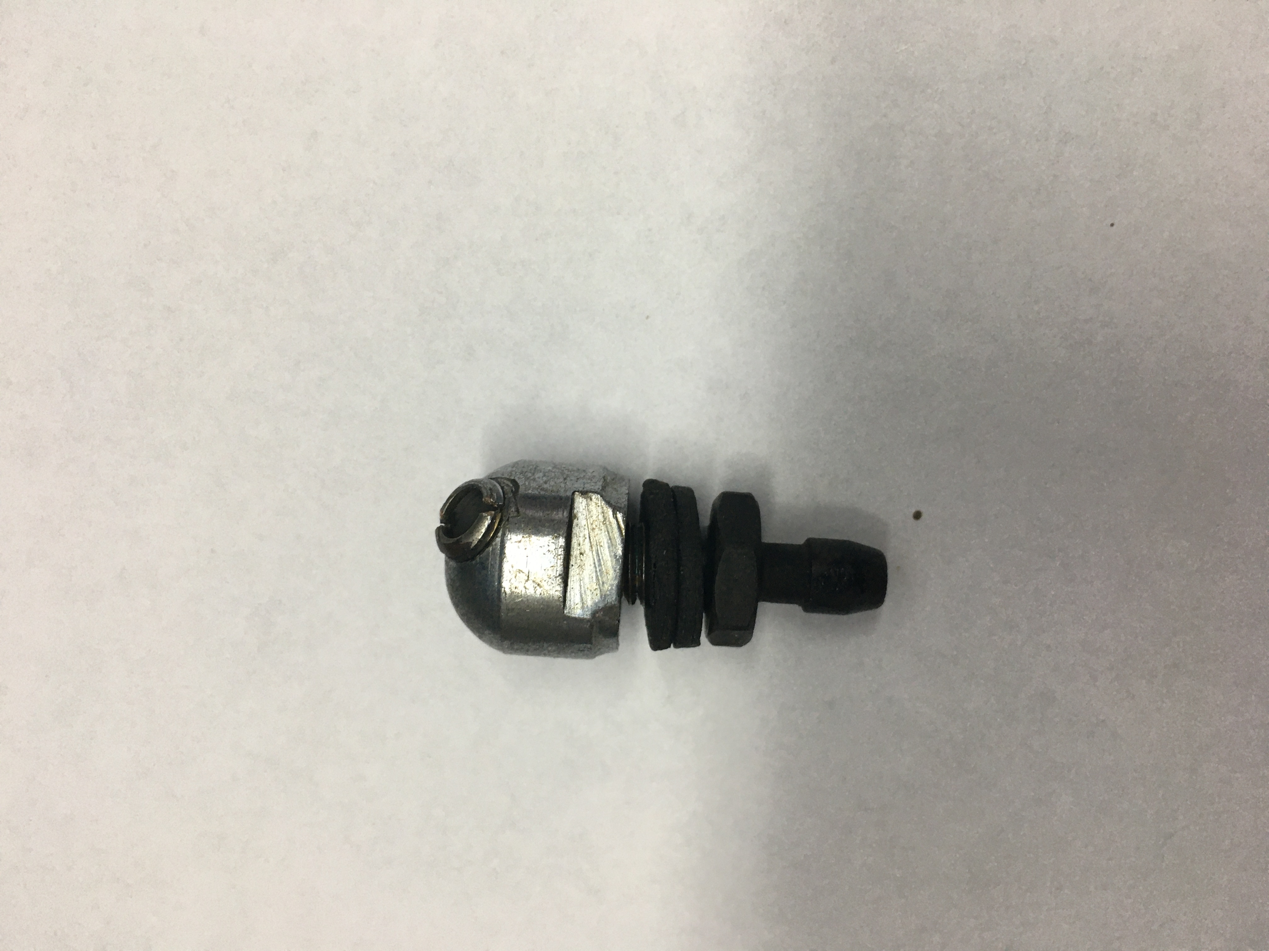

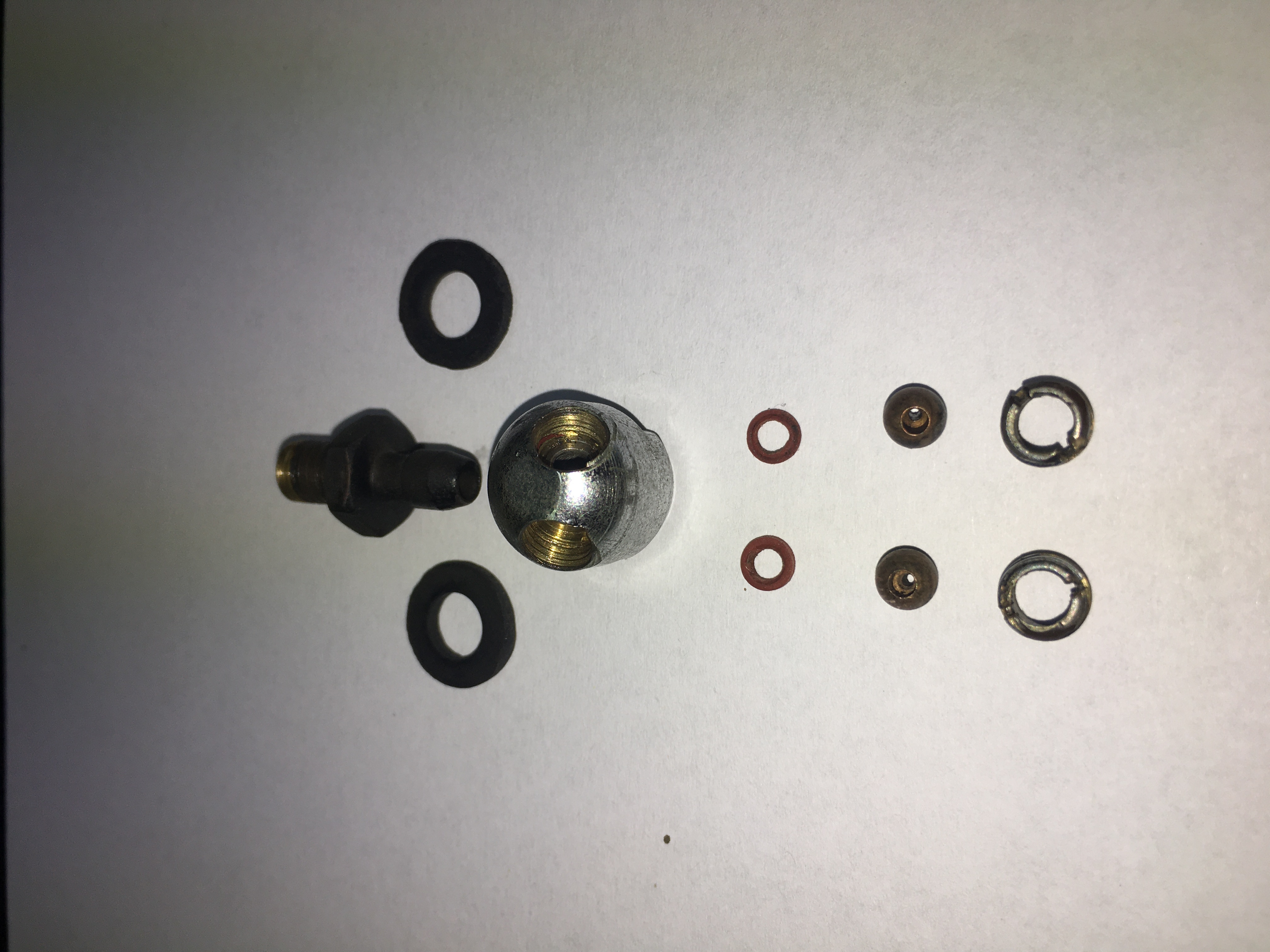

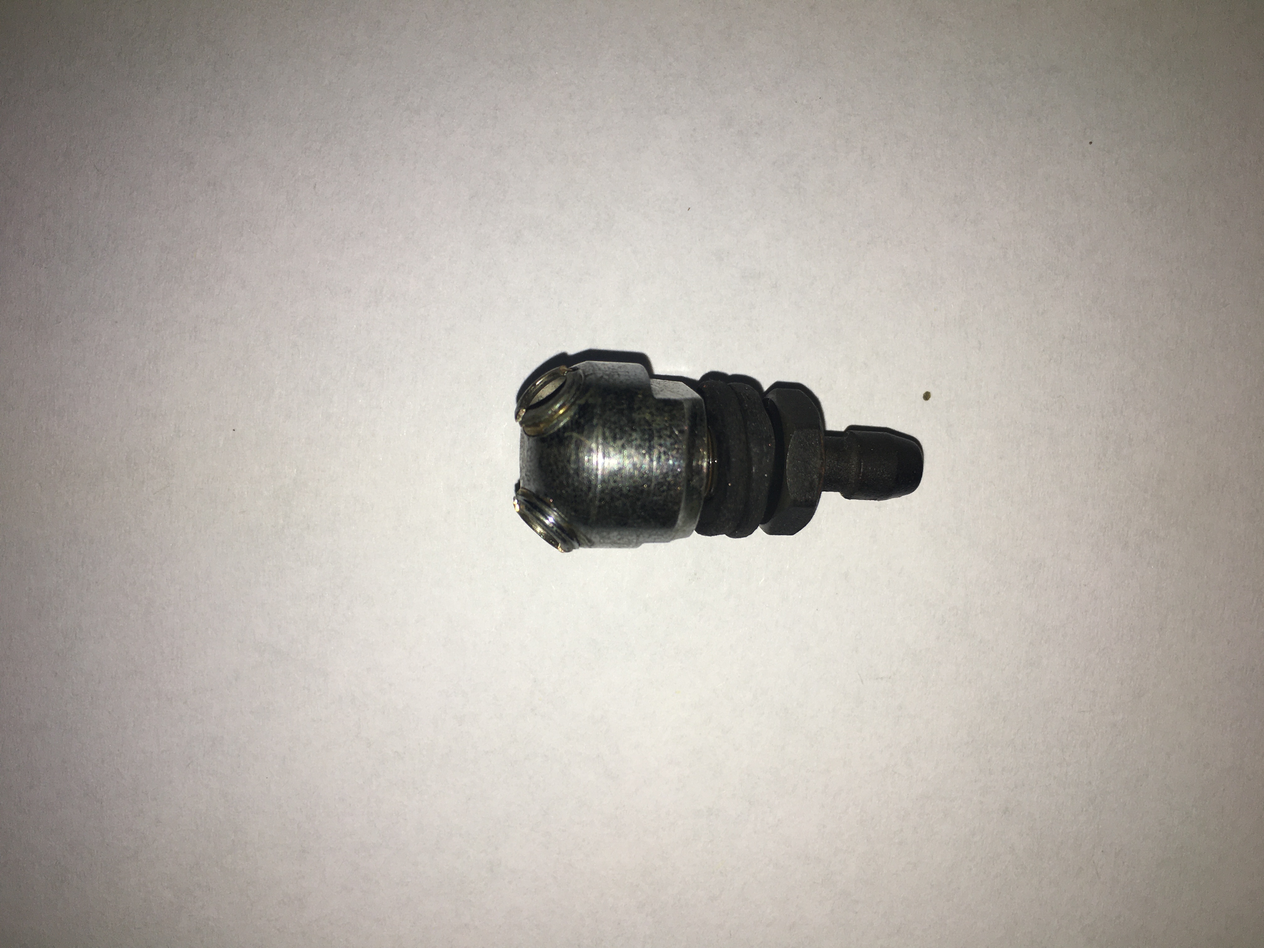

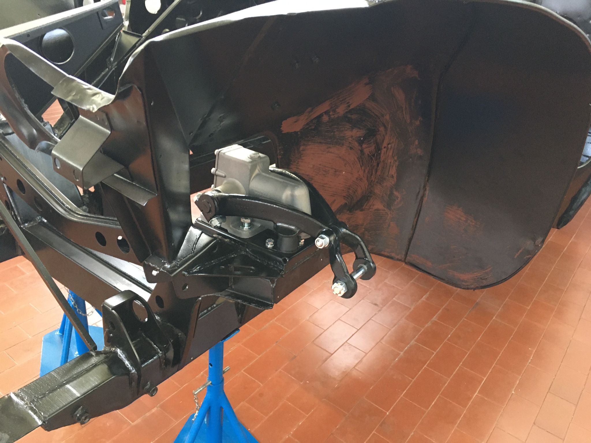

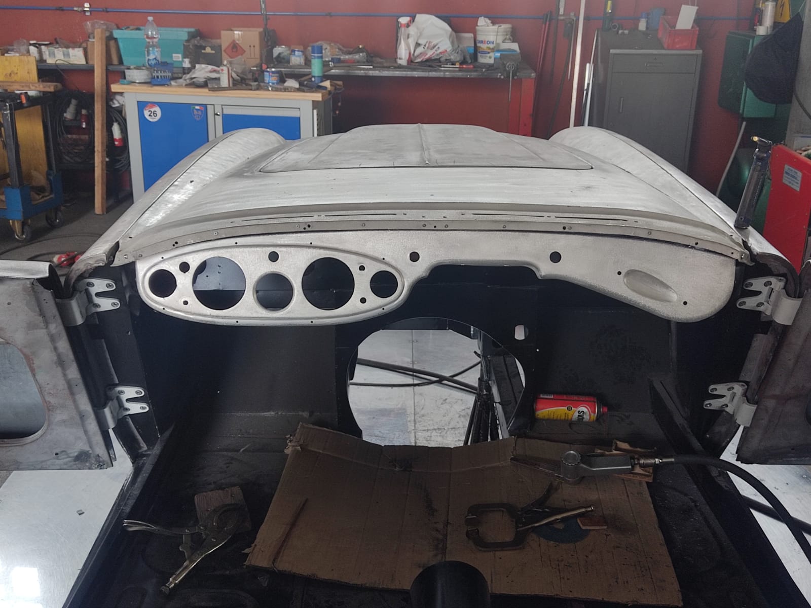

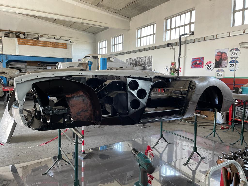

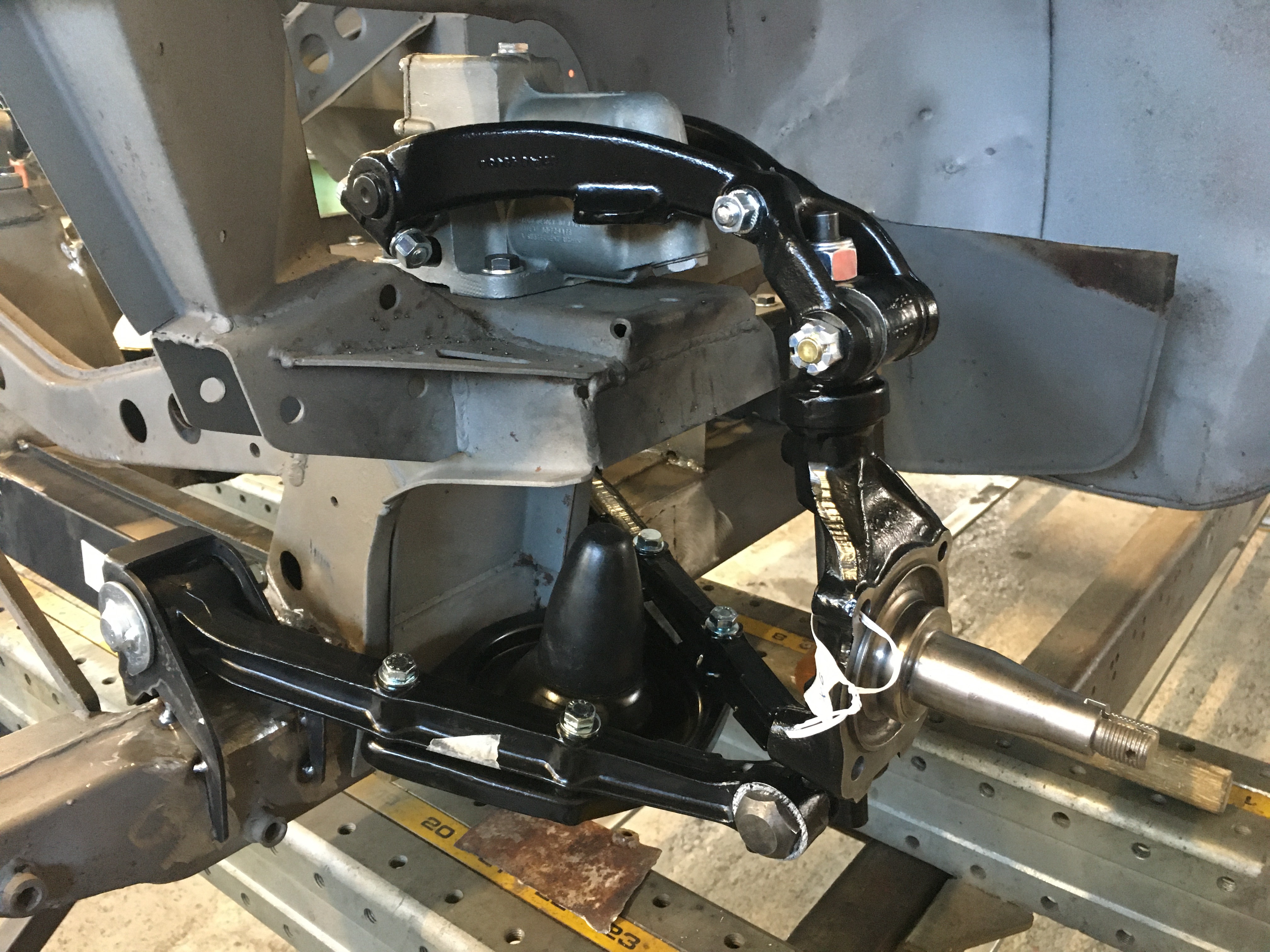

Disassembled, sandblasted, rebuilt in sheet metal and subjected to cataphoresis.
Some details:

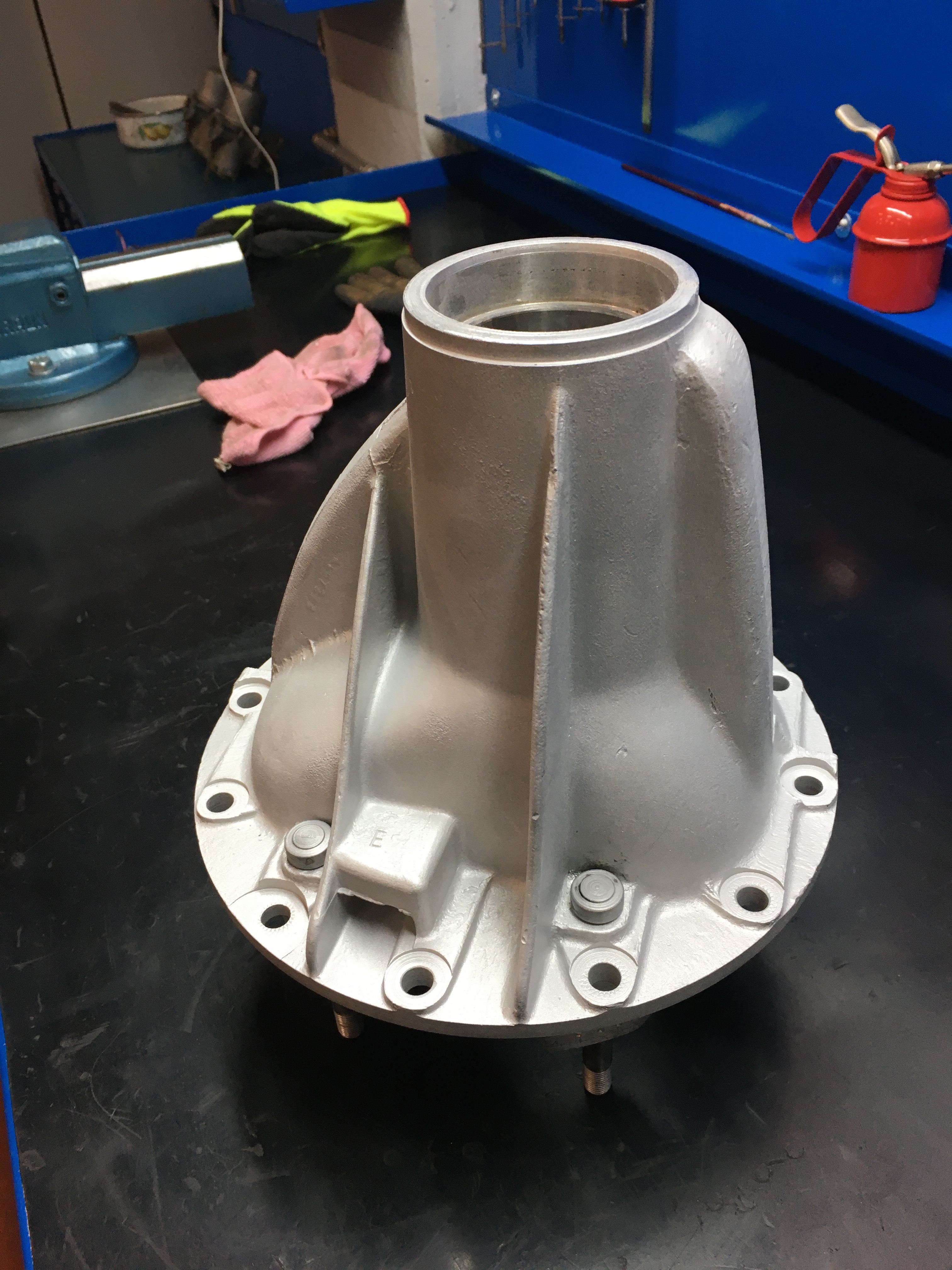

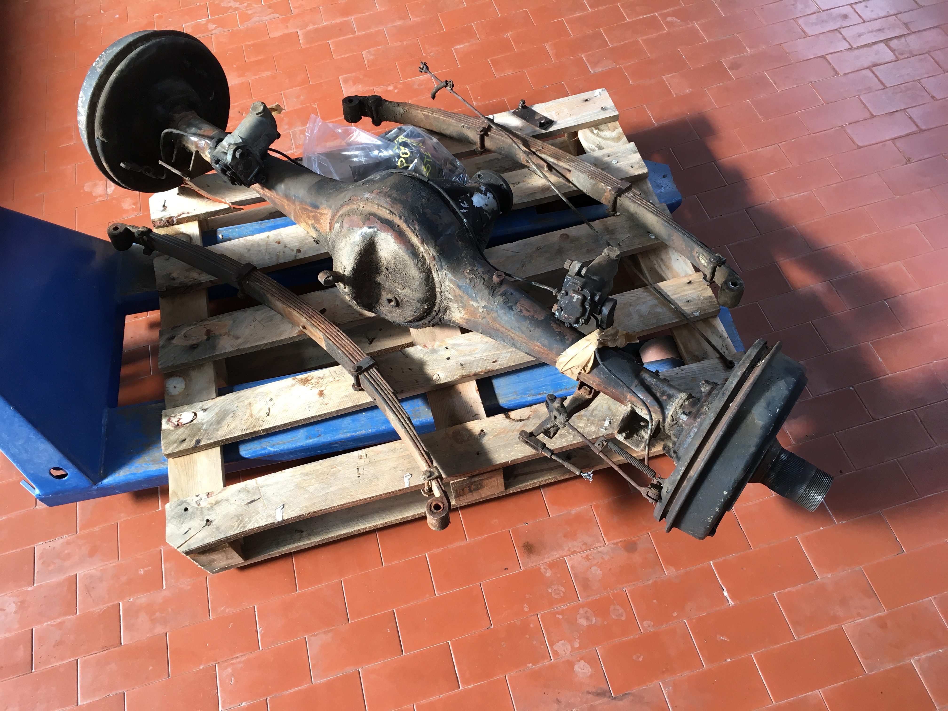

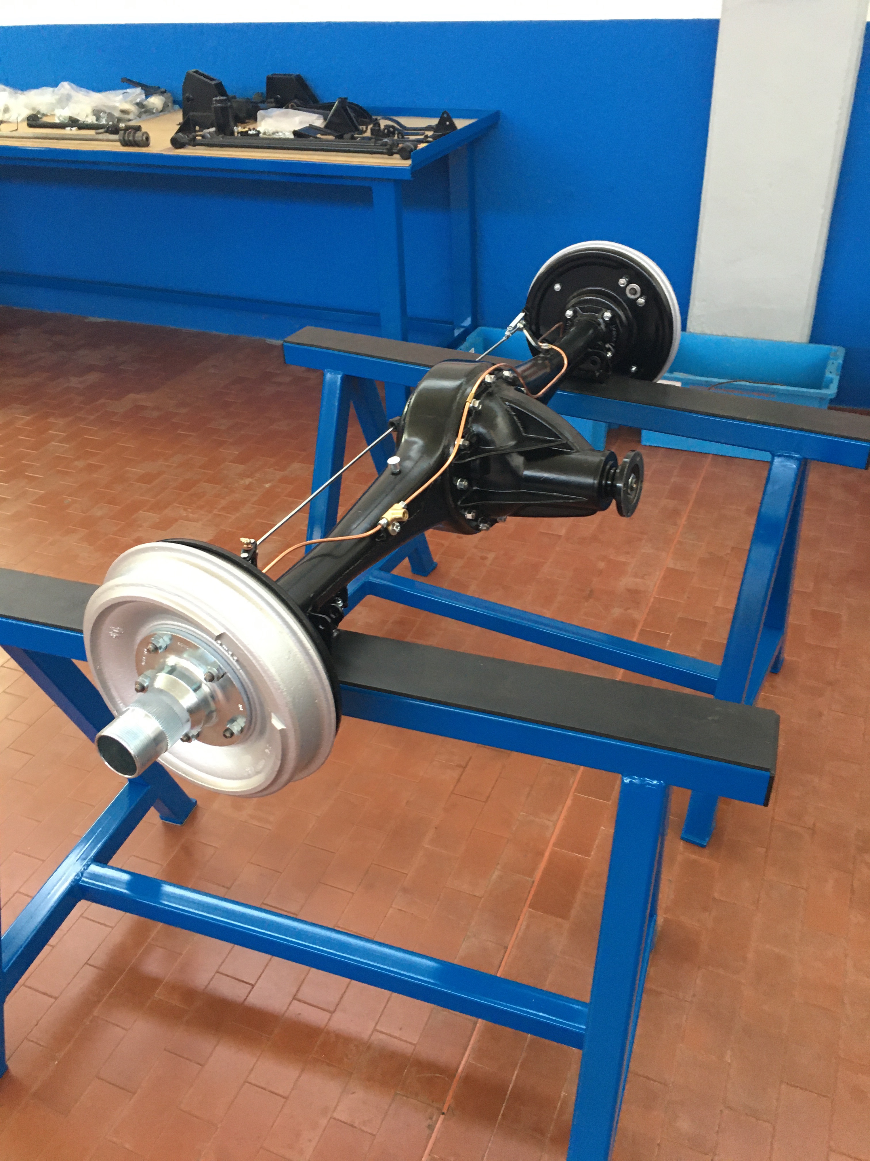

Acton51

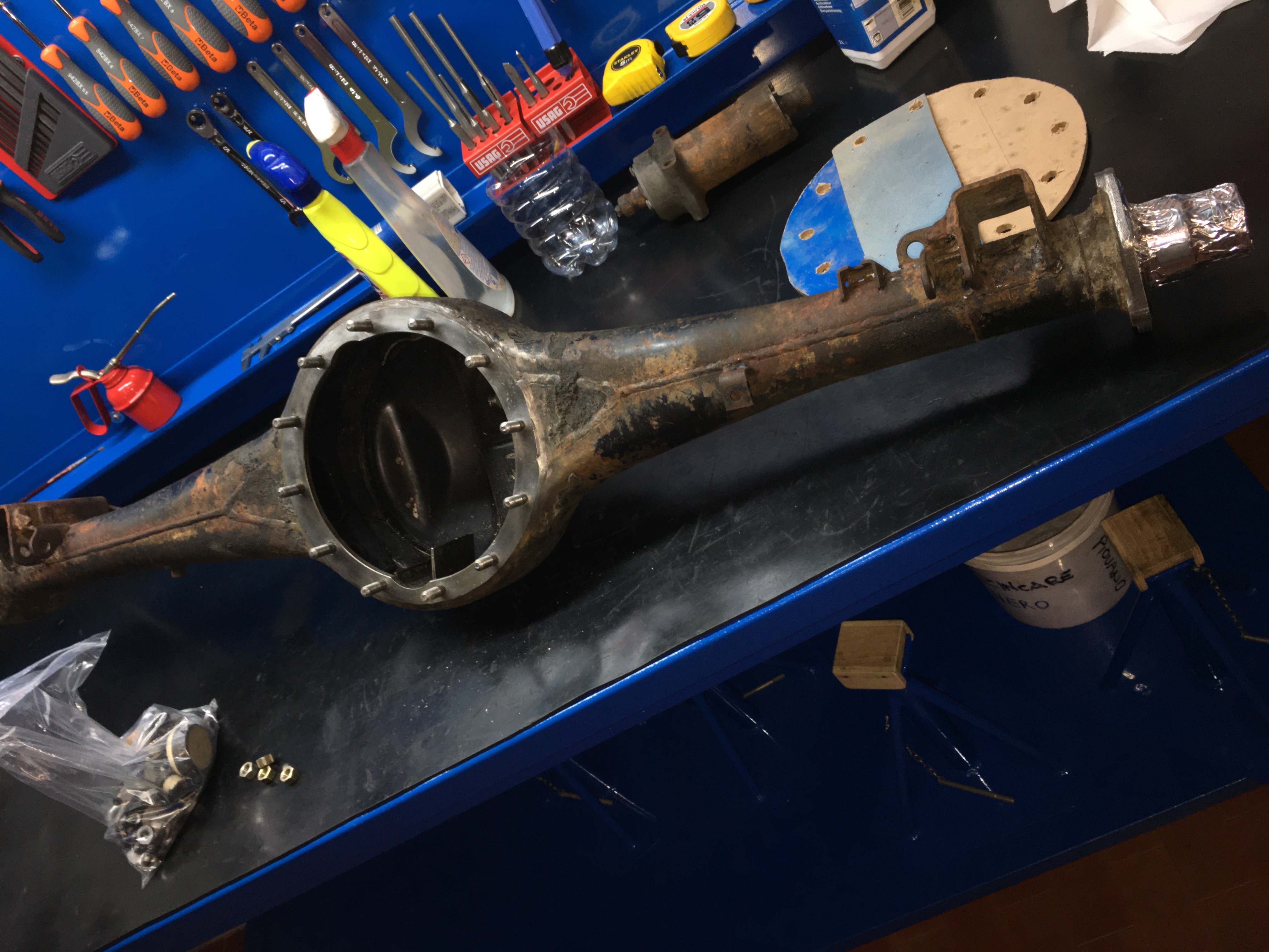

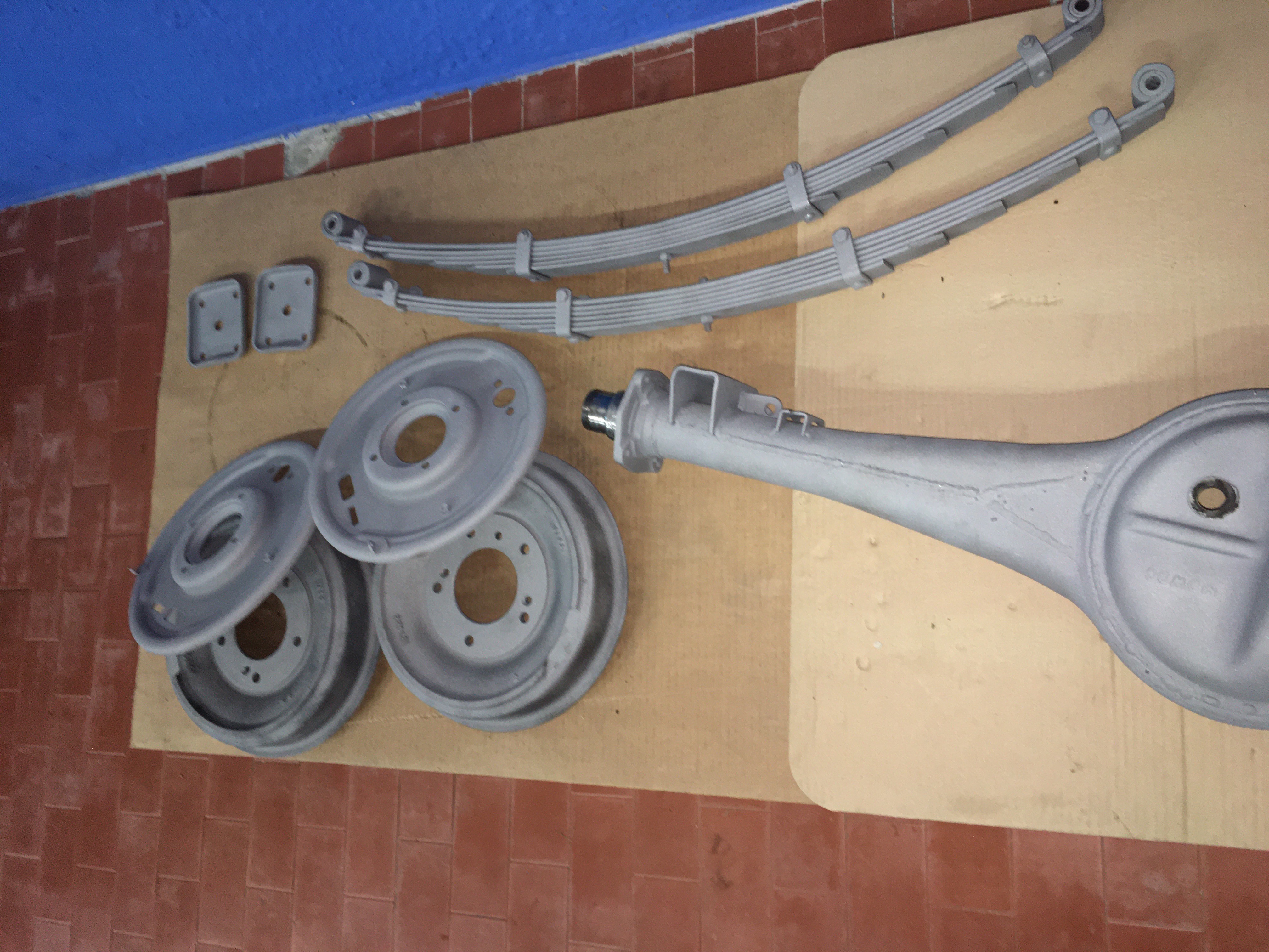

Each component was disassembled, cleaned and evaluated.
About 70% have been recovered.
Rear axle

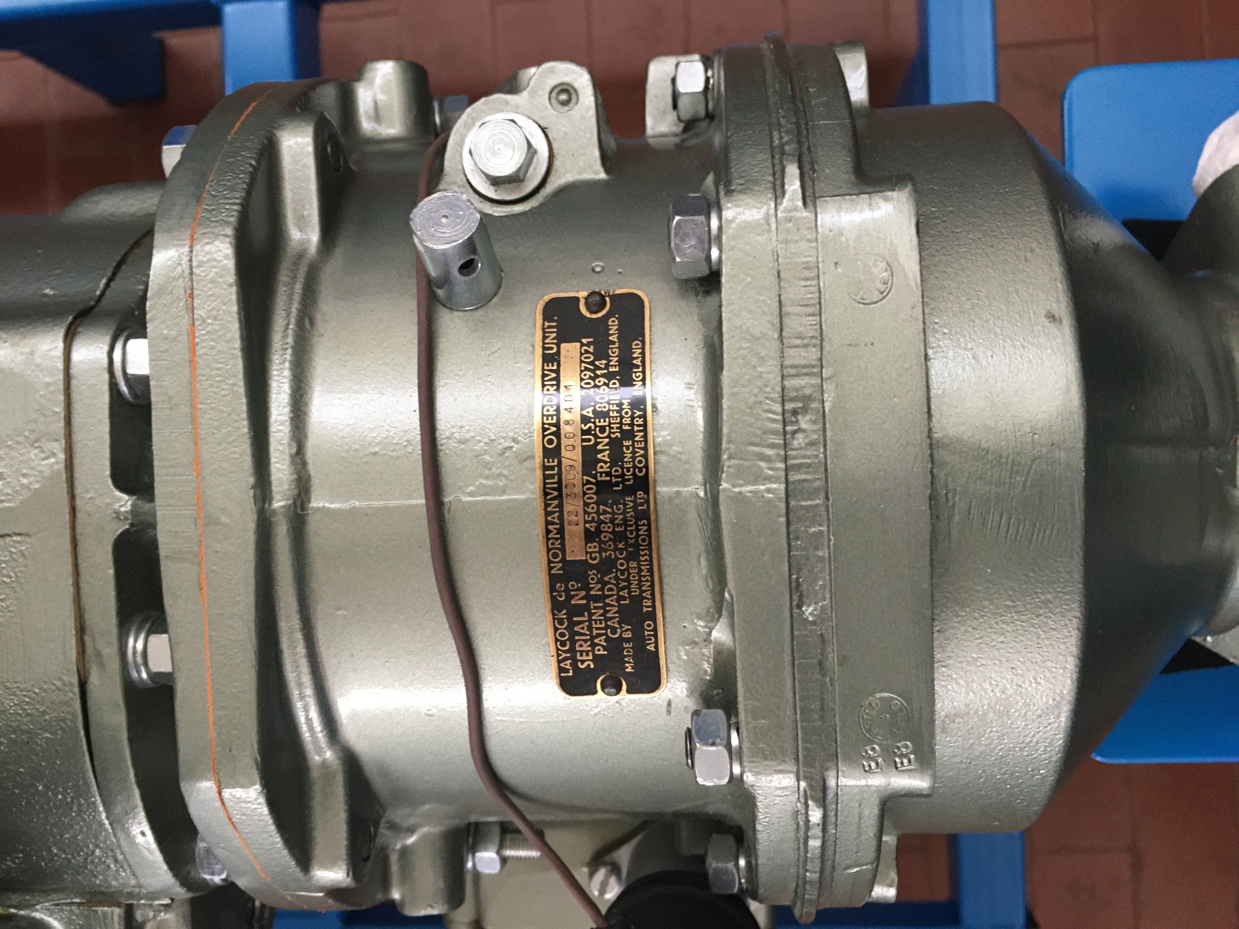

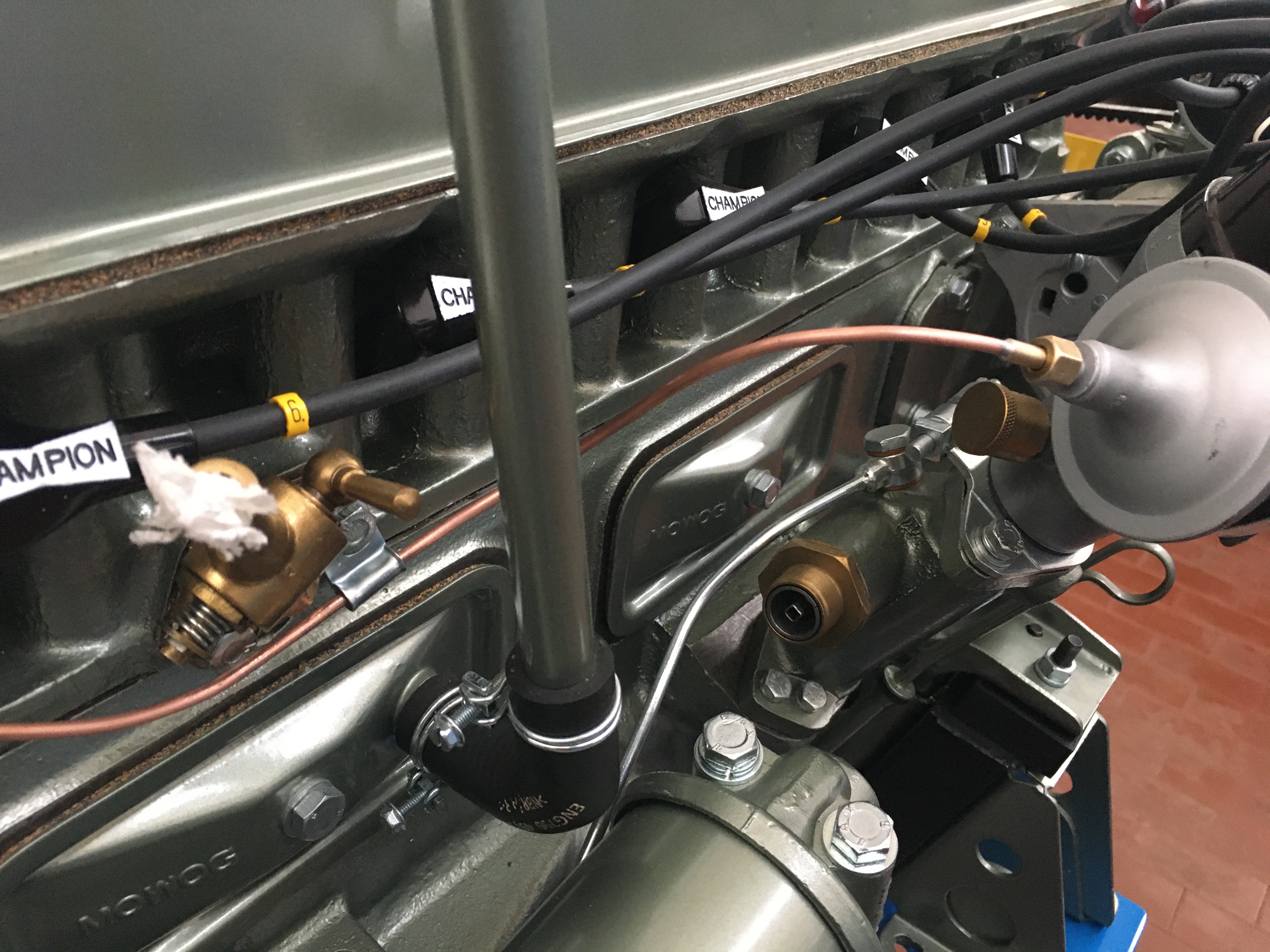

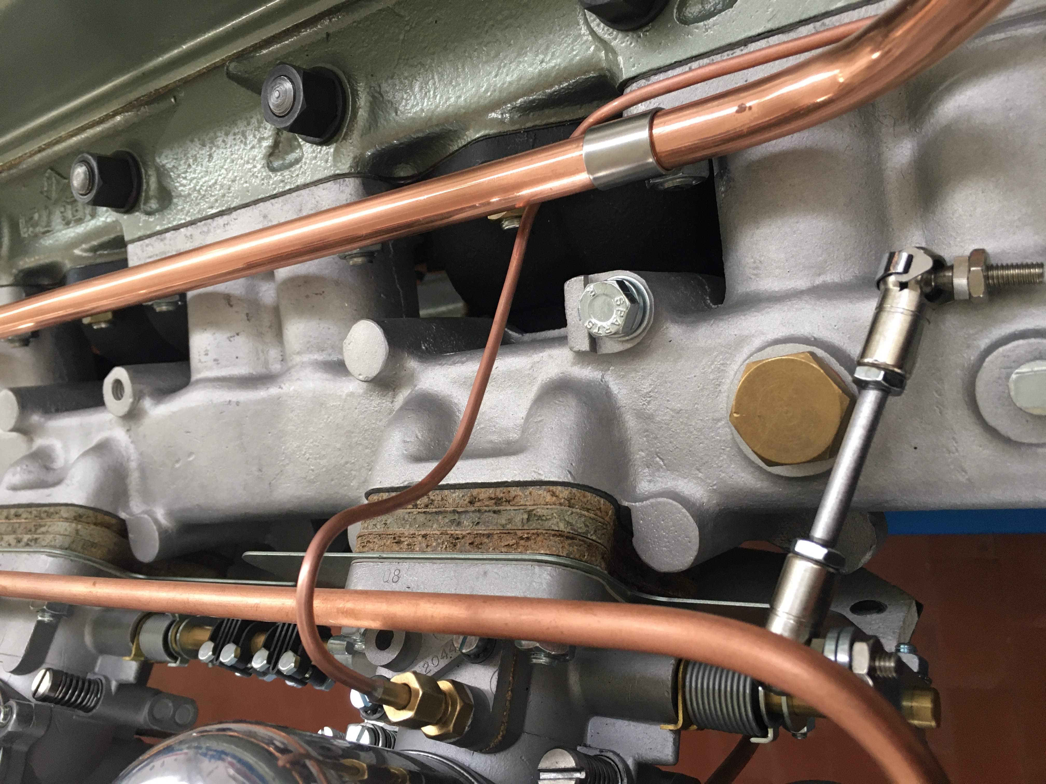

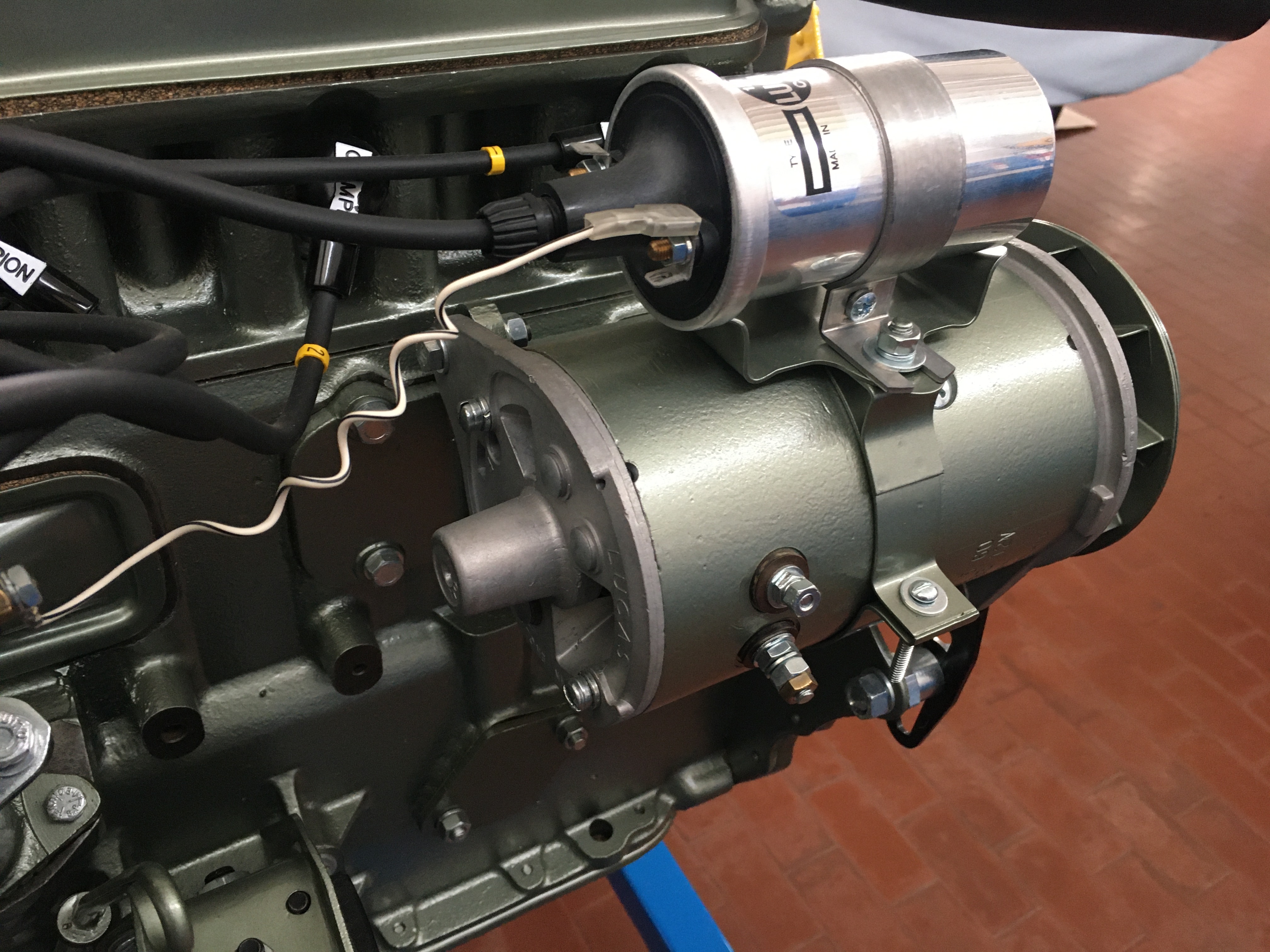

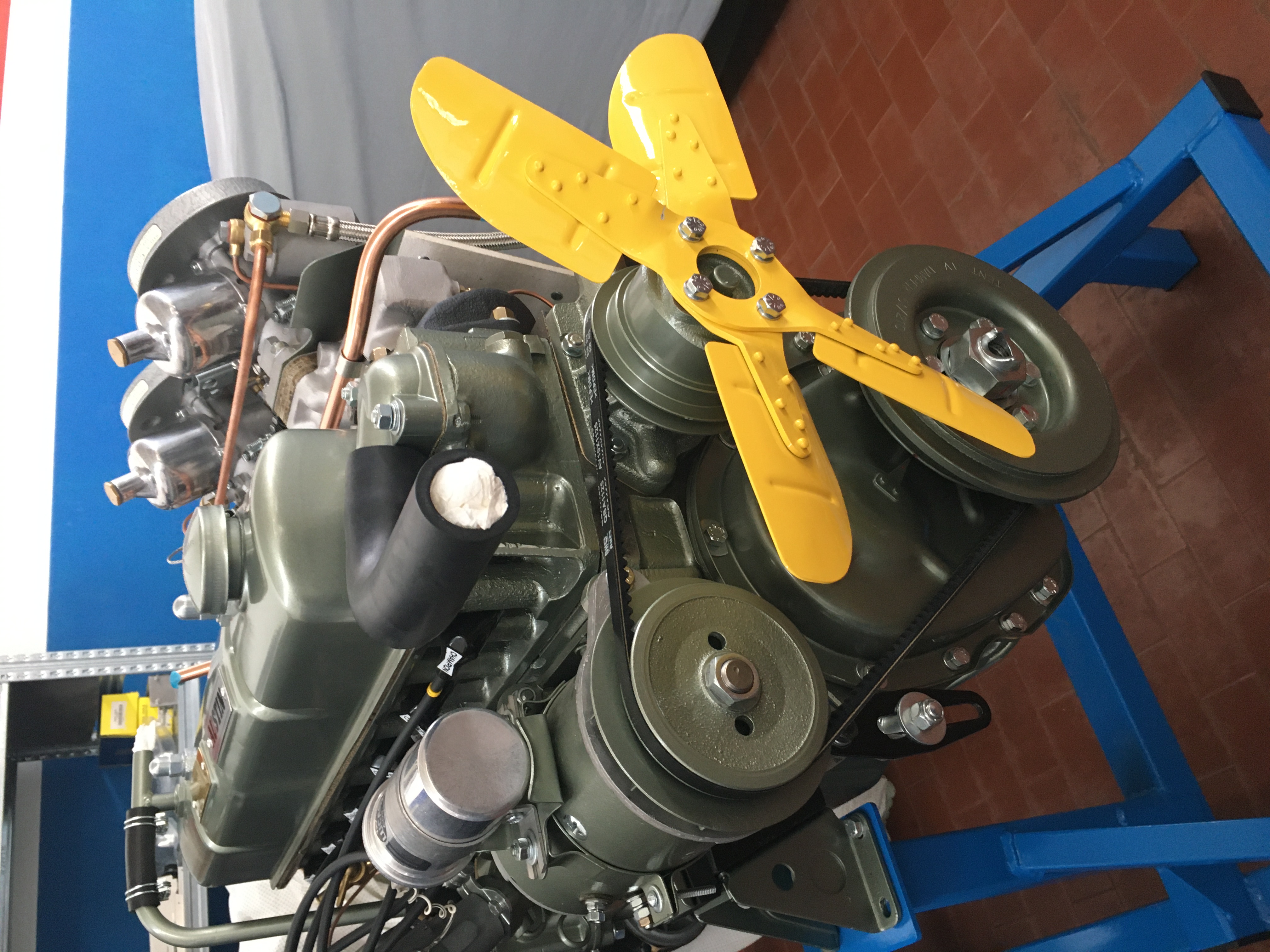

Apologies for the delay, I am inserting some photos relating to the restoration of the engine. I would like to point out that we have recovered more than 70% of the components, the remaining 30% is represented, naturally, by pistons, gaskets, cables and various connections.
