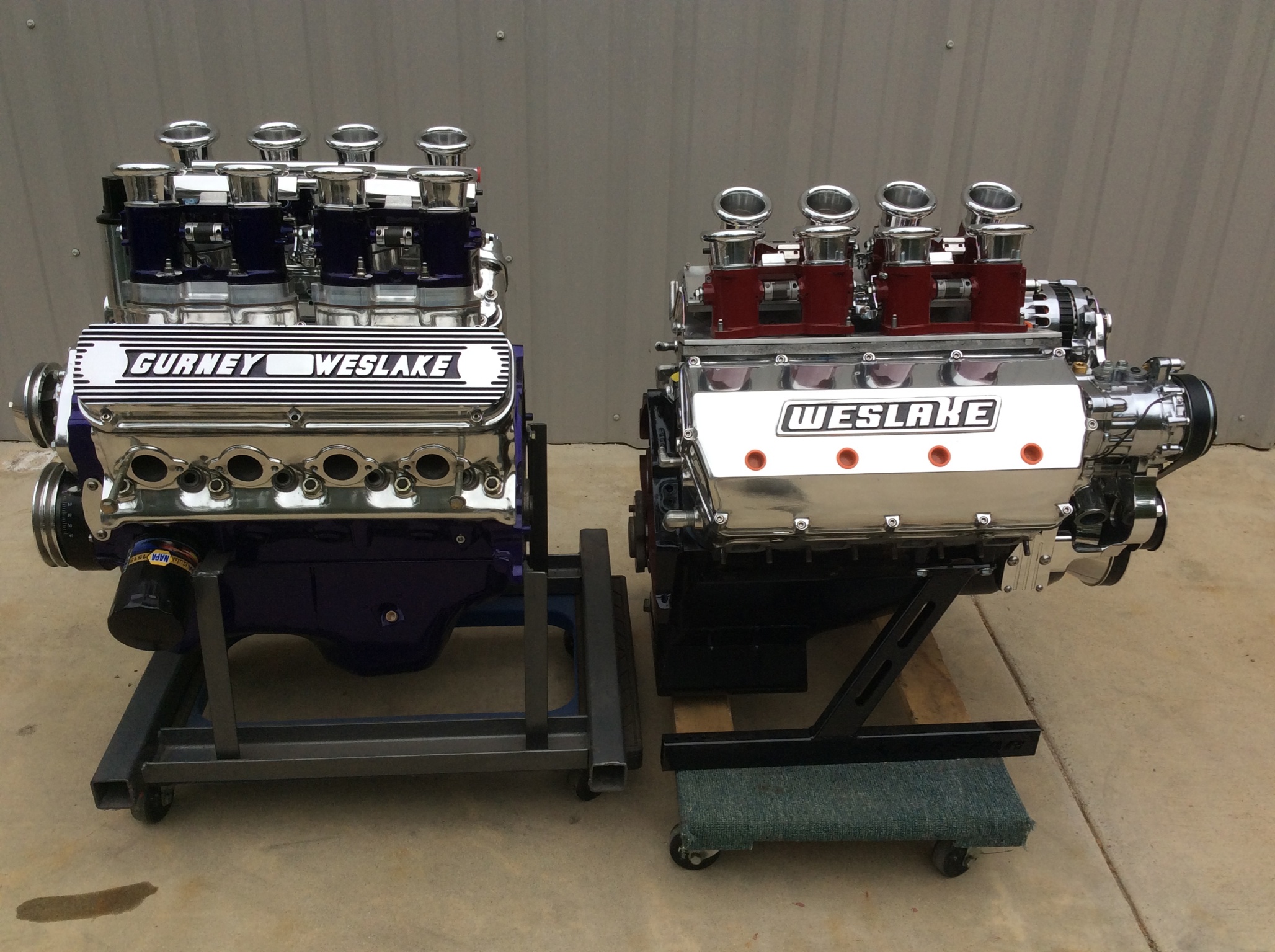

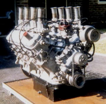

Harry Weslake has long been an automotive hero of mine. Post WW II he was a consulting engineer both for Jaguar on the XK engine and for Austin. He was also involved - very successfully - in the motorcycle world for decades. After working on the A90 engine he famously designed the crossflow cylinder head for the Austin Healey 100S, upping power from 90 hp to 132 hp. The best source of information may be his autobiography ‘Lucky all my life’ - my copy is buried in storage so I am unable to reference it on the Austin and Healey work. I have owned several different Weslake designed engines - big block Weslake Chevy - marked Surtees in the Lola T160 Can Am car, 32 valve Small Block Chevy, Gurney Weslake and de Tomaso all aluminium Sport 5000. He was also a consulting engineer with Chrysler on the hemi engines and many many others….
