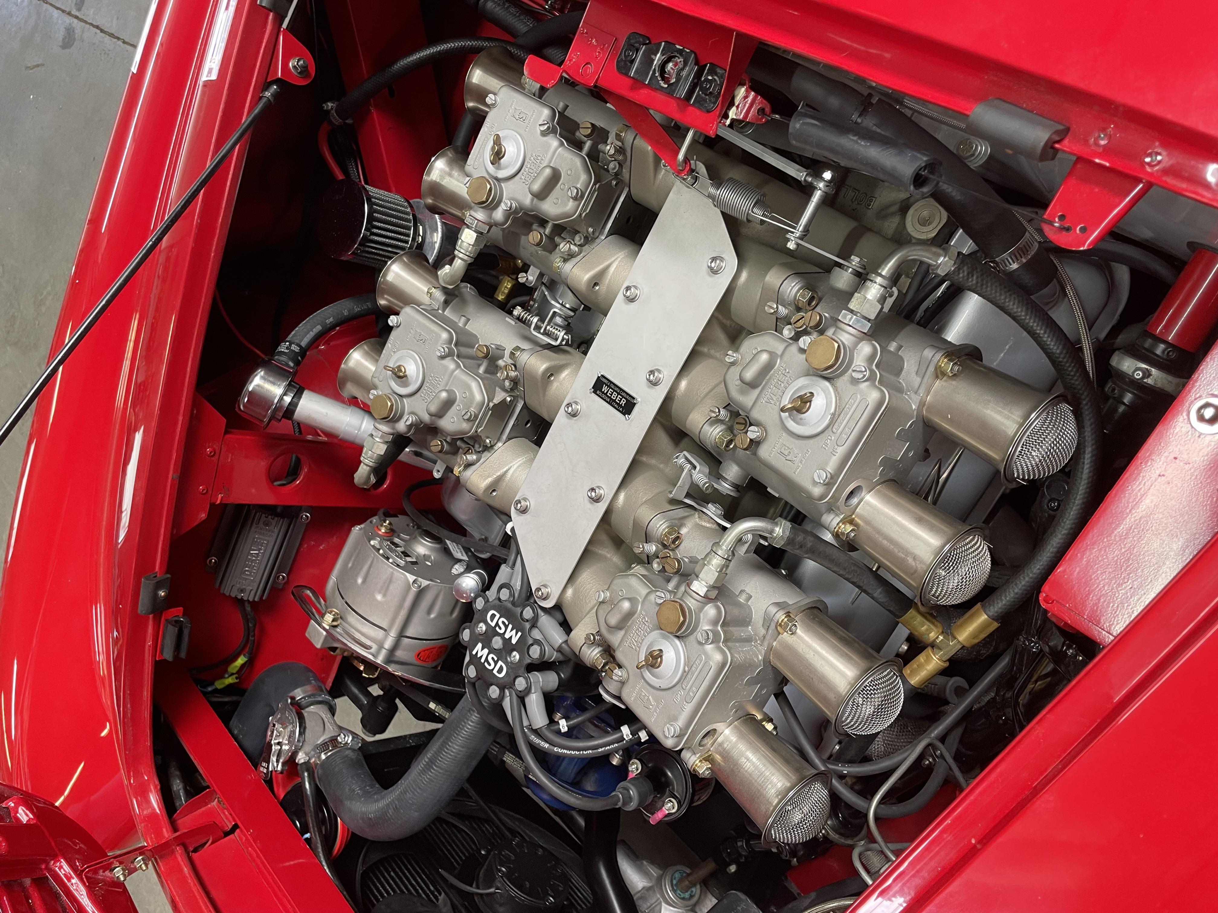

I have acquired a pair of Italian made Weber 48 DCOEs on custom fabricated manifolds which were installed on a BN1 race car with a stock type (non 100S) head and plan on using these on a 100 with a DWR head. Has anyone else used side draft Webers on a 100 4 cyl engine? Any advice on setup and jetting would be much appreciated….

Thanks for your insightful reply Randy - certainly food for thought. 48 DCOEs are very similar to 45s except for the early ones which have straight bodies rather than the stepped bodies of the later 48s and all 45s. I currently run four early 48s on my Ford 289 HiPo powered BN1 nasty boy. I run 38 mm venturi on these. I am thinking of modifying a stock 100 to fast road race specs. On V8s Webers like plenty of lobe separation - I run a solid lifter cam with 114 degrees of separation and no more than 3-4 psi fuel pressure. Alfa Romeo ran 45s on the 1600 GTA (97.5 ci) so I am not overly concerned about the bore size and with variable venturi they can easily be sleeved down to as small as 32 mm.

Lord! My eyes hurt just looking at the photos! My head hurts considering the complexity!! And my heart warms as it is admiring the work that has gone into setting these up.
