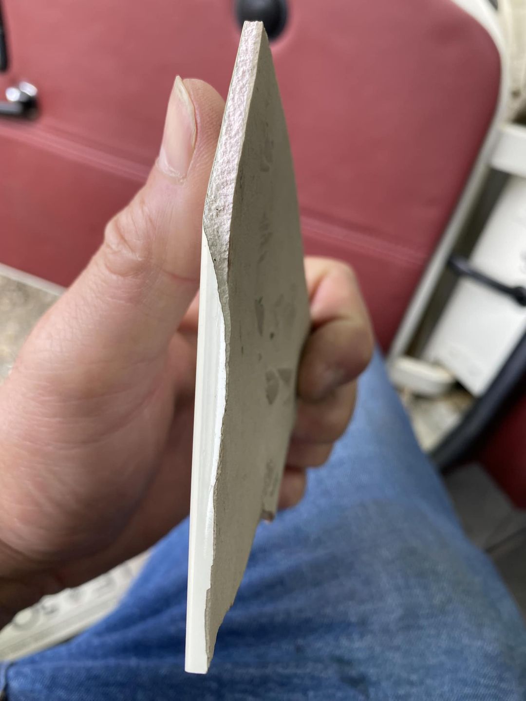

By all means do a personal inspection when looking at a Healey and bring a knowledgeable Healey person with you. There are just too many ways to cover up bad things on the online auctions to preclude having a look-see first. Having said that, though, watch the Bring a Trailer.com auctions for the comment section. They will often point out known trouble spots that you can use in deciding any car you look at. Also, just because a car is sold in SoCal doesn't mean it's always been there, but finding a dry Cali car is ideal. Mechanical problems are a regularly easy fix, but body, rust, and paint work is really expensive.
HealeyRick
And just because a car has a body and paint "restoration" doesn't mean it's a good one. As Johnny Rivers famously sang in "Secret Agent MaN" "Beware of pretty faces that you find A pretty face can hide an evil mind". This is a picture of a very high-end MGB in the UK that was brought into another shop. Note the thickness of the body filler. It's pretty normal to have a skim coat of filler on a car to smooth everything out, but when you get depth like this you're looking at cracking in your future. Not a bad idea to have a filler/paint depth meter when inspecting a car.
