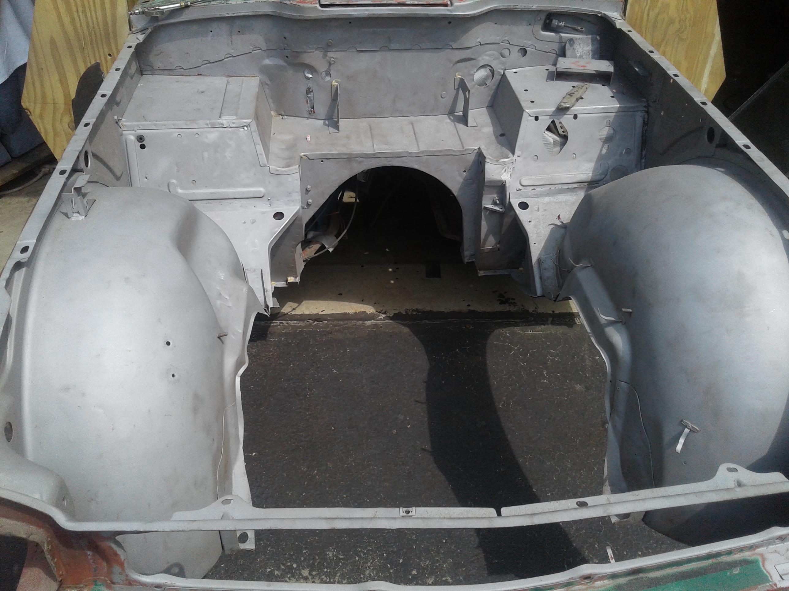

Been restoring my 69 for a few years now and going to have a few questions along the way as I'm trying to do it correct. I've been stripping the body the last couple of days and there were at least 3 colors the car has been. Factory color was Signal Red which I'm bringing it back to. For what I know for sure the windshield frame is suppose to be the body color and the rear panel is also body color. Now I've been told that sometime in the 69 model year the rear was painted a satin black. Now stripping mine does show the rear was black on top of the red. The rear inner trunk panel is black too. The top color is a burgundy and no back out.
Now on the front of the car and behind the grill is suppose to be black or body color and what about the back side in the engine compartment? My engine compartment was blacked out with some black gooey stuff on top so I couldn't tell for sure. To get the goo off I've got to go directly to metal.
Some 69s also had fender beading between the deck and rear fender. I don't think I'm going to add it if it's suppose to have it. I'm tired of the fender beading. It's on my TR3 and the 250 and can be a pain. Don't know when all these changes were made so if there is someone out that can help I would appreciate it. My commission number is CC29843 L built on 1-1-69.

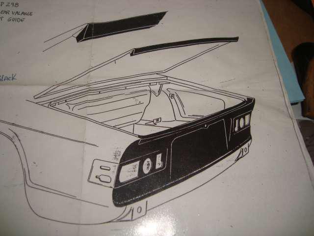

The rear panel just below the trunk lid should be painted that satin.

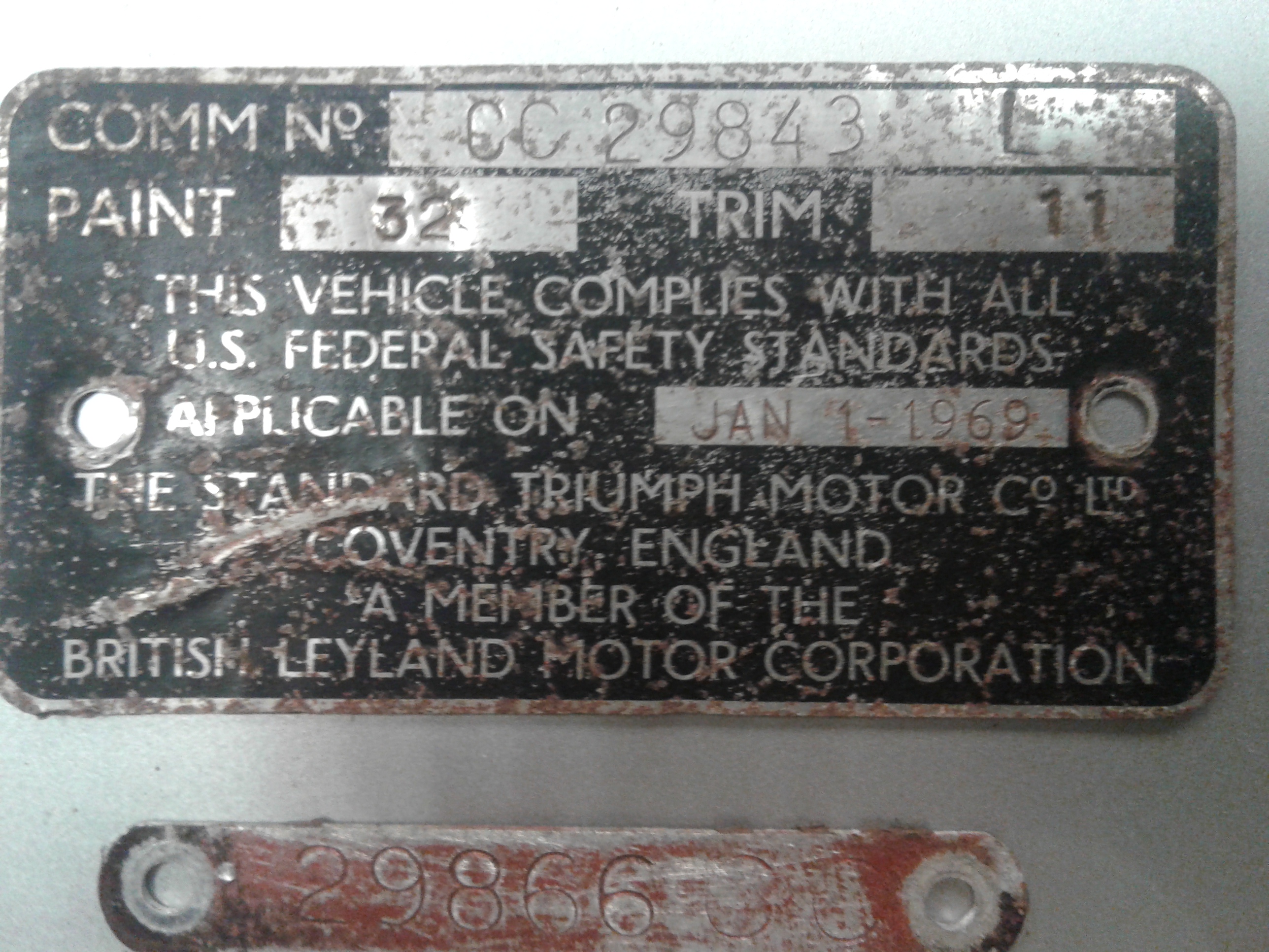

My last point of interest is that while your vin # is consistent with a 69, it wasn't built on 1/1/1969. Probably.more toward the middle of the year.
Here is a copy of build # by year.

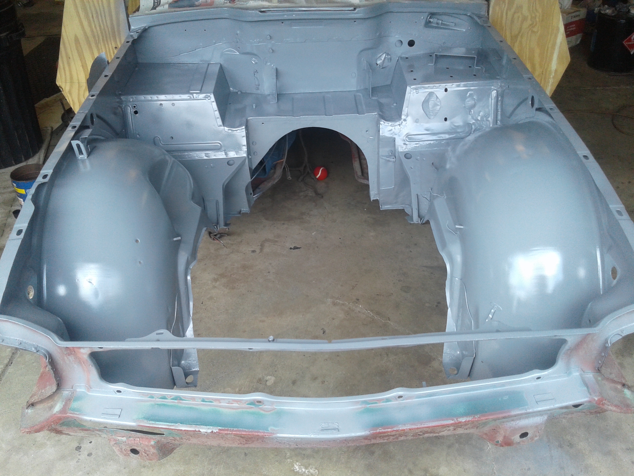

Thanks for the info. Interesting that on the commission plate it's stamped Jan 1 1969. Here is what I did yesterday and today. If you guys want I can keep post updated pics?

I had a lot of hammer and dolling to do. Nice thing is with this PPG CRE epoxy primer is you use it as a base and do all you filler, priming, seam sealing and you can even top coat over it. Got some filling and seam sealer work to do. I might even put color on it just to get the excitement juices flowing.

As with all the tr 4's the tr6"s were HAND painted behind the grill in dull black paint Make sure that you do

Found the following thought you might be interested.
In terms of aesthetics, when first produced some styling details were carried over from earlier Triumph TR models but soon dropped, such as short fender beads on part of the rear wings (fenders) on the 1968-built and possibly very early 1969-built models. The wheel rims changed slightly starting with the 1970 model year, increasing their width from 5" to 5.5", at which time the Rostyle wheel covers (hubcaps) that were standard on the TR5, TR250, and 1969 TR6s were discontinued and centre caps were used. The 1969 models also sported a unique steering wheel and a magnetic petrol filler cap

Thanks for the new info. For sure the windshield posts will be body color but I haven't decided on the rear panel yet. Got time to think about it. Anyway here is a pic of what I've done on top of the CRE primer. That the nice thing with it as it locks everything down and you do your filling work on top of it. You got 7 days from application to go right over top of it with out sanding. Metal must be sandblasted or sanded with 80 grit.
When done with the CRE primer I will probably do a couple coats of urethane sandable primer (white) then put some color on it. If I do that I'll have to clear it too.

You may consider using a darker primer if your going with red paint. If you get a chip in the paint with white primer, you'll have a white spot showing through.

Okay SC TR6 I was rereading your post and got curious about the build date of my TR6. I saw the Jan 1 1969 on the commission plate and thought that was the build date. It says it complies with all US Federal Safety Standards. So I thinking it's the new standards that start on that date. Here is a pic of my commission plate.
