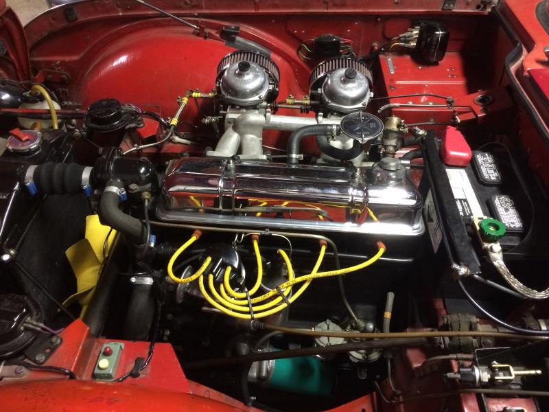

I also have negative earth on my TR4.
I personally liked the idea of moving the battery posts away from the firewall and toward the engine. I also installed a battery cut-off on the negative terminal for convenience. https://mossmotors.com/switch-battery-cut-off-1
Attached is a pic of the Group 59 battery installed in my TR4, battery posts are toward engine, neg post is at the left side.
M.
