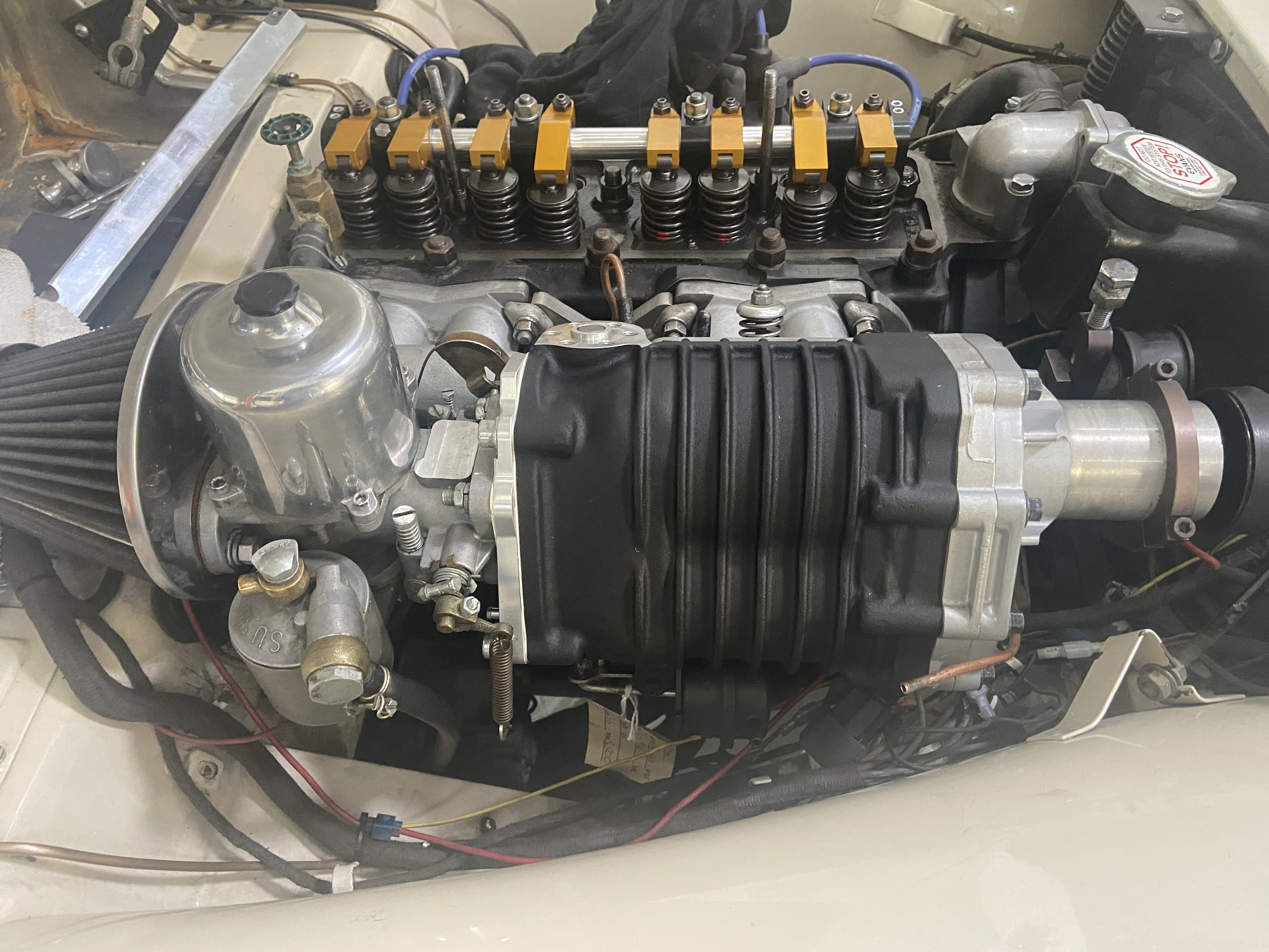

Awhile ago I ate a bolt that vibrated off the air cleaner and worked its way down into the vanes of the SC, I pulled it apart and cleaned up the burrs and tried to (fix it) the SC works but I feel that there is a balance problem because of the material that i removed from the vanes. Having a problem getting a place to repair and balance the old one,. Just talked to Moss Motors and the blower is no longer available........... Any ideas or does any body have one that they no longer want?

I believe that the supercharger you are talking about was made by Eaton. I have a similar one on my Miata. They came in different sizes according to the volume they pumped. I have an M42 size (for my 1.6 liter engine). Most likely you have an M62 which was used for 2-2.5 liter engines. The interior parts are most likely the same in a given series. See if you can find any info on exactly which model you have and maybe you can source parts that way.

Well talked to the repair shop on the supercharger shop yesterday and it is going to be another 8 weeks!!!!!!
The part they need ( rotor pack)no longer available . it took them 6 weeks to tell me that. I found a repair shop on the east coast that will repair the rotor pack for $1600 , but again 8 weeks turn around. Then assembly so not much driving the TR3 this summer. I am glad we have the TR250.

well I finally got the supercharger back. Installed it today. All I need is some vacuum line tee and the valve cover on . To anyone that has a moss motor ’s supercharger be sure to use thread lock on the air cleaner bolt. Lesson learned for $2700!
