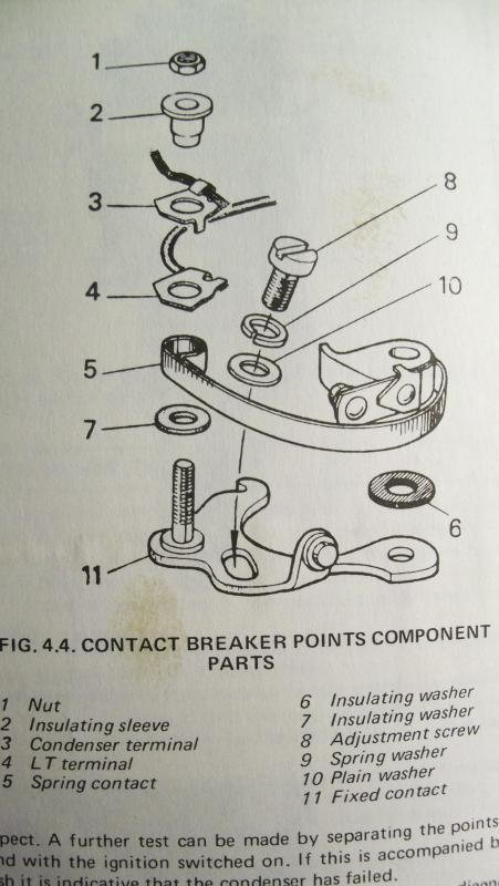

:mad-new: No start. Battery and starter crank motor. Have gas to the carbs. Have spark to the plugs. Here's the back story. I was installing new points and condensor. I managed to drop the the hold down plate screw "lock washer" into the distributor so I had to remove the dist and shake out the lock washer. However I was very careful to mark a number of places on the distributor to make sure I put it back in the same place. Did not move the engine. I've checked the grounds at the battery and body. No wires loose at the ignition switch. Anyone have any ideas of how to track down the issue? I'm not at the side of the road or anything but in the garage.
poolboy
TR6 ignition points 001.jpgSee if you have this..special attention to parts 2, 6 and 7

Would that insulating washer come installed on a new set of points?
If you mean #6, typically yes these days.
