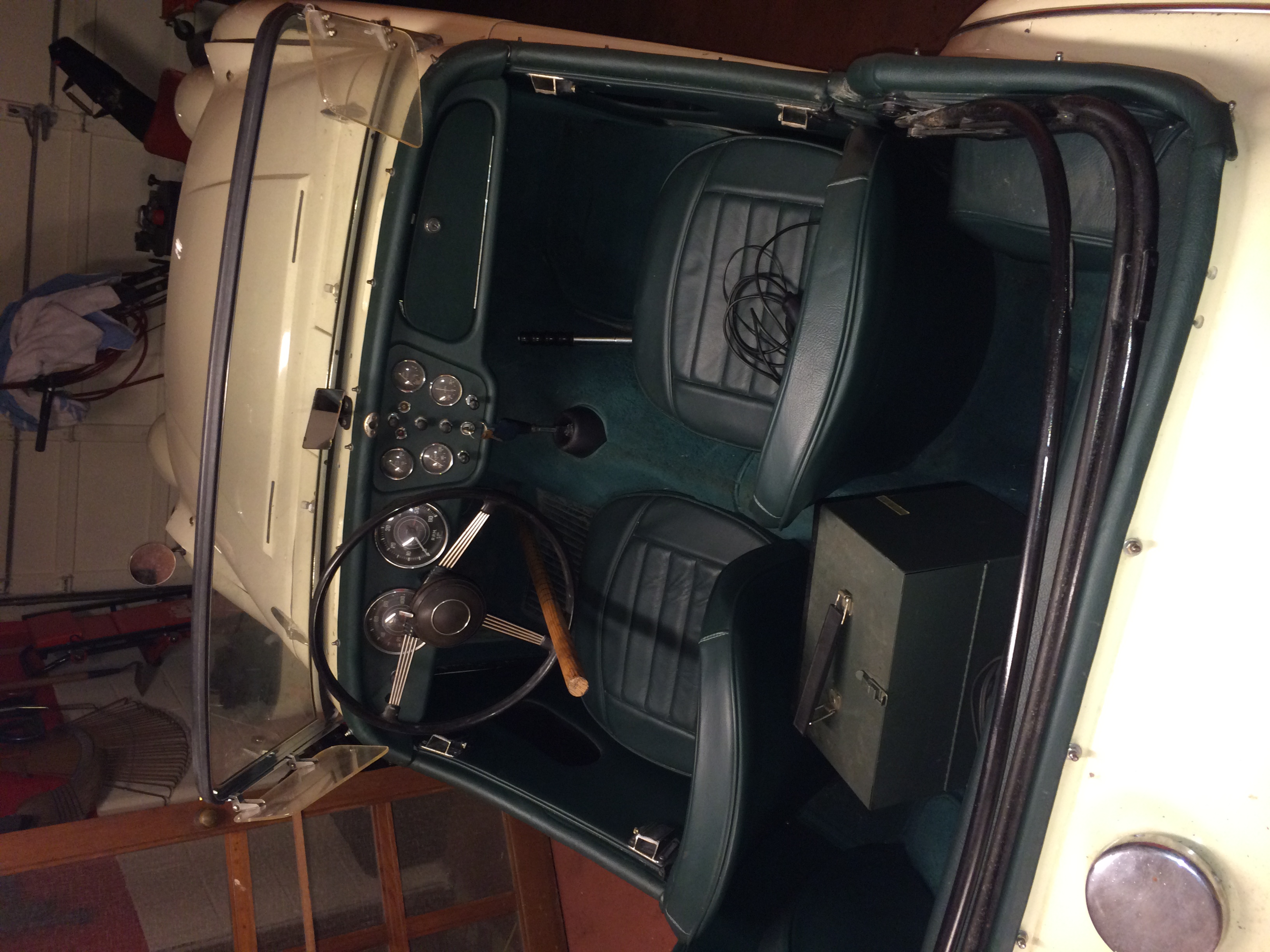

If anyone can help or has experience with this, please shed some light on the topic. I found this photo, that shows the back of the frame with no webbing, but with the plates on it, and the missing ones on the body,-Tim
