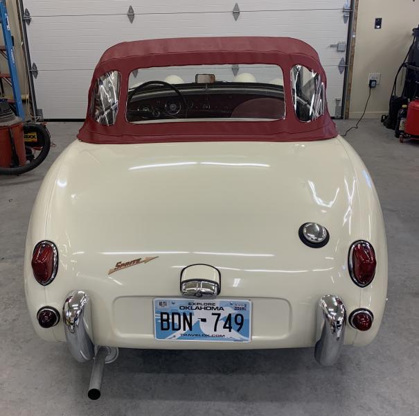

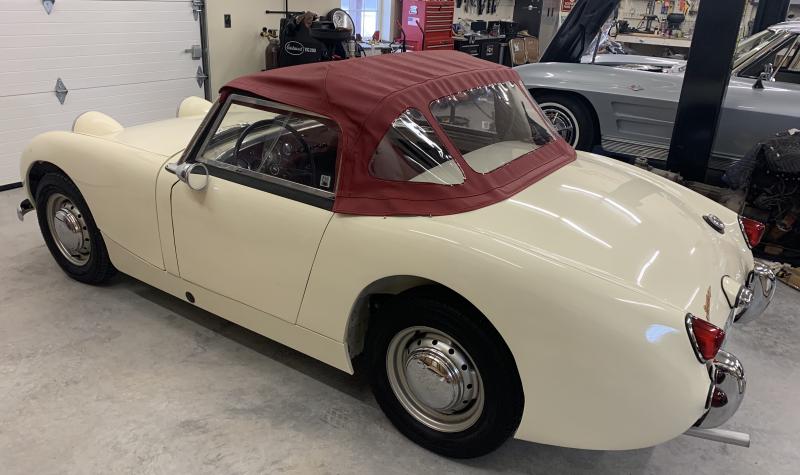

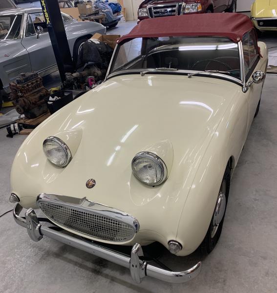

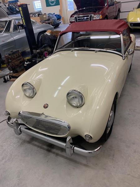

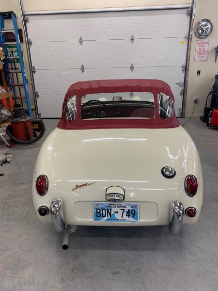

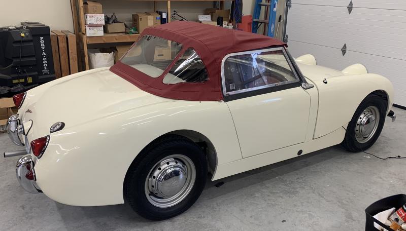

Well after fitting the side curtains, I determined that the rake and position of the windscreen was correct and is not the problem. There was no way that top was going on. So I bit the bullet and ended up sawing 1.25 in off each side of the top bow where it slips into the body slots. I did it step wise - 3/4 in, then 1 in, then 1.25 until I could finally get the top to stretch over the windscreen frame and attach properly.It's not perfect, but I'm pretty happy with the result.
I figure I can always add spacers in the slots (eg. wooden dowels) if I need to raise it back up a bit in the summer.
I made the cuts on the non-original 2 piece bow, and for now I'm leaving my original one-piece bow unmolested and intact.
