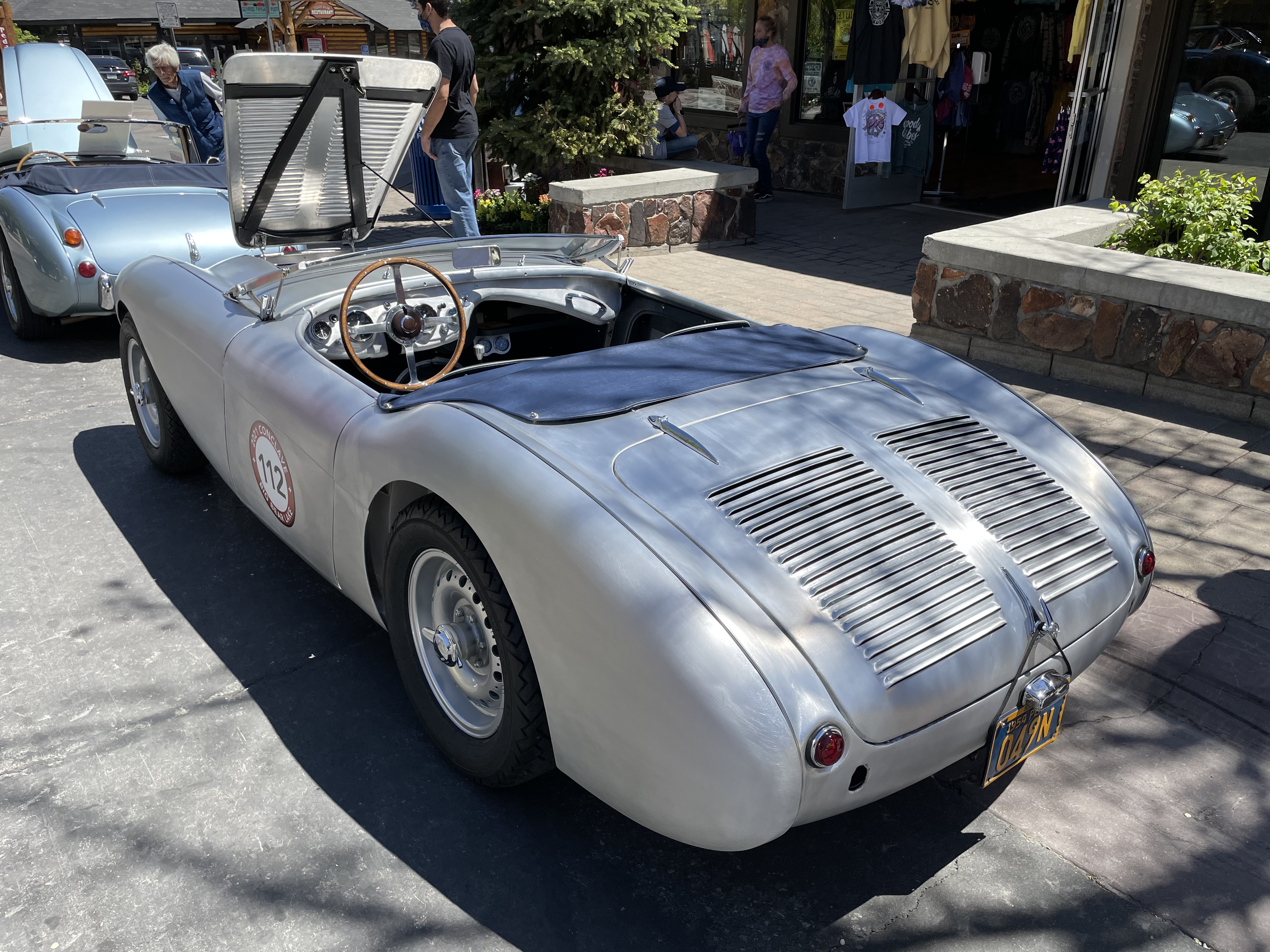

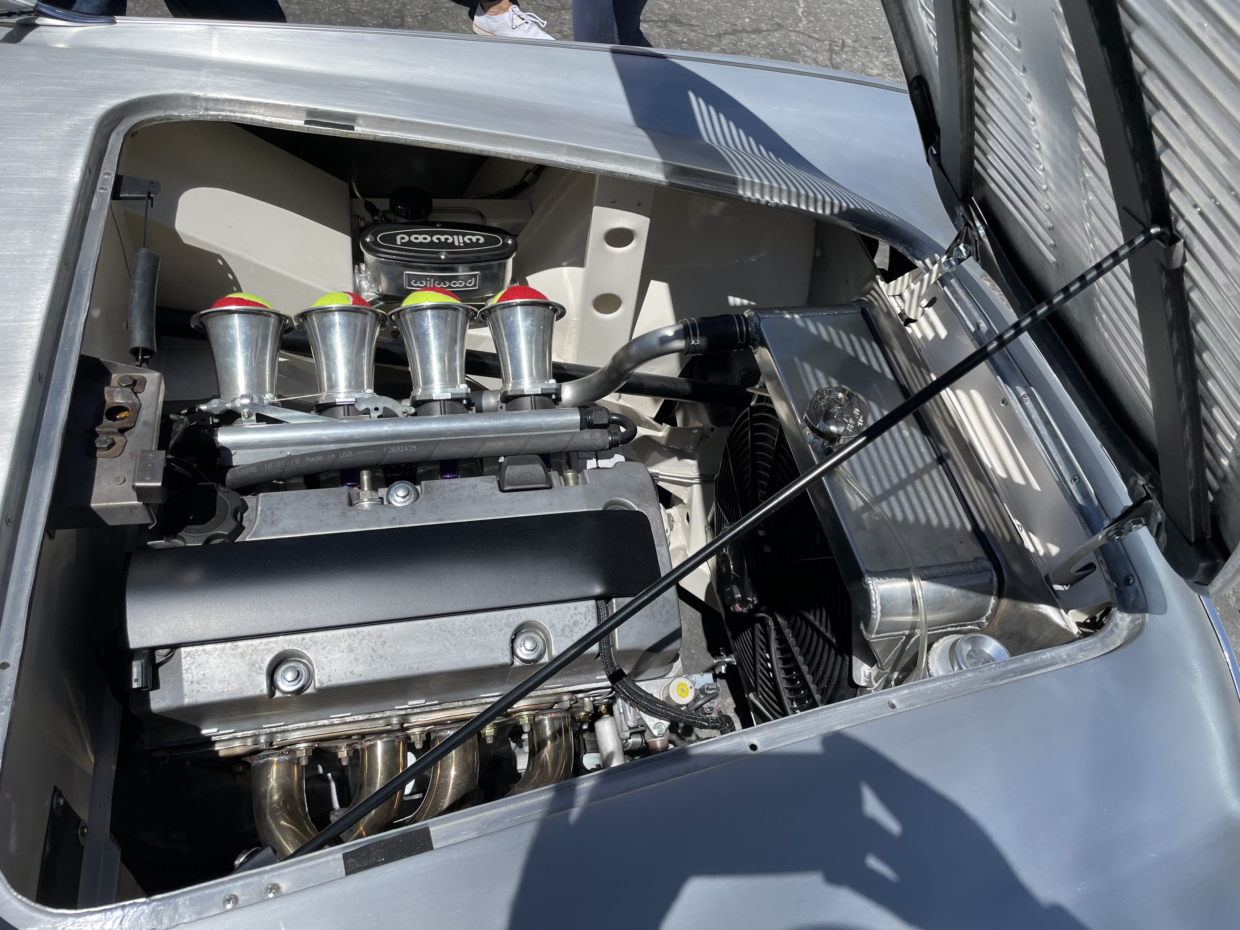

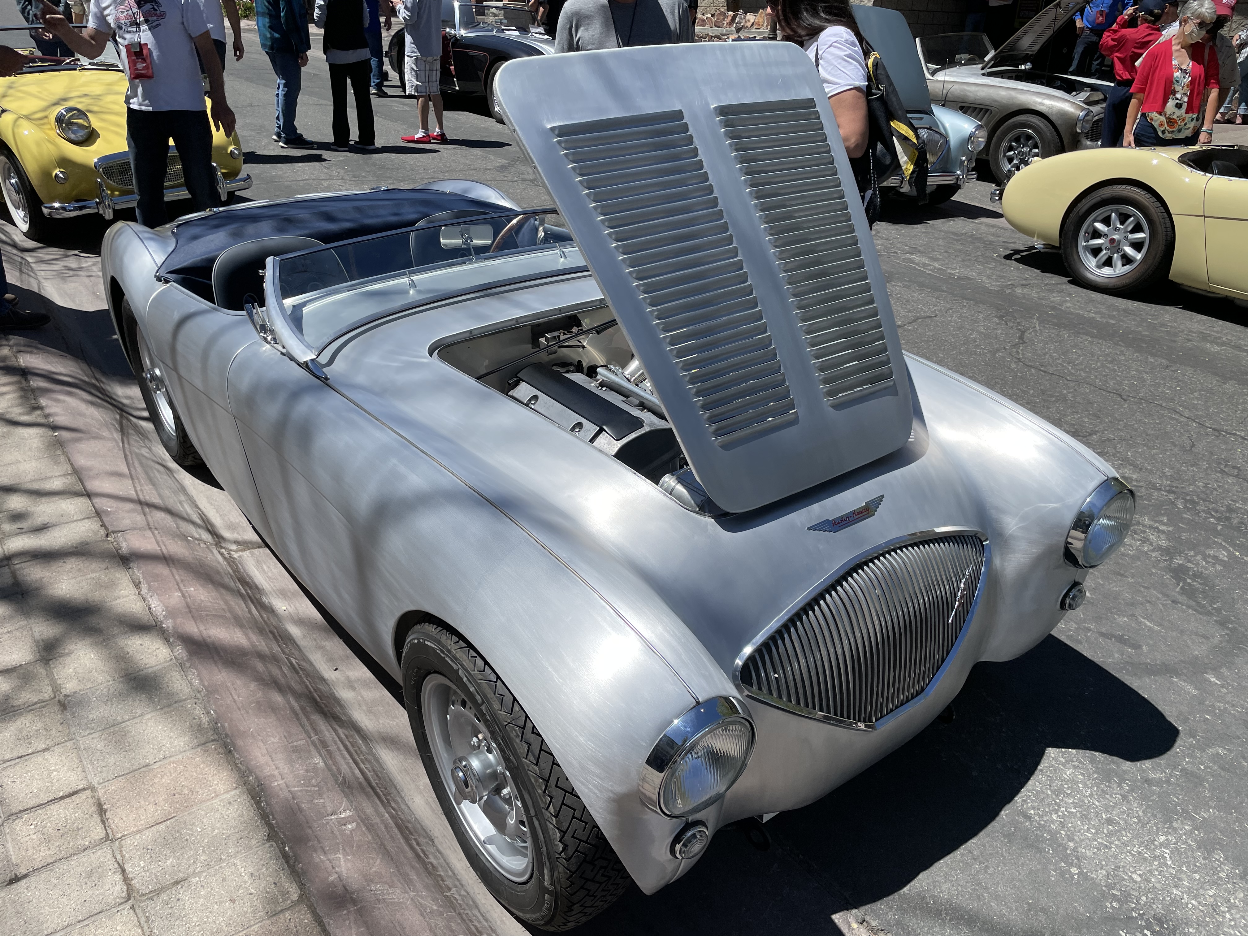

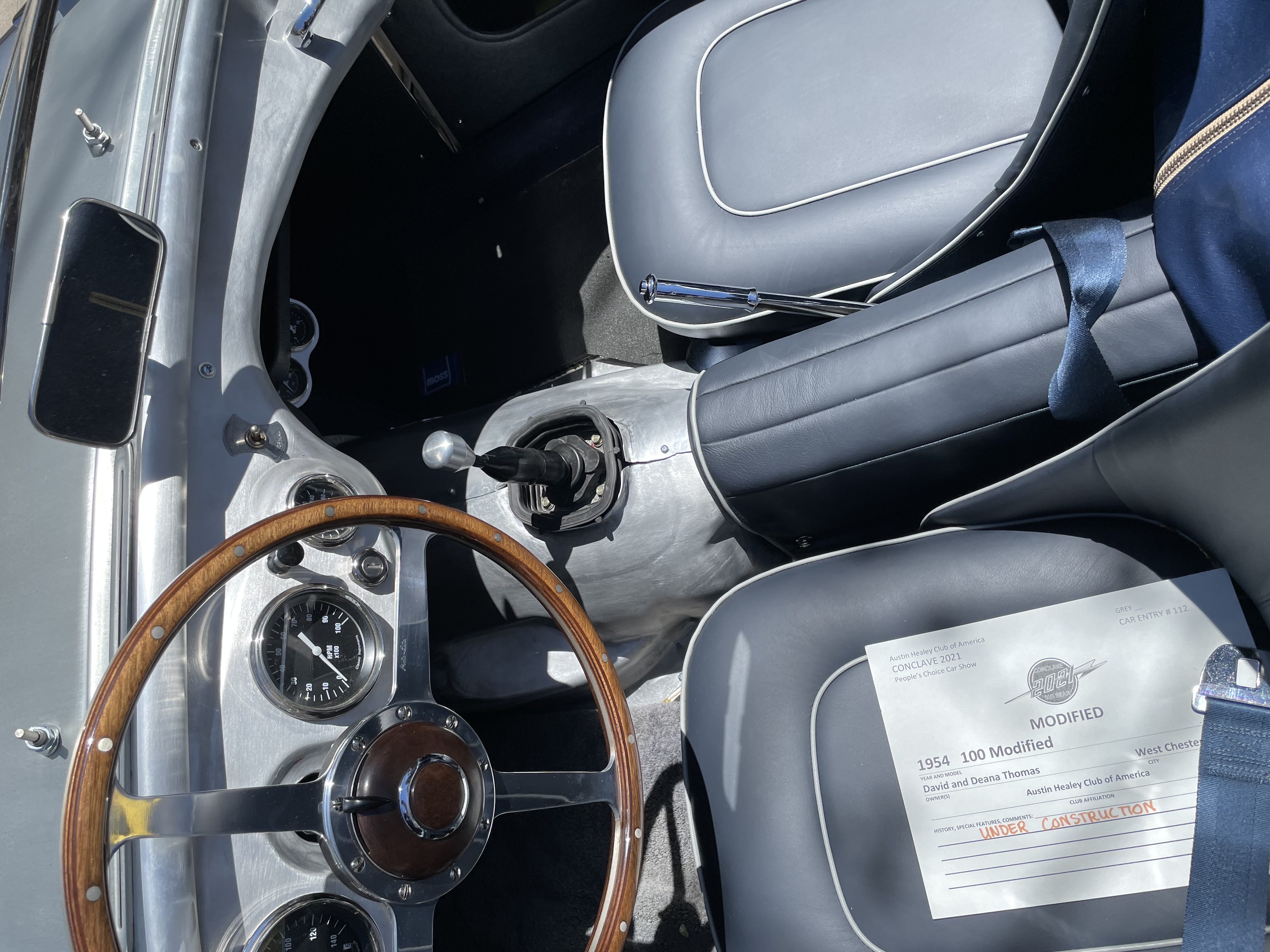

Dougie - it has already been done on a Healey BN1 - F20C with six speed stick. 240 hp and 9000 rpm red line - my favorite engine swap….
Nice!
Very clean engine bay as well which is aways a plus.
