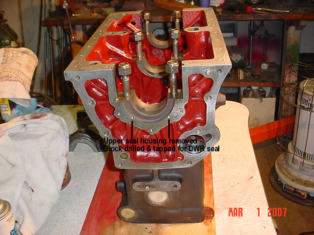

When I rebuilt my BN2 engine, which was factory original, there was ample evidence that the entire inside of the crankcase was painted with a reddish "Glyptal" type paint. This is often done to seal the metal pores. See pic of the original interior before hot tanking. Orange now turned brown but still intact. Also a pic of repainting the interior after block cleaning.
The outside of the block also showed this same undercoat beneath the metallic green final paint. If you look at an original engine carefully, there will be reddish orange spots where the factory original metallic green did not cover the red.

The Glyptal was brushed. The exterior is Moss spray can. As with all metallic paints, light, dry, spray coats give a light color. Heavy wet coats give a darker color.
