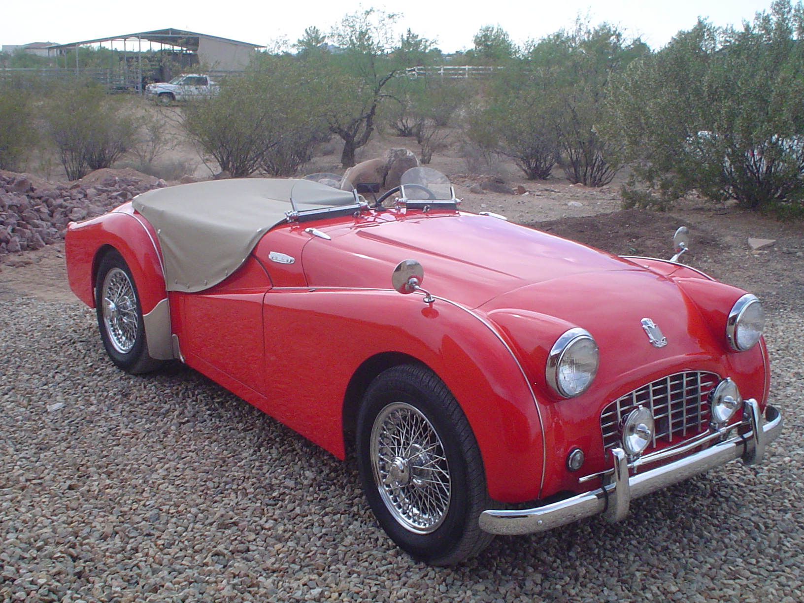

My last sojourn here was with a '56 small mouth TR3, but memories and all...you know the deal.
Pat
