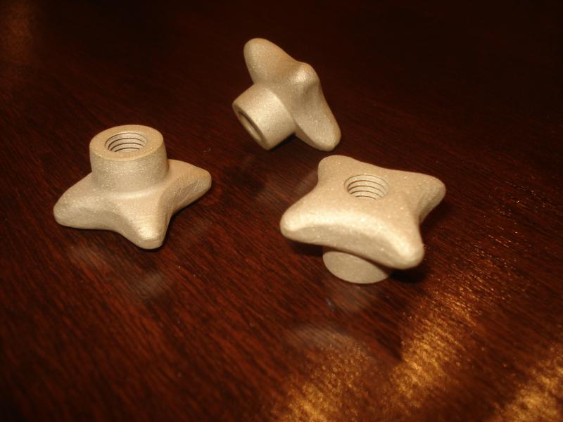

healeyblue
I have made those and need to get them chromed. I hope to soon. Let me know how many are needed. I will sell them for 75.00 a pair or 40.00 a piece.
I also would like two. Let me know when you’re ready and we’ll go from there. Thanks!
healeyblue
I will not get to the chrome shop for a few weeks so bear with me. I do have a hand full already made so that will speed things up. I can sell them un chromed for 50.00 a pair if you have a local source of your own. PM me if interested to purchase now before I send the batch out next week or the week after. I do have some stock left to make a few more pairs if I run out.
