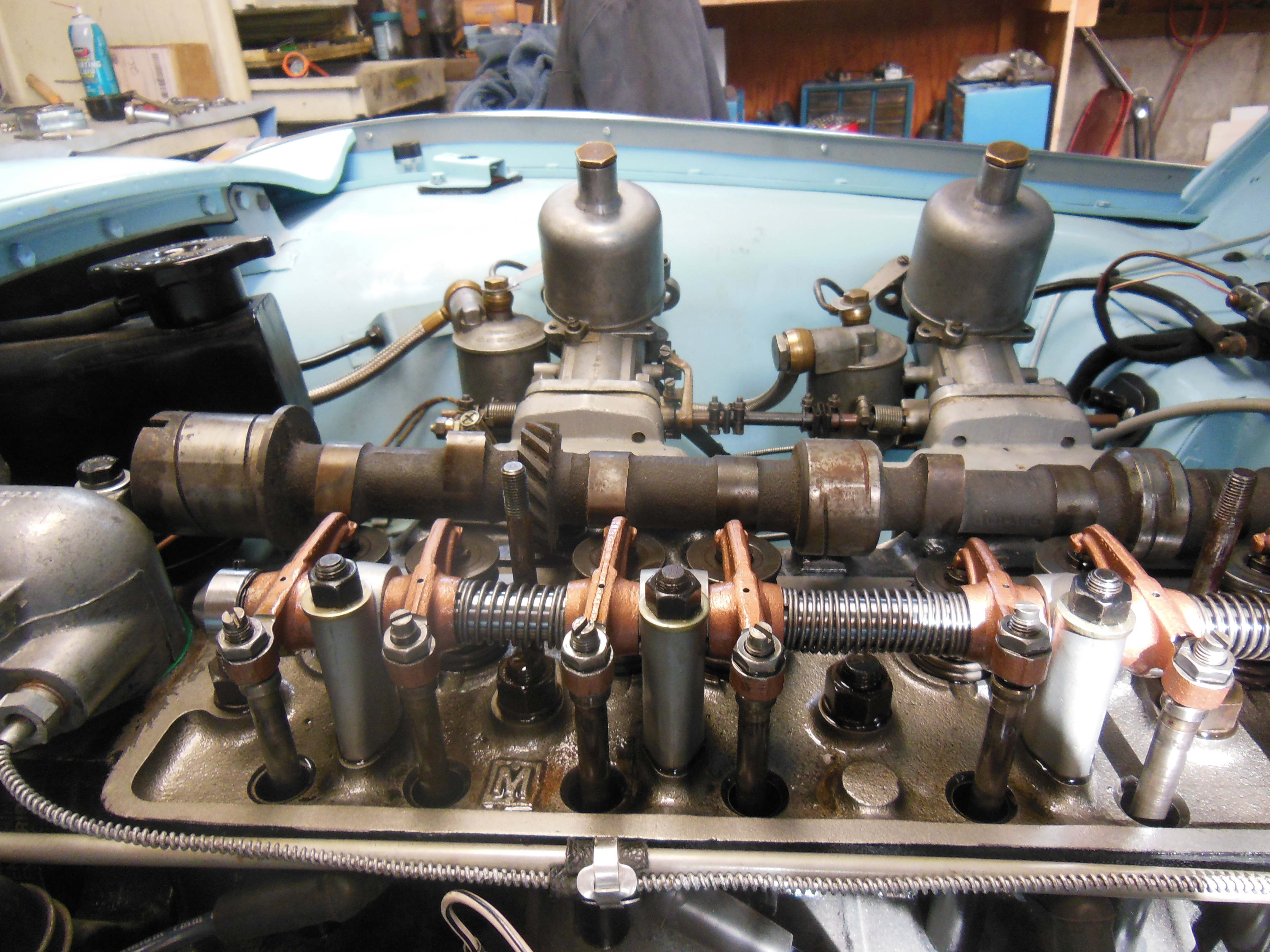

I have had problems getting the engine to run correct on this tr3 ever since I tried to drive it after a 20 minute break in at 2000rpm. I put the new rocker assembly on and that quitted the engine, so I could think clearer.
The problem is a rough running engine as I give it more fuel. I have it idling 900 and it sounds great at idle, but when I push on the gas the engine shutters and pulses slightly as I go through the RPM rang to 3000. I replaced the coil and distributor, but the problem is the same. It could be both distributors are worn out because they are original.
The one thing that is freaking me out is when I set the lifters. I set them the way the Haynes manual suggest with an opening sequence of one valve and the setting of another when the valve is close. Well what I notice is number 1 intake hardly moves. The spring just moves just a little on opening say maybe a 1/8 of an inch all the other valve springs move more freely and open maybe 3/8.
The only thing I can think of is the cam is flat and will not force the spring open. The head was rebuilt at a machine shop and I paid top dollar. I have no experience with valve springs and their movement, but it would seem they should have the same movement. I did used the old cam shaft after I eye balled it over good 5 years ago i think.
Does anyone have a suggestion to help narrow this problem down more? Part of me wants to purchase a new distributor from BPNW and the other part wants me to pull the cam out. There are only about 10 miles on the engine
desperate Steve

just throwing out an idea but you could check cam by measuring rocker lift with dial indicator. No need to remove cam to check for worn lobe. Compare all 4 one to another. Frank
bobhustead
Check the valve lash on #1 by turning the engine by hand, watching the exhaust valve open and close, the intake valve open and close, and continuing to turn the crank until the timing mark and pointer are aligned. This is TDC compression stroke and the lifters will be on the bottom of the cam lobe. Set the valves on # 1 here and see if you still have the insufficiently short valve train movement. I set my valves this way, with the timing mark opposite the pointer on 2 and 3, of course.
Bob

I think I can get a dial indicator at HP, but I have no real experience with setting one up on an engine to read the lift. It is probably easy, but I have never done it. The more I think about it, the cam is probably shot because there is no real time for the valve to stay open from what I see without the valve cover.
I really want to get lucky and have someone say that I cannot tell for sure just by looking how long the valve is open or if this could cause the stumbling. the poor running-is- kinda like there is no oil in the carbs or something. Once I had a miss that was caused by the carb bowl being partially plugged and itwas like this some, but I do not think so because they are recently rebuilt, but heck better than the cam.

When I noticed two valves not opening much during a valve adjustment, as much as I didn’t like the prospect, geometry ruled, and it was indeed two flattened cam lobes. I replaced the cam with the performance cam from British Parts Northwest, and the car is running great. The rattle/knock I was trying to identify is gone. I had never gone so deep as to replace a cam shaft, but it was certainly doable, interesting, and ultimately satisfying. I also listened to a Stephen King book or two on Audible during the process. The dial gauge was easy to figure out, and the Rusty Beauties YouTube were helpful.

You speak of a 20-minute break in--was the engine recently rebuilt? If so, why wouldn't a camshaft problem be noticed?
I really doubt that you have a seriously worn lobe. That would be major damage, with noise and lots of metal in the oil. The lifter would be a mess, too. More likely you just didn't get the valves adjusted right. I suggest going through it again using the shop-manual procedure.
Or, I'd take Frank's advice and put a micrometer on the end of the pushrod. I think it would be easiest, in the long run, to take off the rocker assembly. Then set up the micrometer with a magnetic holder, turn the engine over by hand (remove the plugs to make it easier) and see what the lift is. It's a really simple procedure and it will answer the question once and for all.

I am starting see how a dial indicator would rule out the cam like Frank and Steve M. suggested plus take another look at lash setting. What put the light on for me, and how I could test stuff with a dial indicator was when Steve suggested removing the rocker assembly, and then looking at the height of the push rods.
From what I am seeing, I should be able to measure with a ruler the lack of lift in #1 intake. Today I will pull the plugs to see how rich it is running and remove the valve cover and stare at the car.

Well I measured with a ruler that an open valve is 1-5/8 above the head on outer edge at the top of a push rod. All mine are 1-5/8 except #2 intake which is 1-5/16 a difference of about 3/8. The picture of the cam lying on head is probably difficult to see, but effective to understand. What I am trying to demonstrates is the #2 intake and 3 # exhaust are both open at the same time. The picture shows how #3 exhausts is open and #2 intake is not open when # 2 should be open. #2 intake actually does not move, but about 1/16 WTF.
Anyways it is new cam time and I could use some suggestions. I kinda like the idea of a performance cam, but I hear stories that a performance cam will not let the engine idle down. I prefer a tr3 that would idle at 8K or 9K. I really do not like it when the engine idles at say 11K or 12K, so Stevery what does your engine idle at with the performance cam. Or is all this high idle stuff only for more serious racing cams. And I need any suggestions that would help me with my decision on which cam to get and anything else, anything.

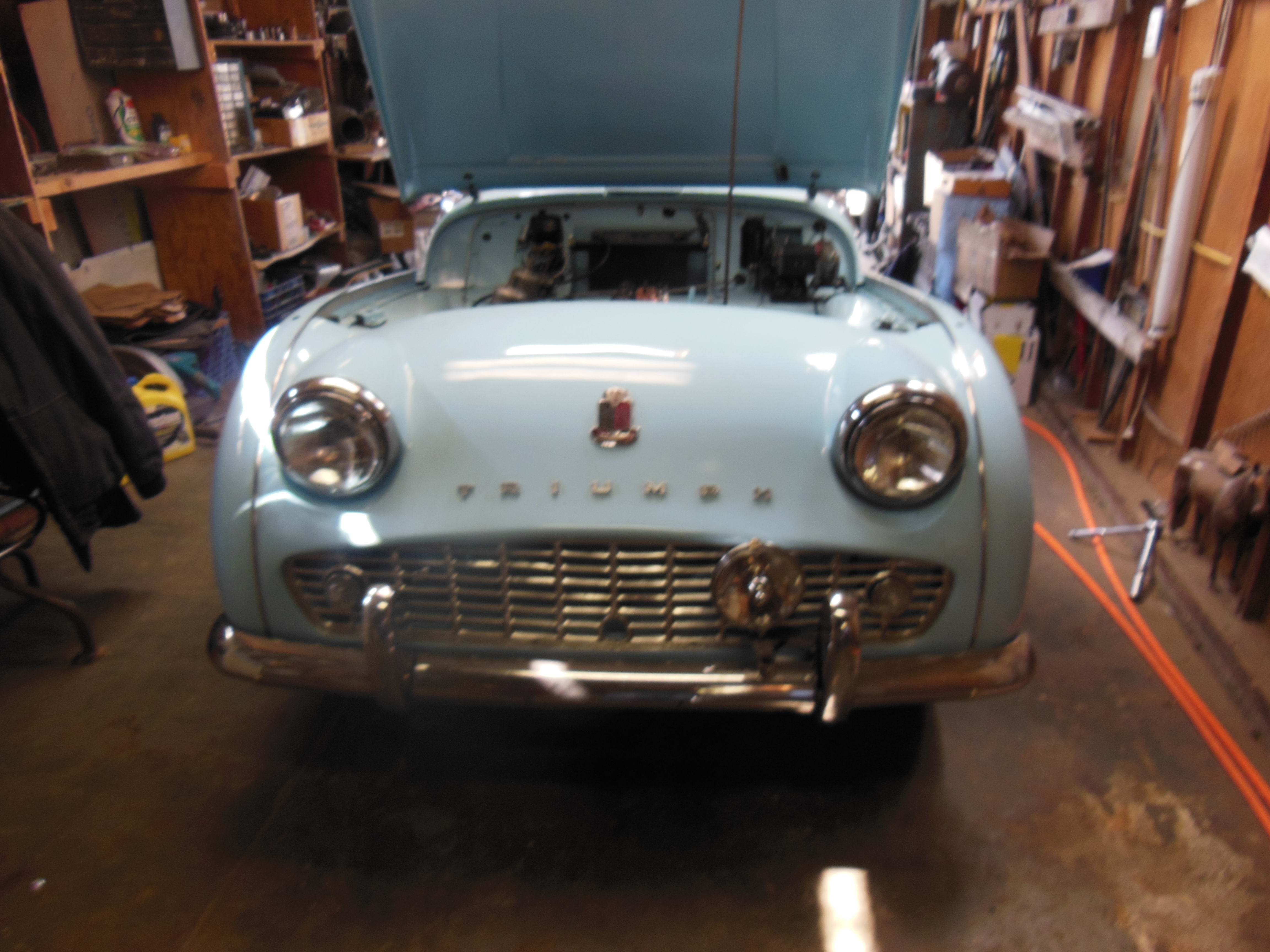

Well, the car looks great!

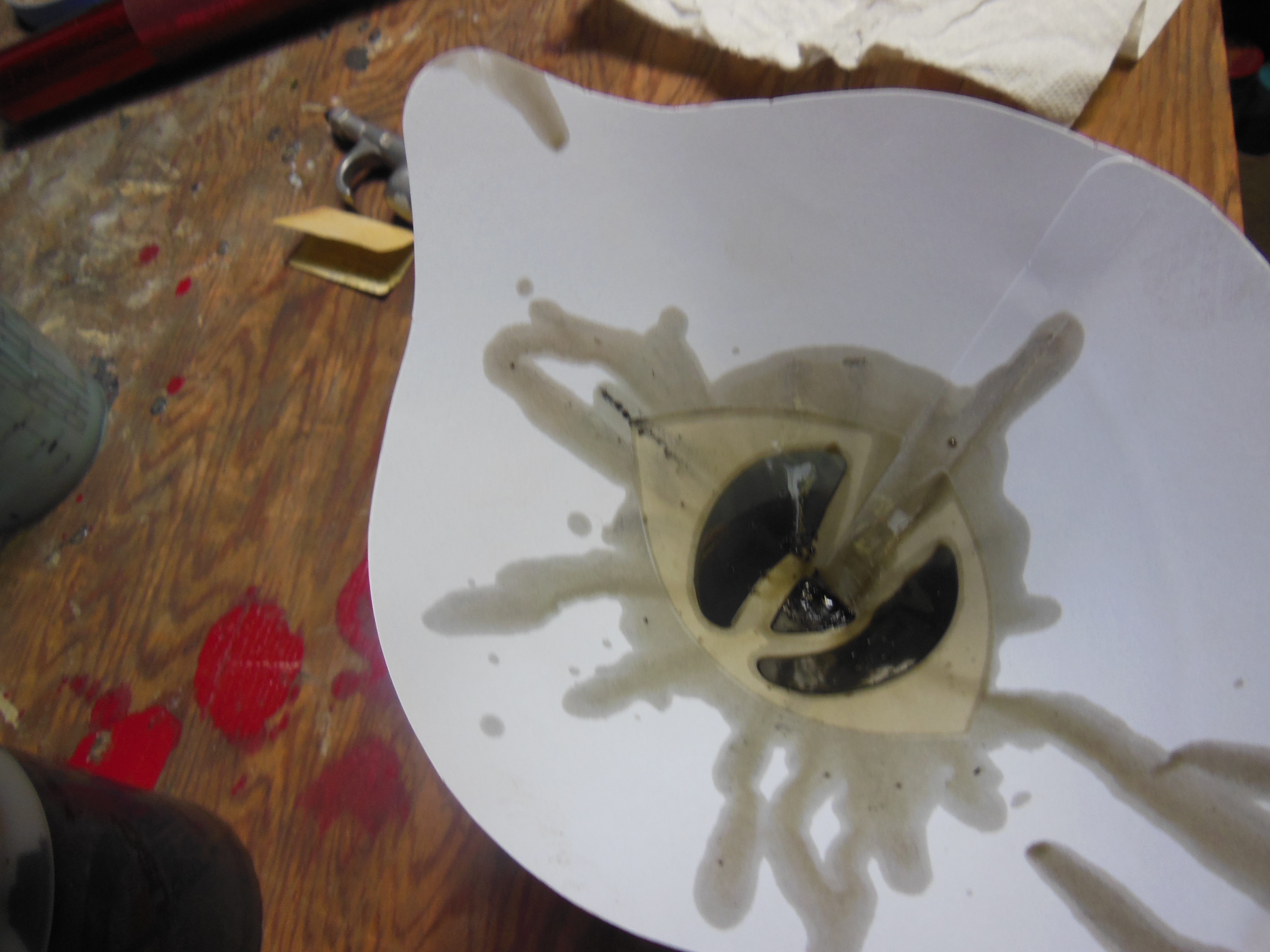

John, I drained the oil into a white garbage bag placed into an oil drain container and there was no obvious metal. I tried with a magnet to fish some metal out but no go. The metal is probably in the pan or pump screen or in the oil filter. Today I will pour the oil through a paint filter to find some particles.

Went down and dumped the oil from the filter into a painting filter and it was full of metal chunks. Anyways, I am not sure how much of the engine needs to come apart. I kinda do not want to pull the crank. I guess the rest needs to be cleaned. How about the oil gallery that goes down the side?

Well bummer.
If you have the later, full flow filter head, then 100% of the oil goes through the filter. In that case you are good leaving the crank in. The TR2 and very early TR3's used the "bypass filter", where only the oil bypassed to reduce the pressure goes through the filter. The TR2 would put all that metal right back into the oil galleries to the crank.
