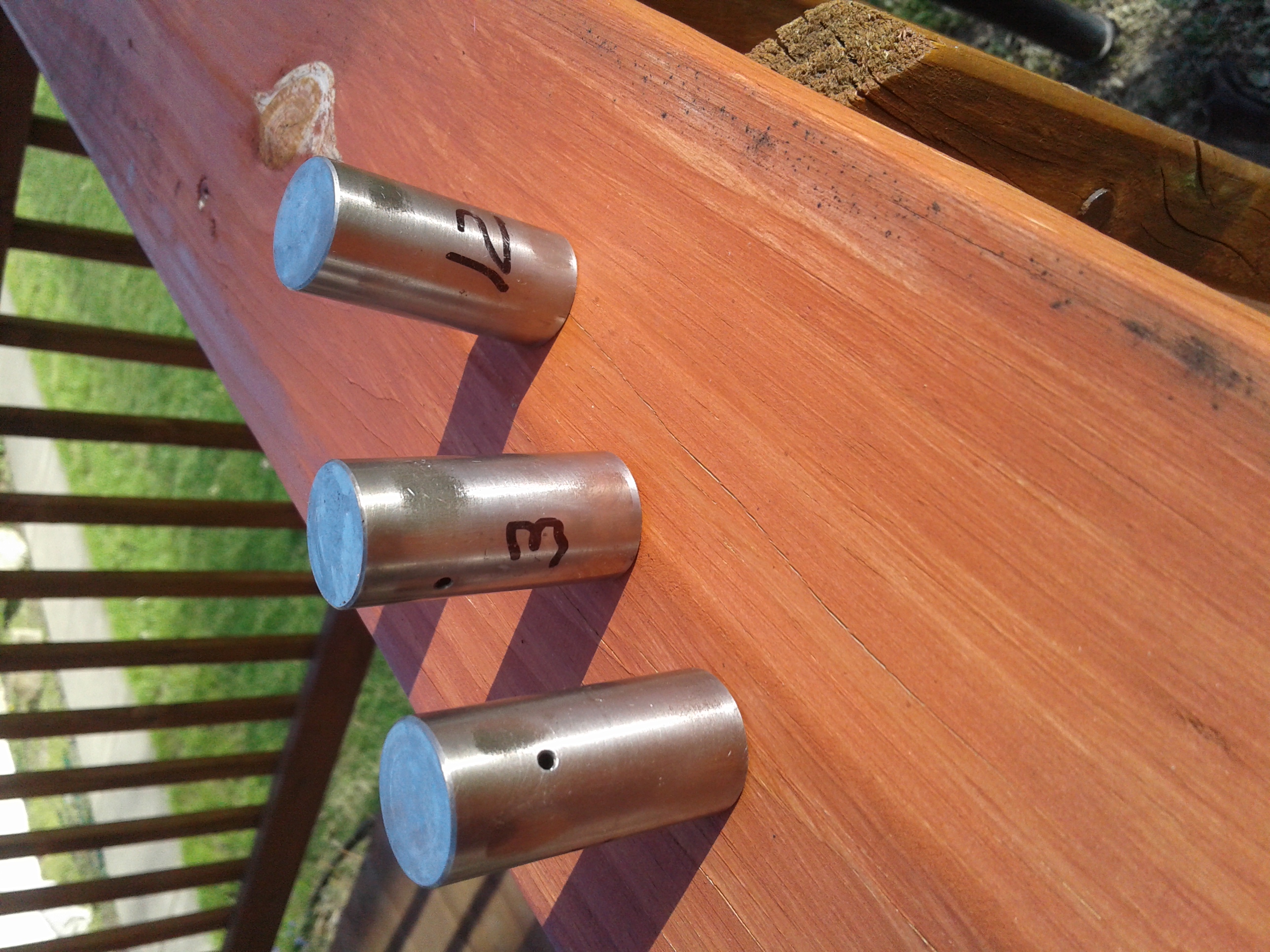

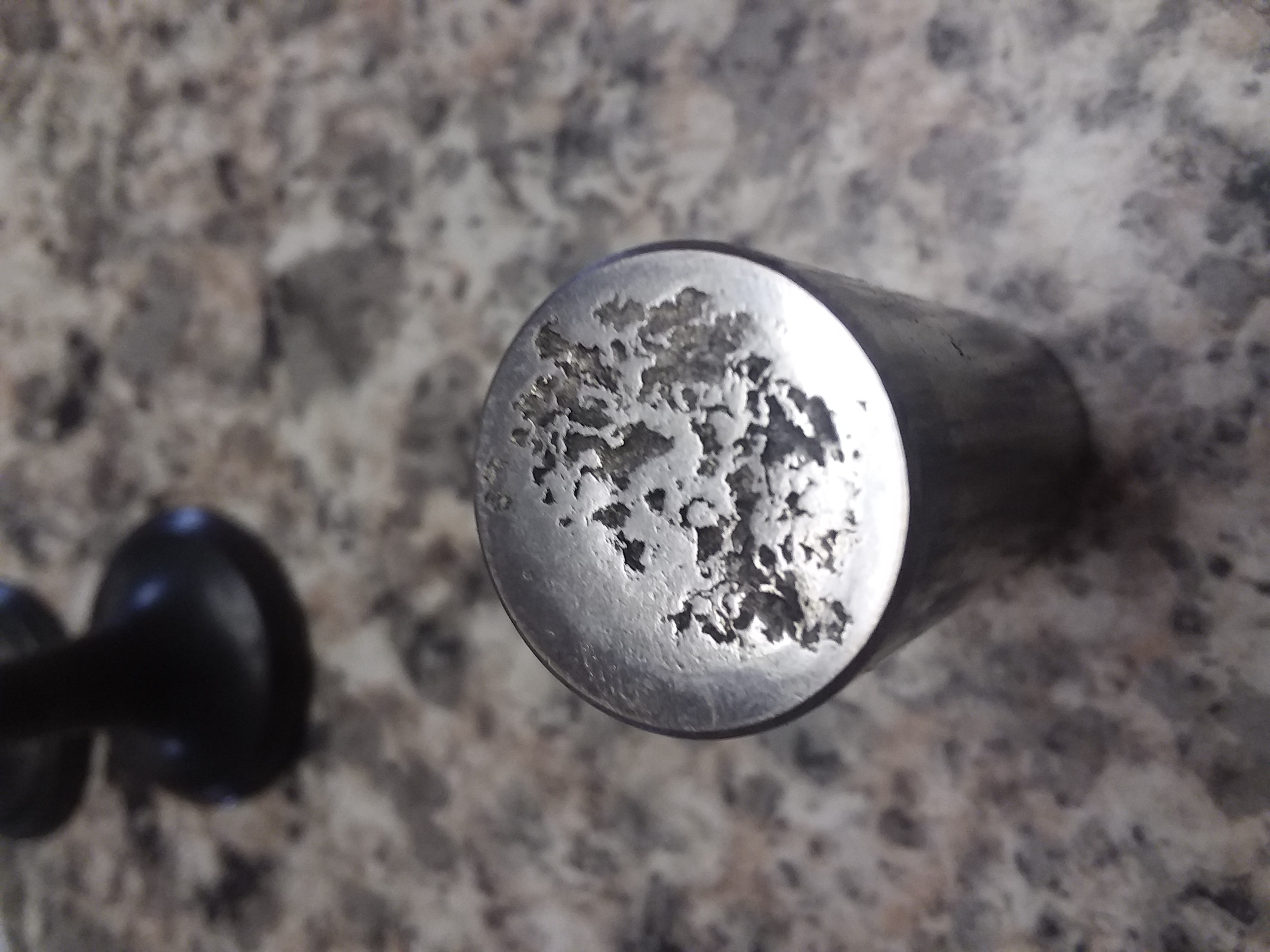

Had my original cam reground to a new profile by Delta Cam in Tacoma Washington back in 03. At the time I purchased new lifters from TRF. Did the Ishy cam brake in lube and the proper brake in over time and always use oil with ZDDP in it. It's been over 20k miles now and had to remove the head to replace the head gasket. Much to my surprise #1 lifter is toast! Pulled the cam and #1 &3 have some pitting. My mechanic thinks it was a lifter malfunction vs cam. I have a couple of cams left here one is the same profile and the other is an original stock regrind. My dilemma now is what lifters to get. Not going with the standard grade ones but don't want to spend $300 ether. Anyway Moss has the APT # 838-307 at $269. Ouch! Are they really that good? BPNW has a heavy duty tappet that is tuftrided for $7.95 each. My mechanic was trying to get me to buy some composite ones where the composite was used in the Space Shuttle tiles. They were over $300 back in 03 and not even available now. Looking for someone who has used the Moss or BPNW ones and would like to here their results.

I'd have someone see if the valve springs are appropriate compressed length for the cam....I'm thinking maybe spring bind. Maybe.

I'll say I think I had spring bind on the original valve springs because 3 of them broke over time. Still had 20k on it before it happened so can't say for sure and I forgot to measure the gap if any when I took the old springs out. When the 3rd one broke I knew it wasn't a fluke and had to do something. I order the ones from BPNW that are designed for more valve travel and don't have a lot of spring pressure ether. My mechanic has a spring pressure machine and they were within Triumph specks.
Looking at the lifters the markings on the sides leads me to believe that they aren't turning freely ether. My block was brand new back in 03 when I built the motor. TRF had brand new blocks that Charles found in the UK somewhere. The new block was half the cost of the machining of my old one so I did it. Hopefully there are more options out there then just these 2 choices.

Lifters should be Rockwell tested as a precaution. I have seen Lifters from good part suppliers that were
garbage when new . They should be hardened to at least 60 , less is WAY substandard.
