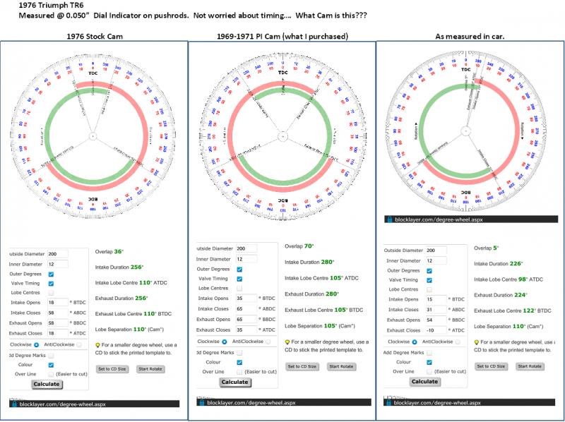

1976 Triumph TR6
Purchased: 1969-71 PI cam
The car won't pull vacuum, 7.5- 9.5 hg buzzing needle.
Measured as installed. Dial indicator on push rods of #1 cylinder. @0.050"
.... never mind the centering, 6deg overlap? no such cam as far as I can tell?
have a look at the attachment.
What cam is this?
Or...
How could I have messed up measuring it?
any insight would be appreciated.
Stephen
