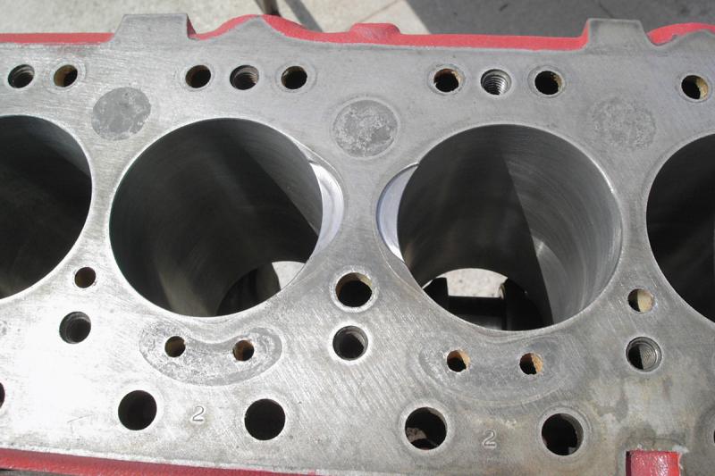

There’s no pocket in the pistons, there are pockets in the block. The intake valves go wider than the bore. The head gasket has pockets in it to avoid the valves. That will tell you the position of the pockets. You’ll need to assemble the head off the engine and apply 11.57 mm lift to the rocker arm and measure how much the valve extends past the face of the head. That will tell you how deep to go.
GregW
Here is a visual for you on the pockets.

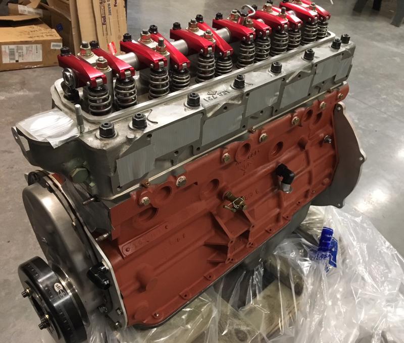

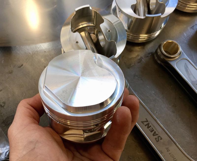

Radical yes, but no pockets needed in the piston, just a beautifully milled dome. With the combination of cam lift and roller rocker ratio, I'm at the max pocket depth.

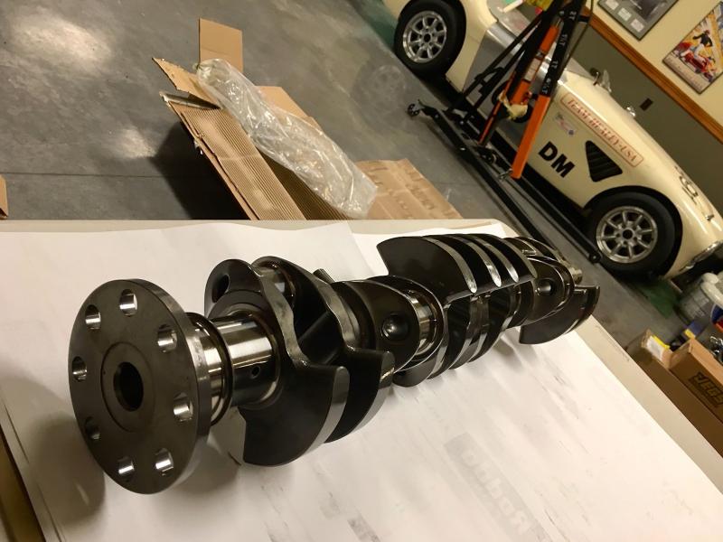

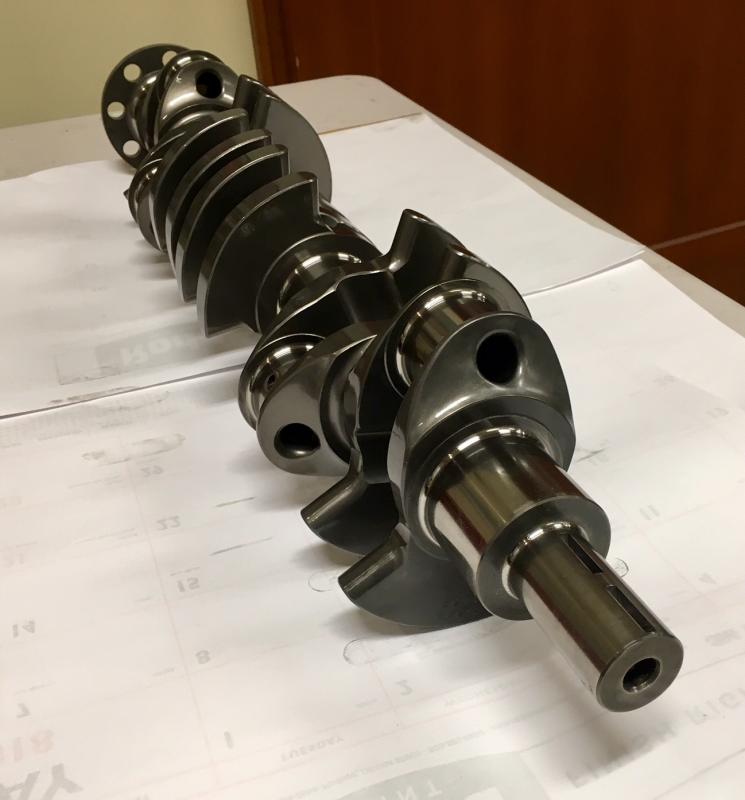

Race motors never see freezing temperatures, but simple plugs can fail under extereme (6-24 hour) race conditions. The threaded plugs stay in place and the large freeze plugs are epoxied sealed. The black flare fittings are part a special designed and engineered side oiler system which inputs the oil from the oil cooler directly to the crank & main bearings first before circulating throughout the entire motor. This is the key to extending the life of the custom billet crank....
Healey Nut
That crank is a piece of art . Tks Dougie .
