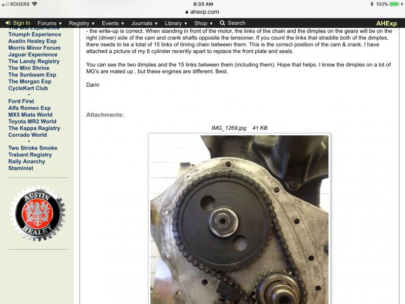

My harmonic balancer delaminated so am replacing. Decided to open Pandora's box and replace the timing chain, gears, and tensioner along with the water pump. Car always ran rough and was hard to time. Dots on old gears did not line up per book. Crank is now TDC #1 with slot at 12 o'clock. When I set cam shaft slot to 12 o'clock, valves #6 are closed and #1 open. I must be 180 out but thought I was following the manual. Engine is in the car. Thoughts?

Thank you Jedi. I understand the link count but it is the timing of the gear position to what the valves are doing is my problem. With the gear in the position shown in your photo, the #6 valves are closed. I assumed this would be the firing position for #1 but both those valves are open.
Healey Nut
Follow the link to the old thread and all will be revealed . Gear position relative to valve position relative to firing order piston position etc . Its all in there .
bob hughes
You can not quite see the indent for the top (camshaft) sprocket in Randy's picture but it is there under the top red mark.
One you have lined up everything as shown, your relative timing - pistons to camshaft can not be wrong.
Unless you have a cam in there from some other vehicle - highly unlikely to impossible :angel2: or you have one of DW's special cam sprockets that will allow variations for square cams, comes in two pieces for adjustments to occur !!!
