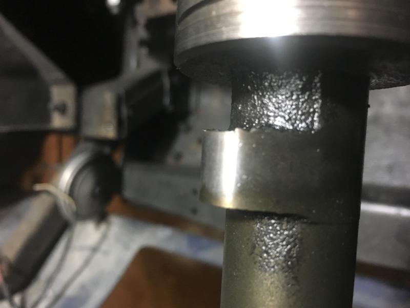

One more related question; the picture attached is the #1 intake lobe as seen through the tappet hole. Am I looking too carefully or is the edge of the lobe 'chipped' a bit? The cam and motor have less than 500 miles on it, however I could believe the crook that put it together for me could have used a worn bump stick. He did lie and say it was a 'fast road' cam, anyway.

Yes, it does look chipped. I wouldn't take any chances and I would degree the cam properly. I'd probably want to remove the cam and have a look at it before doing anything...you might want to look for some markings on it to know exactly what you have.
Wouldn't want anything catastrophic to happen....at +060, you would have to get a new block or look at re-sleeving.
My 2 cents.

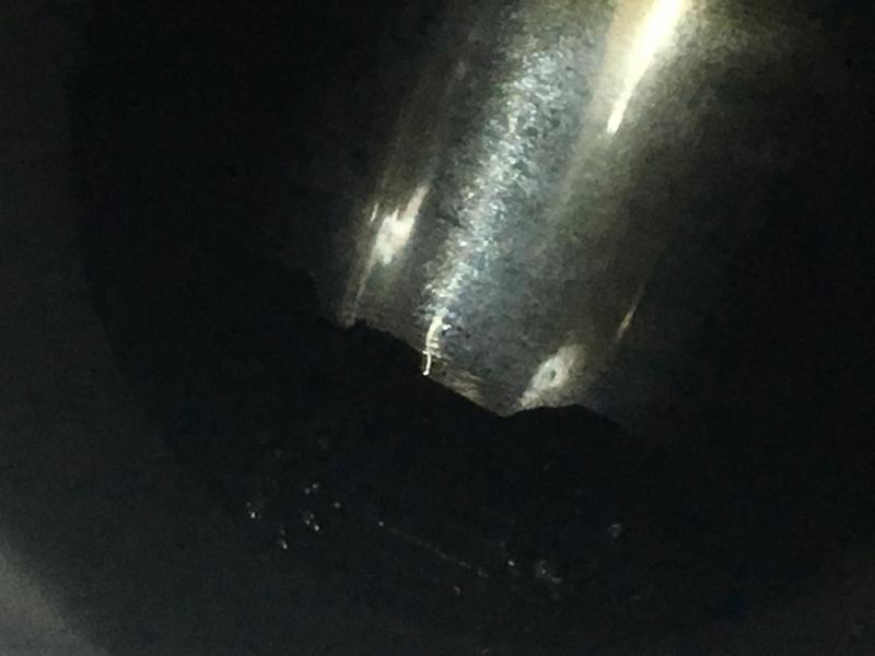

attached is a picture best I could get of the #6 intake lobe. It looks wrecked. Is this another item on the bill of ****e goods I was sold, meaning it was a bad cam, or could something have caused this in such an short time?

Im going to be a bit on the optimistic side and hope that the cam may have been welded and reground. I've had some other LBC cams that were rough on the side of the lobe, but not as rough as your appear to be. Before doing anything drastic you can make a small investment in a magnetic dial gauge and measure your cam and you can also buy one of those cheap bore scopes they sell on eBay for a better inspection. If you decide to buy either, Summit is a good source for the dial gauge. Good luck and let us know what you find.

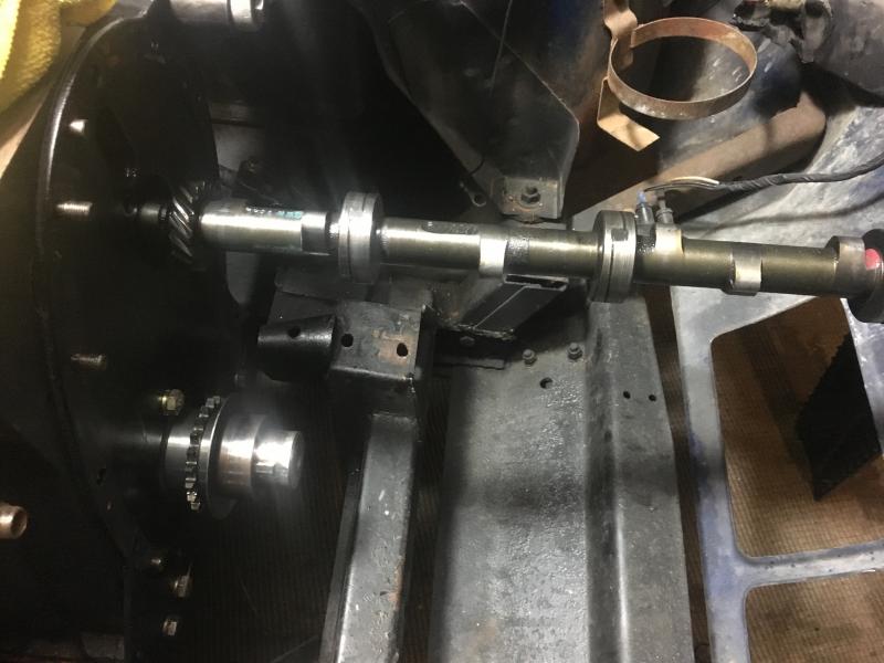

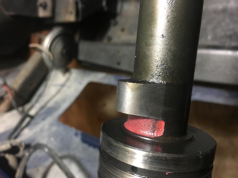

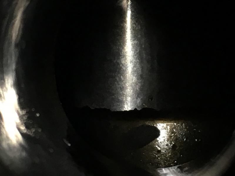

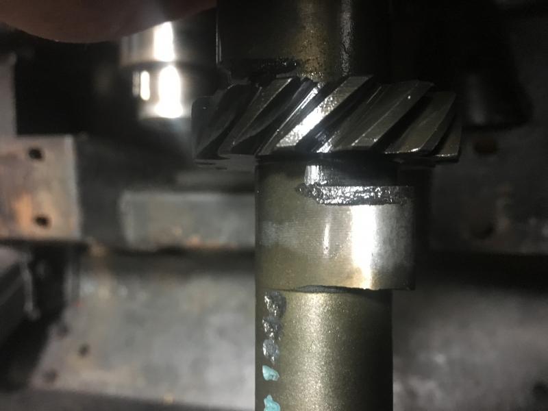

I do indeed have a dual gauge AND a degree wheel. I've got to learn how to use the wheel, and this looks like the opportunity. I had a few hours this evening to mess around with the car as the wife was away, so I decided to remove the cam. I was already more than halfway there, what with the head off.
attached are some pictures of the lobes so far. Confirmed it is a stanpart stock shaft. You all would help me greatly in evaluating the rough edges and what wear is visible on the lobes. I have the original service manuals, which deal with removing and refitting, but no information on measuring lobe heights, etc. I have a caliper I can do that with, if I had the figures.
What should i do I do from here? If the consensus is the cam is fine for another 80k miles, I'll put it back in and learn how to set the timing. If not, I'll get this one out all the way and look for another. There's another month before our daughter is due, and I've got a pass to spend some more on the Trylump before then. I have a lot of Goodparts components on the car already, and they've all been excellent in every way. I'm thinking about his GP2 cam.

I would take it to a local engine shop and have them look at it before I'd reassemble and degree it. Reassemble it like that and that engine may not be long for this world! Your engine builder may have not use the proper cam lube for break in or none at all to get that kind of early surface damage. Delta cam in Tacoma Washington is a great place to send it to for inspection and repairs. Sent mine there and they rebuilt it and reground it to a nice mild street cam. Lots of power nice idle at 8 to 900 RPMs. They can even regrind the tappets too. Best of all it was under $150. This was back in 2004.

How did you confirm that it hasn't been reground? Sure looks the part to me, judging by how close the base circles are to the main shaft. Like I said before, the original cam had a substantial allowance for regrinding, but yours appears to have been reground as far as it will go. Reducing the base circle is exactly how you make a performance camshaft from a stock one.
Here is a chart of cam specs, including the original cams.
https://www.hottr6.com/triumph/tr6cams.html
