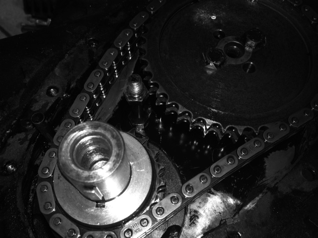

See my pic below. I just did all this. Unless someone replaced your sprockets, each will have a line struck in the metal. The one on the crank sprocket is hard to see because it's on one of the teeth. When those are lined up, you're in the correct place. As Berry says, the cam lobes for valves 7 and 8 must be in balance. You can't see the cam with the head on, so you have to watch the valves, and when one starts to close and other starts to open, simultaneously, that's the point of balance and when you're at TDC "on the compression" stroke. Those marks should line up, and if not, maybe the punch holes will approximate what you see in my pic. You'll note that I marked the tiny punch hole in white. Note also the alignment of the other holes. Again, you can barely see the sprocket score marks.
attachment.php
