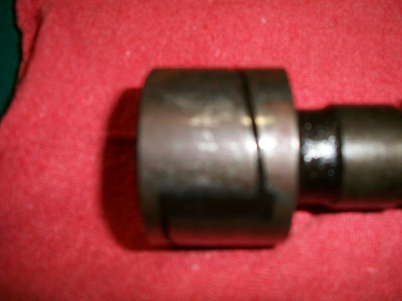

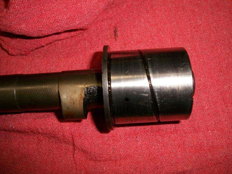

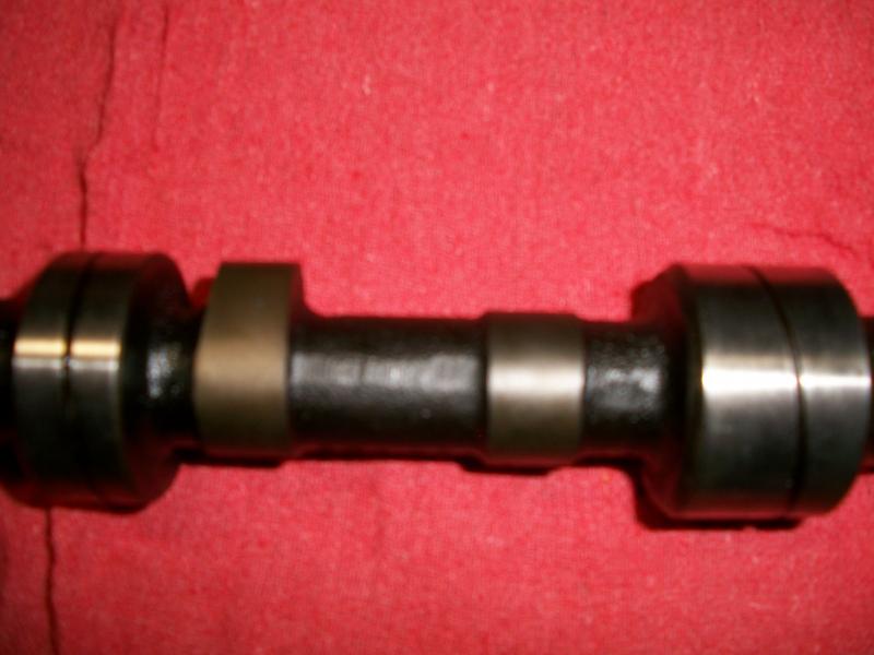

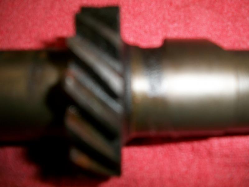

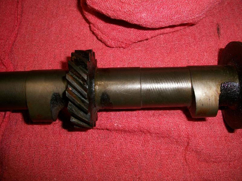

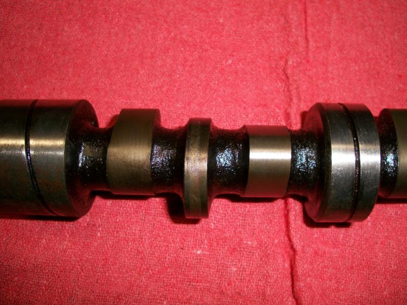

100_1940.jpg100_1942.jpg100_1944.jpg100_1945.jpg100_1946.jpg100_1947.jpg The surface chrome on some of the journals is a bit rusty . I don't know how critical that is? The lobes look alright. In the second pic ,to the right of the gear,it looks a little worn? Opinions?

Your first three pics are still pretty blurry, so I can't say anything about the lobe next to the gear. In the other three, the lobes have a couple tiny spots that might be slight pitting (or might just be spots), but I've used worse.

I would have no problem re-using it. As far as value...anyone with the specs, i.e. lift and duration data, can re-cut one using an old stock cam for about $80. There isn't much money in used cams.
