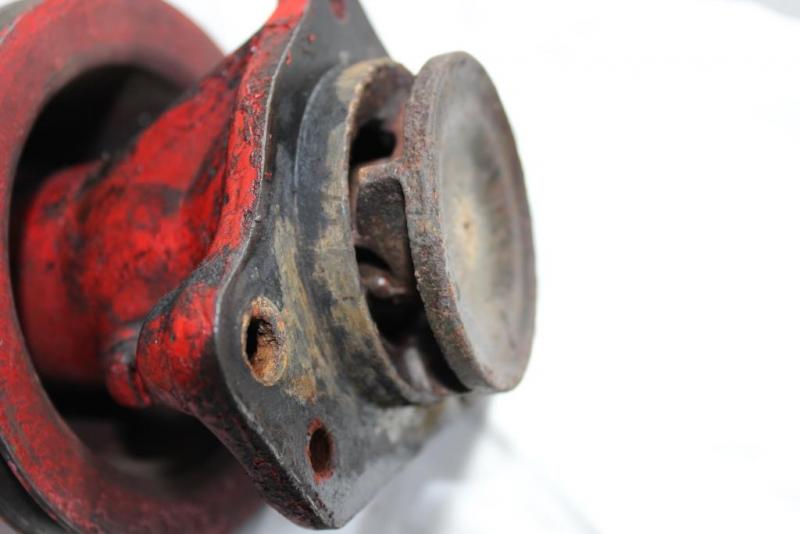

I have had consistent overheating with my BN6 since I bought it. On a hot day 24 degrees C plus and in slow traffic (or prolonged idle) the car heats up to over 195 degrees F plus. I have replaced the old original radiator with a new modern core from AH spares and also fitted an electric Kenlowe fan which has improved the situation but not resolved it completely.
I checked all the other usual suspects of fan blade fitting, ignition timing and carb mixture but all seems fine In desperation I removed the water pump and found what I consider a fairly "large" (by impellor standards) gap between the impellor vane and the body (1.5 mm) as the attached photograph shows. The AH workshop manual does not provide any detail on what the gap should (although for the later AH 3000 pump they advise a gap of 0.5-0.6 mm which is what I would have thought the correct gap to prevent recirculation of water around the pump and ensure efficient pumping.
Before I strip the pump and cost to replace bearings and seals I wondered if other members could advise on their experience with BN6/4 pump impellor vane clearances and if my pump is correctly fitted or requires to be stripped and refitted to a closer clearance (if that is possible)?
steveg
I have a rebuilt pump on the shelf. Just measured that clearance at .025".
You might also consider back-flushing your block.
Also try this: remove the thermostat housing and thermostat, run the engine to operating themp and check your temp gauge against one or two cooking thermometers which can be inserted near the temp pickup. When I did this, my gauge originally displayed around 20 degrees too hot.

Just an observation but if all impellor are the same thickness then closing the clearance to the pump body face will increase it to the block recess. Not sure if this makes any odds to operation. For other cars one can have new impellor made from solid alloy with tighter clearance and more vanes to replace the cast iron ones. There is a school of thought that says these can circulate water too fast for efficient heat transfer.
I agree your car is not too hot ...wise to check gauge accuracy too though.

Thanks for the advice. Still getting use to this high running temp at idle (goes over 200 F some time) but take your point as it seems common with Healey's. I think I will strip the pump anyway and see if I can get a closer gap.
The temperature probe is a new one and when I tested against a lab thermometer before going in it was accurate.
