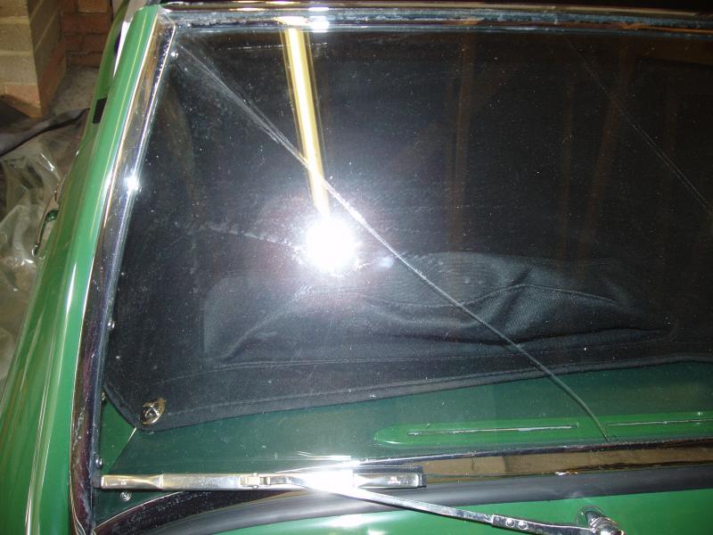

After around 12 months since installation I have a cracked screen, I have ordered a replacement and before I fit it does anyone have any tips, suggestions to prevent this happening again.
Screen is triplex and was installed with new brackets and seals, I made shims for both sides and they are installed 2 left and 2 right, when I purchased the car it didn't have a screen so I have no idea of the original configuration.
Soft top was up and car outside on a wet night.
All suggestions appreciated.
Thank, Graham.

I agree. When refitting my BN4 screen the screen pillar shims ended up with 2 on the off side and 1 on the nearside. I thinks its important not to inadvertently have one pillar leaning back further than the other when they are tightened . It seems to me that this could try to twist the flat screen and lead to such a crack. Mine is apart again at present while the body is refreshed so I may come to regret touching it again if mine too breaks on re-assembly.

Wow, that picture has me worried. I just installed mine and had to put some extra pressure on that corner to get the windshield frame lined up with the pillar. I had shimmed and positioned the pillars after test-fitting the windshield in the frame without the bottom weatherstrip. After installing the weatherstrip, I had to 'persuade' the lower right corner in so that I could attach the frame to the pillar.

derekj, yes the shims between the posts and bulkhead, I fitted the whole windscreen assembly with the bolts into the bulkhead loose, then made shims with slots to fit around the bolts, filled gaps between post and bulkhead both sides of car and then tightened.
Haasad, do you mean by leaning back, leaning toward or away from the body? I'm not sure how wrong shimming would make it lean forward or back.
Bob, the crack does appear to start very close to one of the corner bracket screws, this will be my first check on disassembly.
Jack T, I'm not sure of the dimensions, old screen still fitted and new one should be here tomorrow.

Windscreen replaced, it lasted 2 days then cracked in the same place, hours spent fitting / removing / fitting frame with the cracked glass looking to find where and why it was being stressed. The problem was the rubber on the leading edge of the sidescreen was bumping the pillar forward when the door was closed. Rubber trimmed and screen replaced (2 weeks so far) all looking good.
