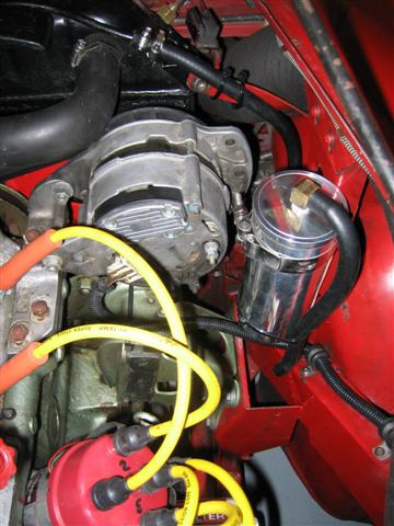

I recently replaced the distributor in my wife's 3000 when I determined that the high-speed miss was related to shaft wobble. I used a Mallory Unlite. Go to the Century Performance website at:
https://www.centuryperformance.com/detail.asp?product_id=MAL-4767801
I also went for the Mallory coil and ignition wires--see attached photo.

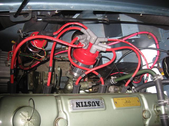

You can get Mallory distributors in either vacuum or non-vacuum advance and with either optical or magnetic trigger--Unilite or Maglite) or of course dual points. I have the Unilite w/vacuum advance on my 100--see the attached photo which shows a bit of the unit.
