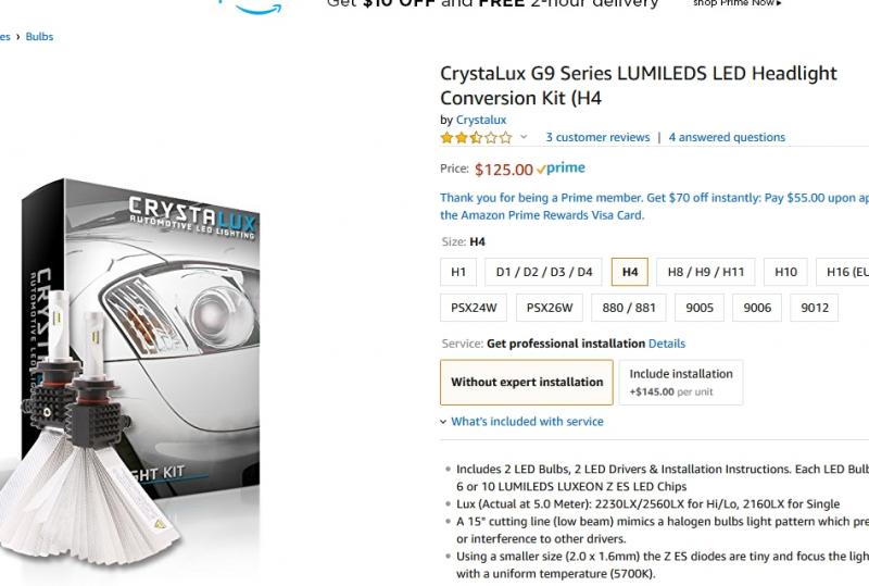

The newest bulbs have ribbons of woven metal hanging out the back instead of fans - will those work?
Those bulbs from Amazon have a couple of pretty negative reviews. Also 'The G9 Series are not offered in a dual beam bulb (which is high/low in 1 bulb).' That would be a deal breaker for me.

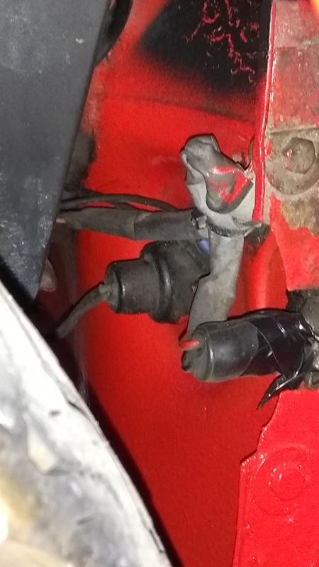

mgtf328
Ok I had a look. My indicators are standard bulbs but the tail/brake and front side lights are LED. The image shows the indicator (closest) and front side light (furthest). As you can see there is no danger of fouling the wheel and it looks to me like a standard rubber boot.

More concerned about the LED headlight bulbs fouling the tires. indicator bulbs not so much.

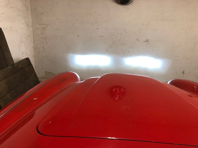

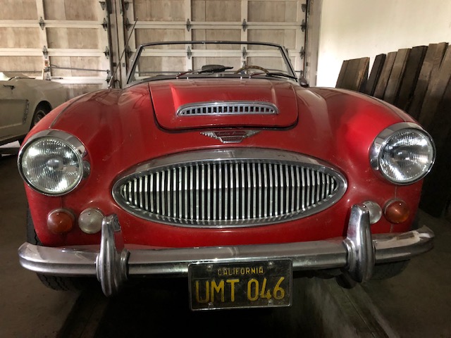

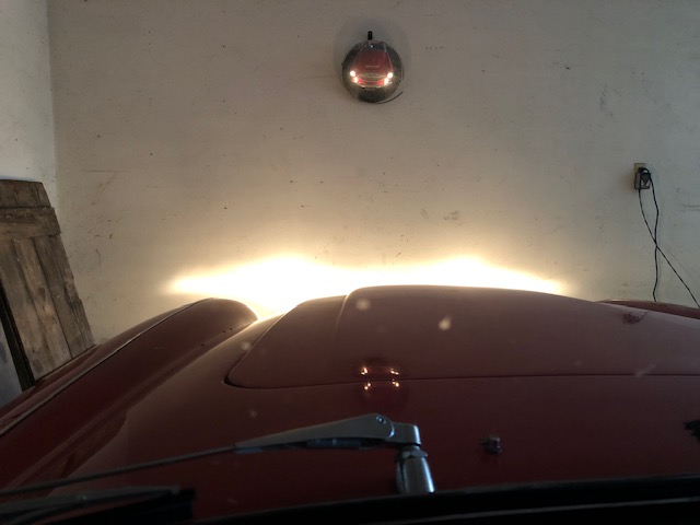

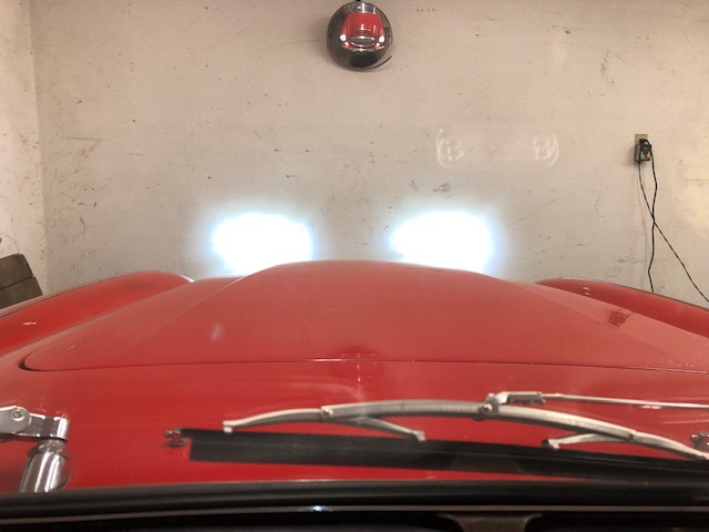

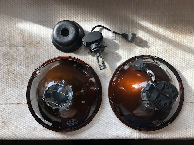

Got the LBCarco 'kit' installed today:
First shot is the 'kit.' The rubber boot is installed by removing the LED 'bulb' from its socket (just like a 1157; one of them was inserted upside down and it took me a while to figure out how to 'fix' it. Almost made a call to Jeff). Second shot is original sealed beams at low beam, third shot is LEDs at low beam, fourth shot is LEDs at high beam, last shot is the LED bulbs and lenses installed. The only thing I'm not entirely comfortable with is the lenses are all but flat, whereas the sealed beams had a significant convex curve, which generally fits with the all-around 'no straight lines' of a Big Healey.
I only had them on for a few minutes at a time but the heat sink was just warm. The photos don't really show the pattern of the lights; at low beam the pattern was like a trapezoid or upside down 'W.' The most concentrated light was fairly straight across the top, with the light diffusing outward and down. Note the car is only 5-6 feet from the wall; I'll adjust later if people start flashing their brights at me :wink-new: Overall, I'm happy with them for the price (about $90 with shipping and tax).
