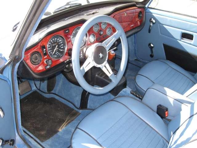

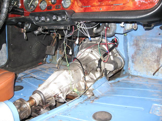

philstr6
I have a borg warner t35 out of a saloon in my dad 74 tr6.I will see if I can find the article that was done on the car
Phil
