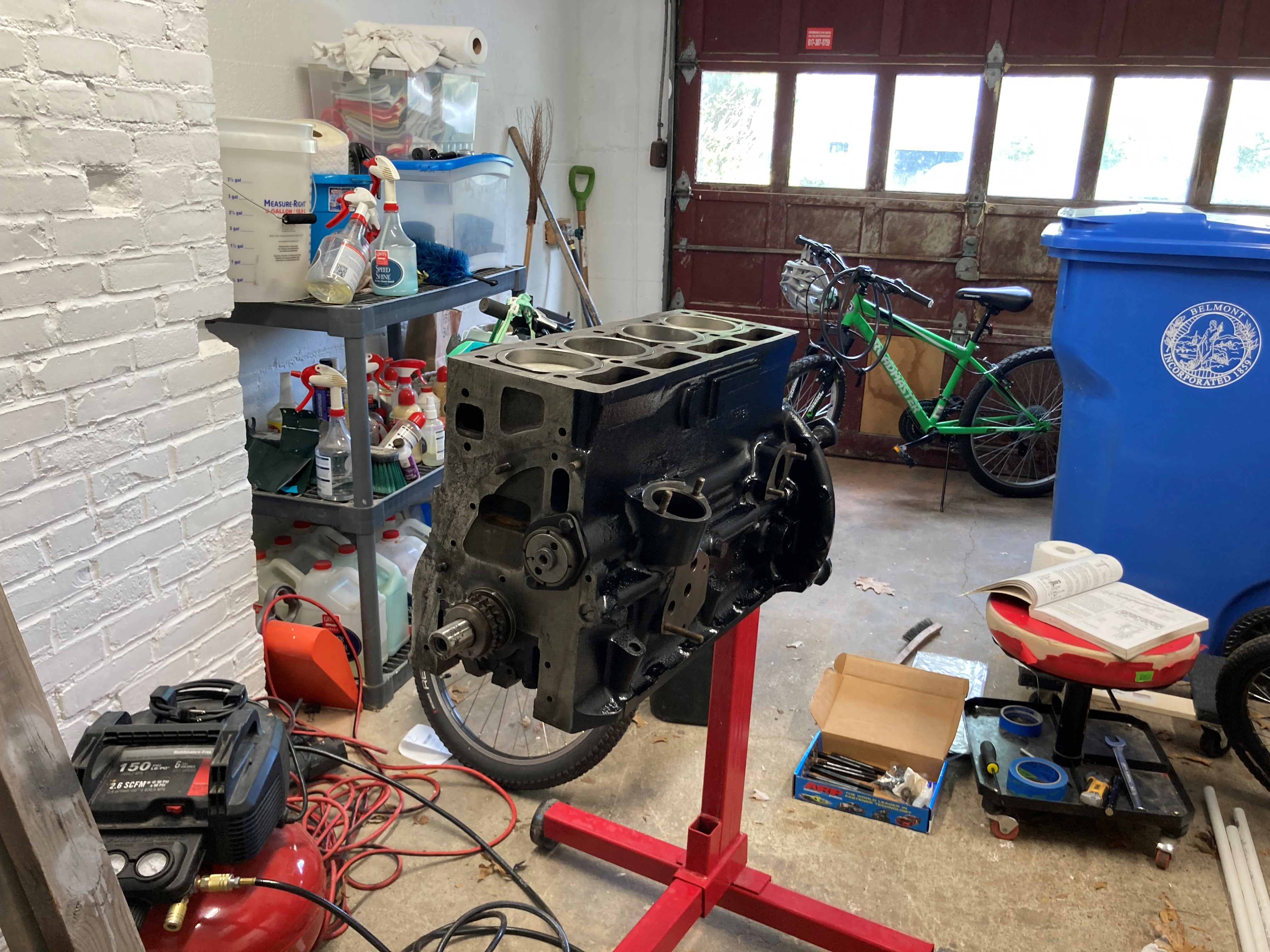

Hello all,
I am embarking on the final assembly of my TR4A engine. Short version of a long story: the engine languished for a few years at my mechanic. The block was rebuilt by an engine shop (liners, pistons, crank bearings, etc. Unfortunately the actual scope is unknown; I called the engine shop and they do not have records). The same shop rebuilt the head. I have full respect for my mechanic, he was open and honest and simply never got to finishing things. I've picked up the bits from him, and plan to complete the assembly on my own.

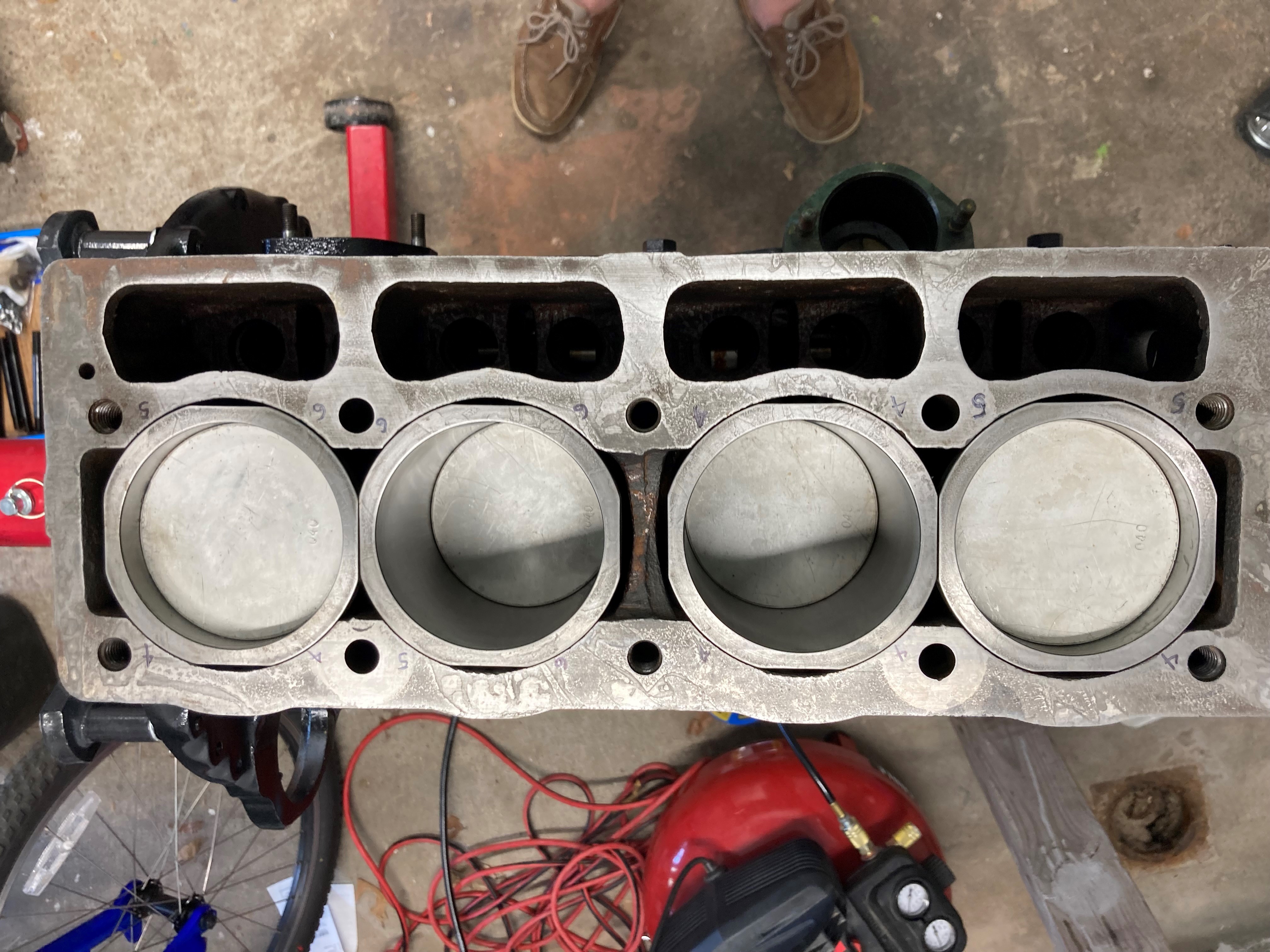

I've checked the cylinder liner protrusion. It seems OK, if on the high side: between 0.004" and 0.0055", measured with a straightedge and feeler gauge. Crank float is right at 0.005", measured with a feeler gauge, pushing the crank left or right with a wooden broom handle.
My general philosophy is an "expert" at an engine rebuild shop did the work so far. Where possible I prefer to leave their work alone. (Recognizing that experts make mistakes, and said experts may not have expertise in TR engines...)
A few questions, as I dig into what I have and what is needed:
1.The rear oil seal appears stock. Is an upgrade to Viton important? (Does this require removing the crankshaft? Triumph engines leak oil... is a better seal like plugging a hole in a dike made of window-screen?)
2. Head gasket. I'm of the opinion that spending money for parts that are hard to access and can have a significant impact is worthwhile. I will shell out near $70 for a head gasket from Rimmer. They have two that seem quite similar: A "composite", > Head Gasket TR2-4A Composite - 89mm - 202775COMP | Rimmer Bros <, and a Payen branded version: > Copper Head Gasket - Payen Type - TR2-4A - 205481PT | Rimmer Bros <. Which is better? (Is this like asking if Mobile or Valvoline make better oil... :smile: ).
3. Machining the flywheel by a machine shop to ensure flatness and balance. Is this important? (I do not want to lighten, as my intent to keep things stock.) The flywheel has some surface corrosion, but looks good. I plan to use fine emery cloth and clean it up before giving it to a machine shop, to better see the condition.
Thanks, and I'll keep folks posted as I progress. Some good u-tube videos and web pages out there on rebuilds!

Mike, I'm more in favor of the second gasket, the copper one. And coat it with the Permatex "Spray-a-Gasket" copper spray. Not a fan of the "new, improved" composite ones.
Something I notice in the pix, looks as if the block's mating surface to the head has some discoloration from having been covered with a plastic and possibly grease? Clean it with acetone or lacquer thinner on rags to remove ANY contaminants. Same with head's mating surface. Another thing is the front cover gasket areas; they look as if the block had not been well cleaned/prepped before the rest of the work was done. Can't be sure though, just from the images.
And "pin" the liners in place with suitable washers and bolts before moving the crank to TDC (or at all!).
Just a couple of my humble opinions from observation of what you've got there.

Thank you both.
I'll look into the oil seal. I will clean the surfaces with Acetone - it was covered with plastic for quite some time. Fortunately there does not seem to be corrosion on critical surfaces. The surfaces "feel" OK (gently running a fingernail does not reveal any bumps), but I agree, they look terrible.
Thanks for the tip on the pinning - I have bolts and large washers in place now. I took the photo right after I test-fitted the head / studs in place. Turns out the ARP kit has two incorrect studs: Should be 5-5/8, but the kit provides two 5-1/2 instead.

1. Your cylinder protrusions look good to me. You can't measure to half a mil with a feeler gauge anyway, and, frankly, I don't think you can measure better than a mil or two with a feeler gauge and straightedge. I always used a depth micrometer.

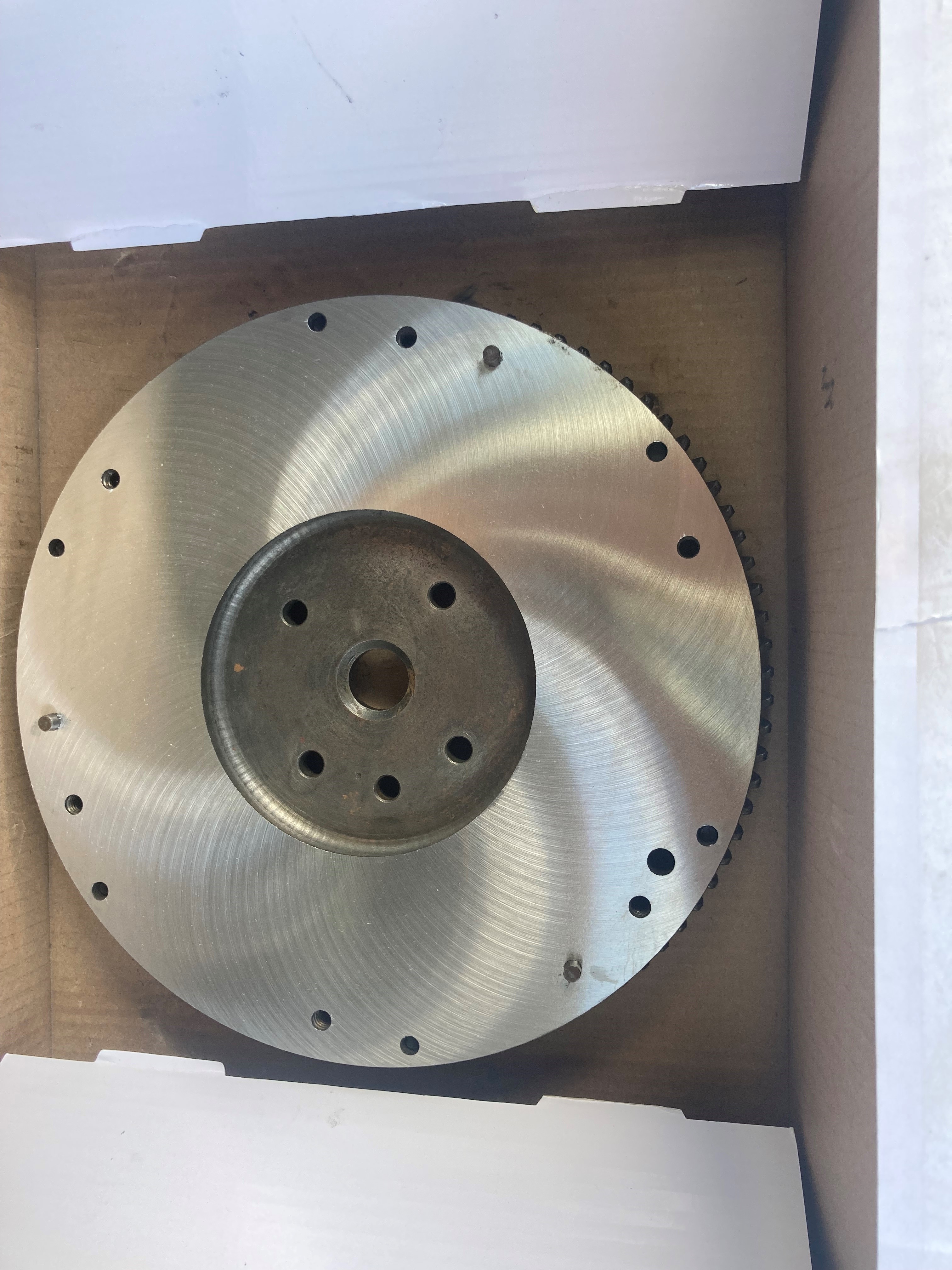

I love shiny parts! Got the flywheel surfaced over lunch today.

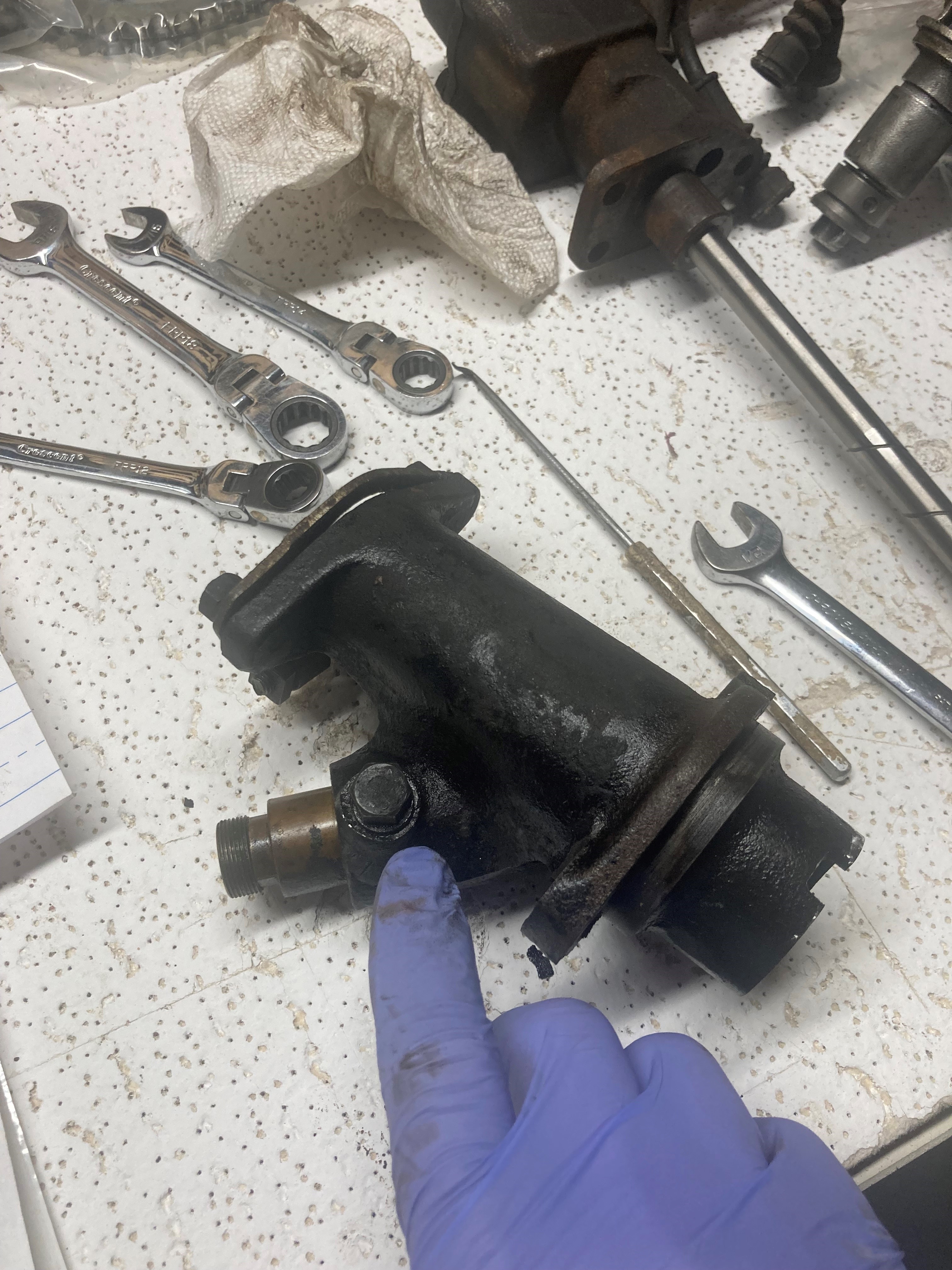

Also: On the distributor pedestal, is it worth replacing the shaft oil seal? How hard is it to remove the shaft itself? Remove the setscrew and pull hard enough (gently), or is heat required? (I assume the setscrew is there to keep the shaft in place. Making it loose / tight does not change the slight play in the tachometer drive shaft.)

If you remove the distributor shaft, keep a lookout for the little woodruff key hiding down there in the dark. If it falls out and doesn’t make it into the sump, it could prevent the distributor (or shaft - I’ve blocked that day of frustration from my memory) from seating all the way. If you do knock one or few off and into the sump putting it back together, the autozone assortment pack has the correct size, so you can continue your enjoyment unabated.

Super progress, Mike! Flywheel looks a beauty.
