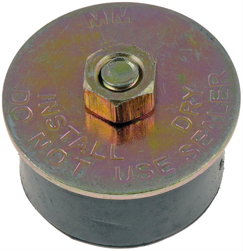

Yes, it is going to be difficult to put a freeze plug with the engine in the car, at least with the standard metal core plugs. You could try something like this:

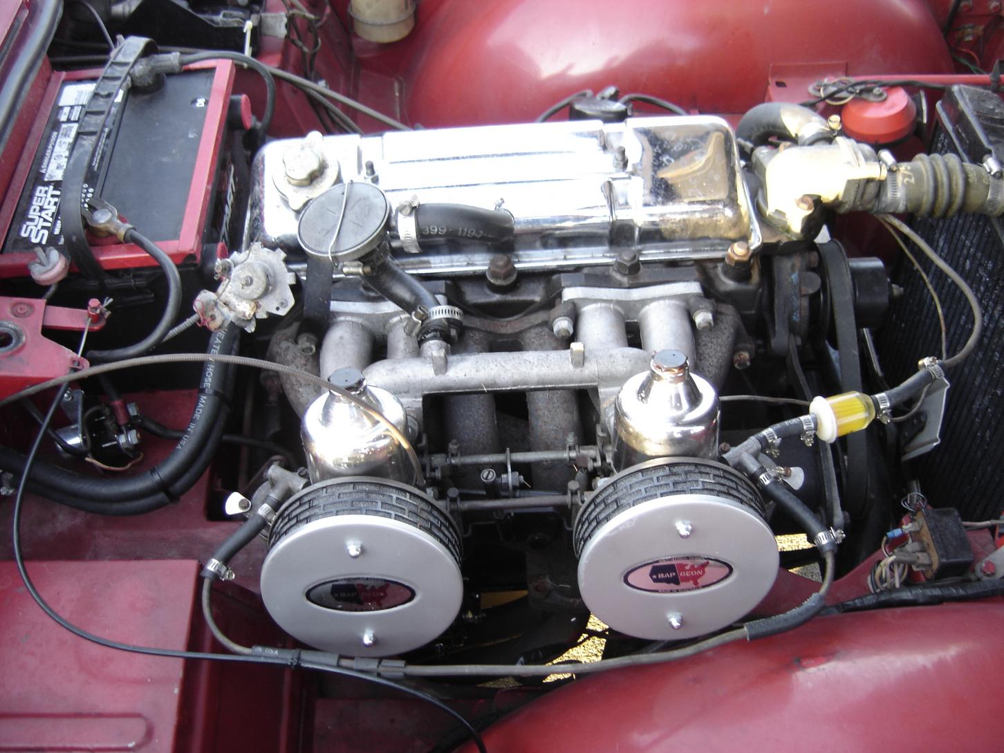

My '63 TR4 had a road draft tube but was spilling oil out onto the frame and the road. So I installed an electric fuel pump, removed the road draft tube and carefully tapped in a plug, obtained a fuel pump blanking plate and drilled it to accept a hose end, routed a hose to an oil catch can, routed a hose from the catch can to the air cleaners, obtained a TR4A valve cover and vented its tube through a small filter. The car now does not leak oil because the crankcase pressure is being relieved.DSCF8163.jpg

My first TR4A had the PCV removed and a TR4 valve cover and oil fill cap installed so I completed the process and installed the road draft tube (and replaced the intake manifold with a late TR4 one without the tap for the PCV just for looks).
Do you have a picture of what you have in the area of the valve cover and carbs?
Scott
Scott
Yes, there's a picture in a previous post in this thread.
