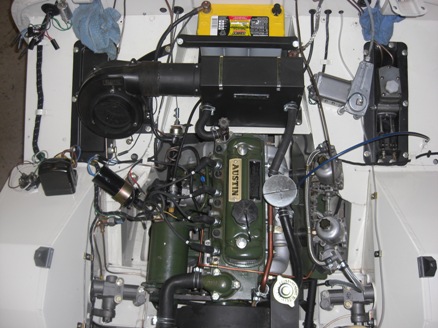

That is the arrangement I have on my 1275. See below. I did not dial anything in and the no restrictors were put in the lines. I have not followed your posts, but did you rebuild your engine? It may take some time to seat the rings, which would also push the oil out the exhaust.

My set-up looks identical to the photo.
