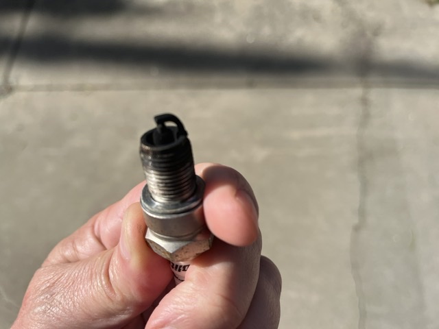

And on a related note…all my plugs look good except for this one. It’s the second from the front of the engine and has strong carbon build-up covering everything including the white porcelain.
What is this spark plug telling me is wrong? Not getting good combustion to burn it off I imagine. But what would need to be done to figure out why?

Have valves been recently adjusted? How's compression in all cylinders?

With one fouled plug, short of a poor electrical connection to it, I'd suspect a valve first.

Yep... that's basically it.

Next step - clean that dirty plug, then drive for a couple hours. Check the plug again and see if it's still getting the carbon buildup.

I replaced all the plugs earlier. But I can certainly pull that one later and take a look. Thanks!

If still a problem, then you may have a sticky valve.
