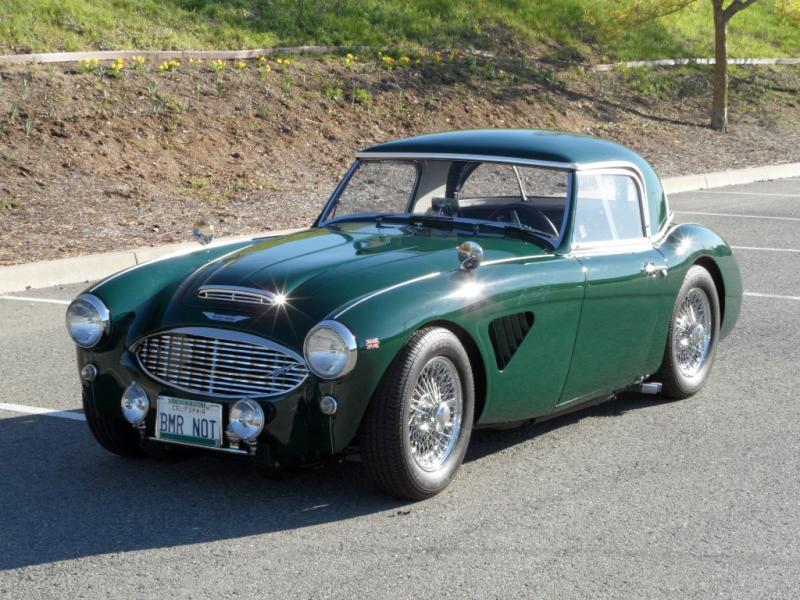

Here's the upgrades I have done to my '57 100/6 (BN4). It came with a 3000 engine, but everything would apply to the 2.6L.
Performance:
  • Denis Welch fast road aluminum head with compression set for 91 octane (US)
  • Denis Welch DW8 cam & tappets. This requires pockets in the top of the block for valve clearance.
  • Denis Welch aluminum oil pan
  • Oil cooler
  • BJ8 intake manifold with two HD8 SU carbs
  • Crane electronic ignition
  • Recored radiator (an aluminum radiator would probably be less expensive now)
  • Rally vents to exit hot air
  • Exhaust headers
  • Side exit exhaust
  • Disc brakes all around with separate front & rear circuits (Nissan 1200 tandem master cylinder, Girling 16PE in front and Jaguar in rear. If you do this, ask Steve about how to make the parking brake work again.)
  • Move overdrive switch to gearshift knob. (Put headlight dip switch in place of old overdrive switch and put dead pedal in place of old dip switch.)
Handling:
  • Lowered front by ~3/4"
  • Denis Welch front heavier anti-sway bar, 7/8" IIRC
  • Polyurethane bushings for the anti-sway bar links
  • Fabricated anti-sway bar links using grade 8 bolts and 1/8" pipe. The heavier anti-sway bar will snap the stock links.
  • Adjustable camber top kingpin bushings. Camber is now -1.5 deg.
  • Anti-tramp bars at the rear
  • New stock rear springs (old ones were sagging)
  • Polyurethane bushings for the Panhard rod
  • Dayton 72-spoke wire wheels with 195/65R-15 tires
