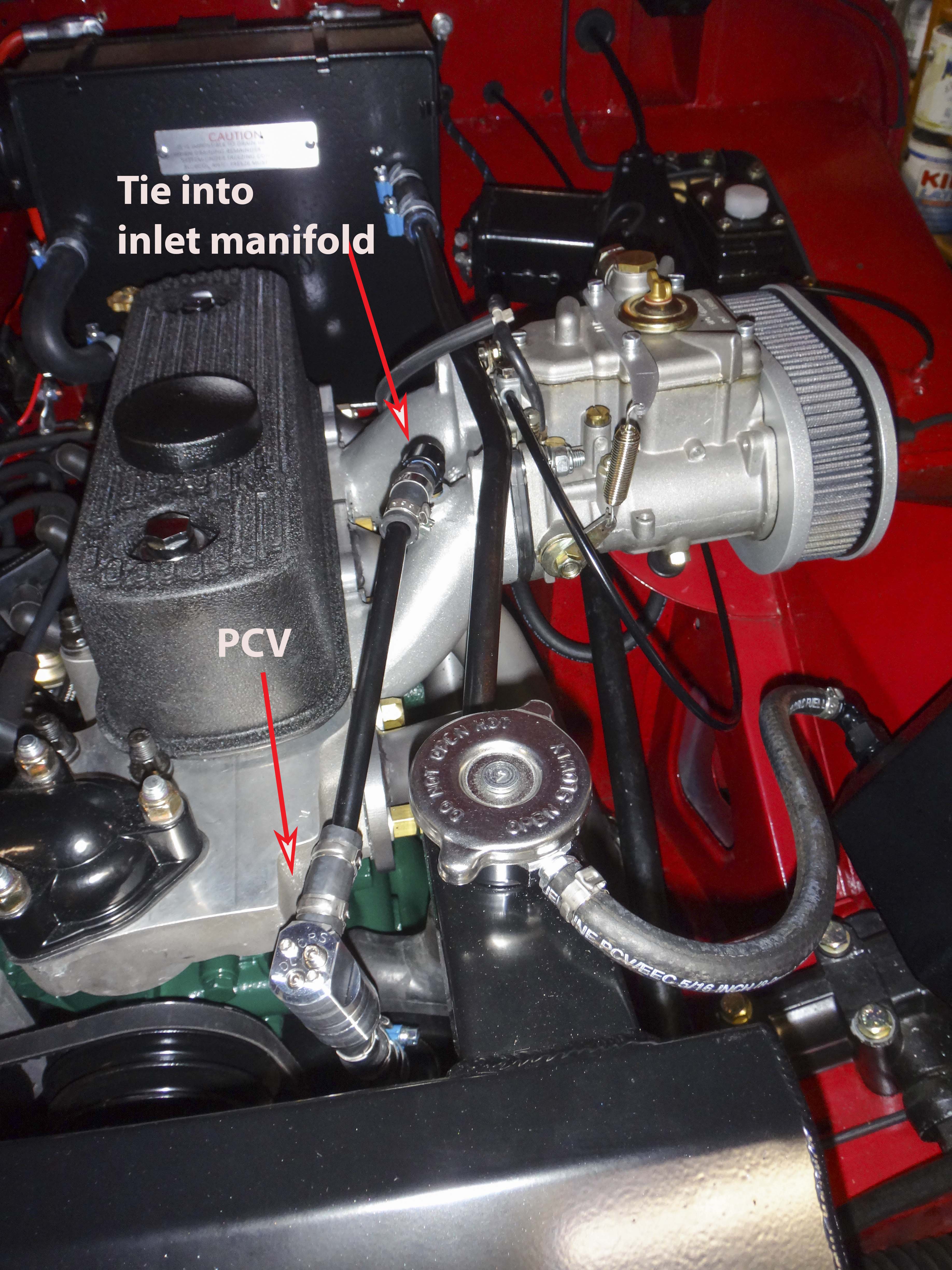

It turns out there is an outfit that makes adjustable PCV valves - M/E Wagner. OK - they ain't cheap. > M/E Wagner Performance Products – High Performance Crankcase Ventilation Systems <
But. Ain't there always a but? NTL, they work. Background. We have several cars with V8's. One, a Roush 427, had a nasty habit of popping the dipstick out at odd moments - because of pressure buildup in the crankcase. And venting out of the rocker cover vent, even though there was a "correct" PCV installed. Oh, and of course, a few more oil leaks than I wanted. I installed one of Wagner's adjustable PCV's, went through the pretty easy set-up, and wow. All better. As in wowser.

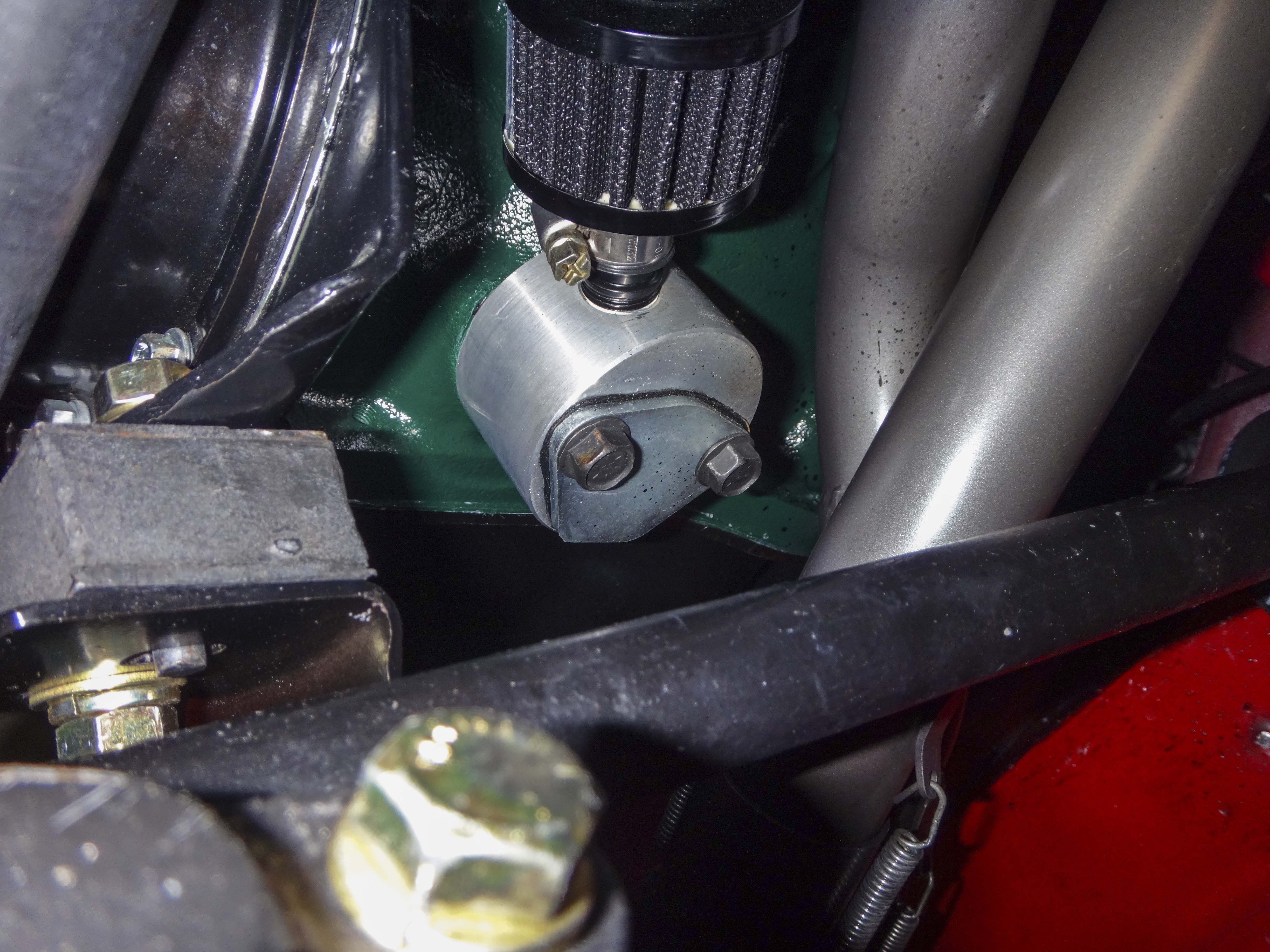

So, as I finished up the restomod on our '60 bugeye I figured it needed a good PCV as well. I installed the Wagner just above the oil separator, with the discharge of the PCV going to the inlet manifold.

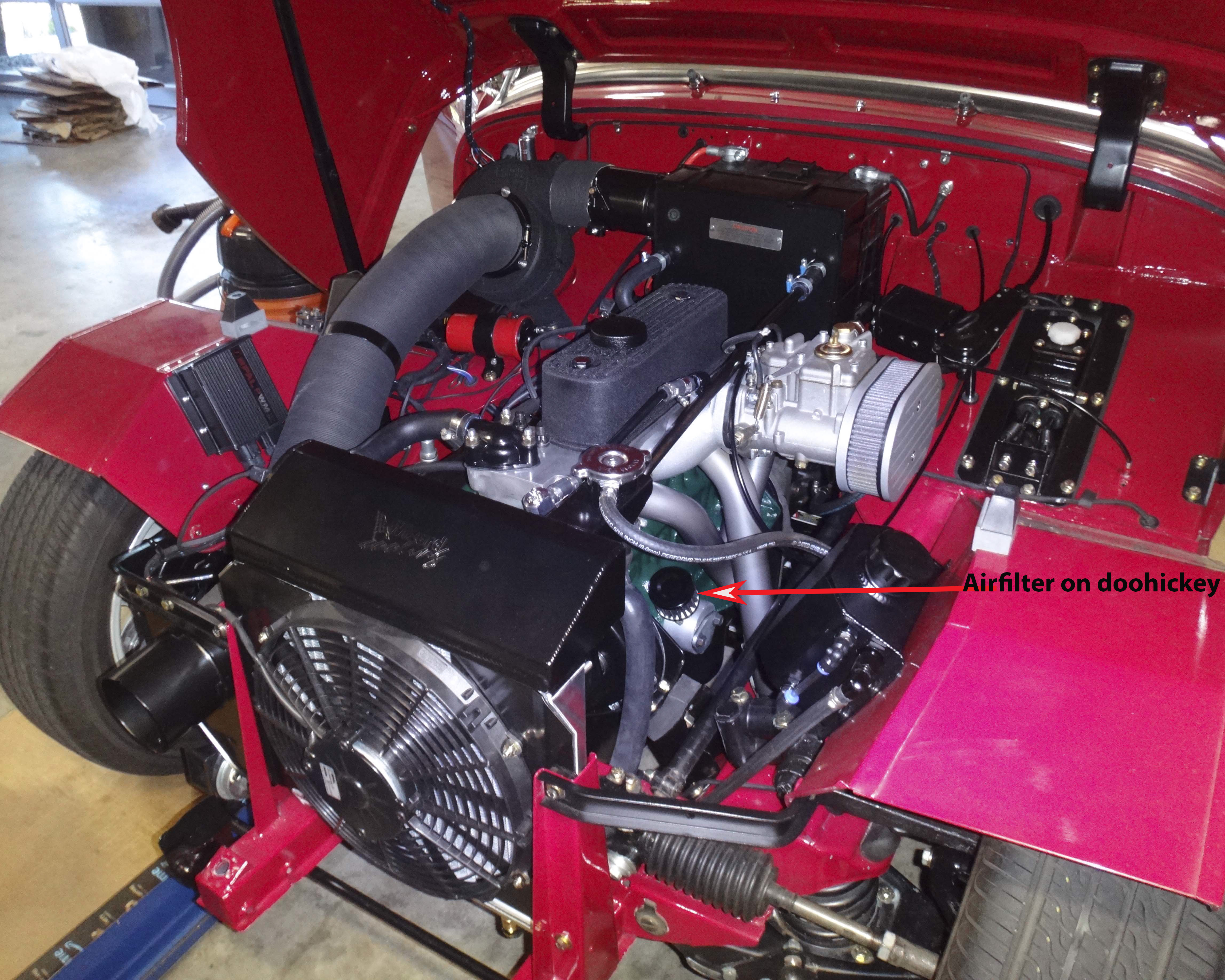

I also installed a filter on the doohickey that MiniMania installed on the side of the crankcase on the 1380 they built for us. The doohickey is a round oil/air separator installed where the fuel pump would otherwise mount. Looked like a good place to draw fresh air into the crankcase for the PCV...
I asked MiniMania what the doohickey was for, but they didn't respond.
NTL - there you have it. I just got this little bugger running and now am waiting for good weather to test everything out. I hope this helps at least a little.

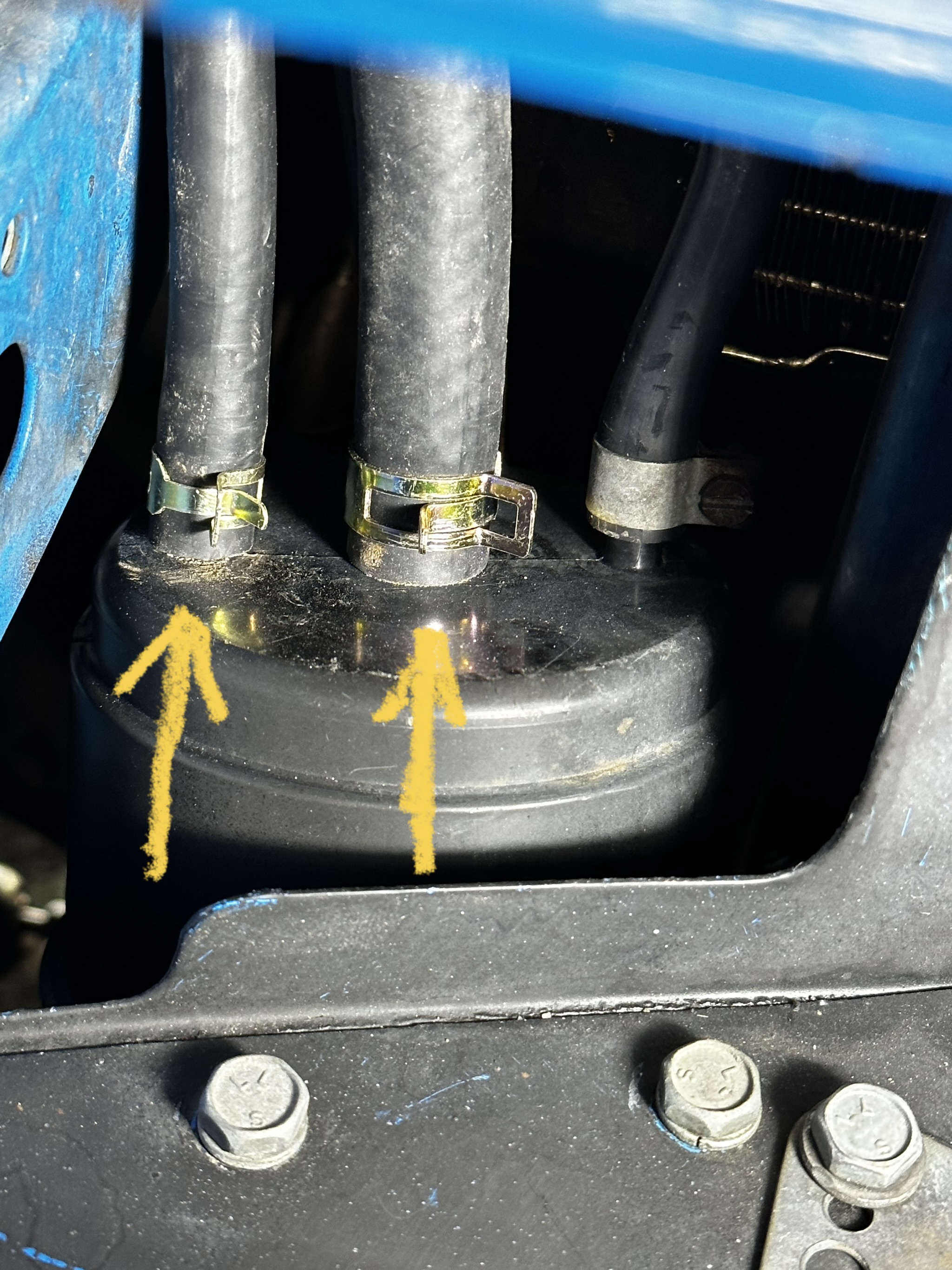

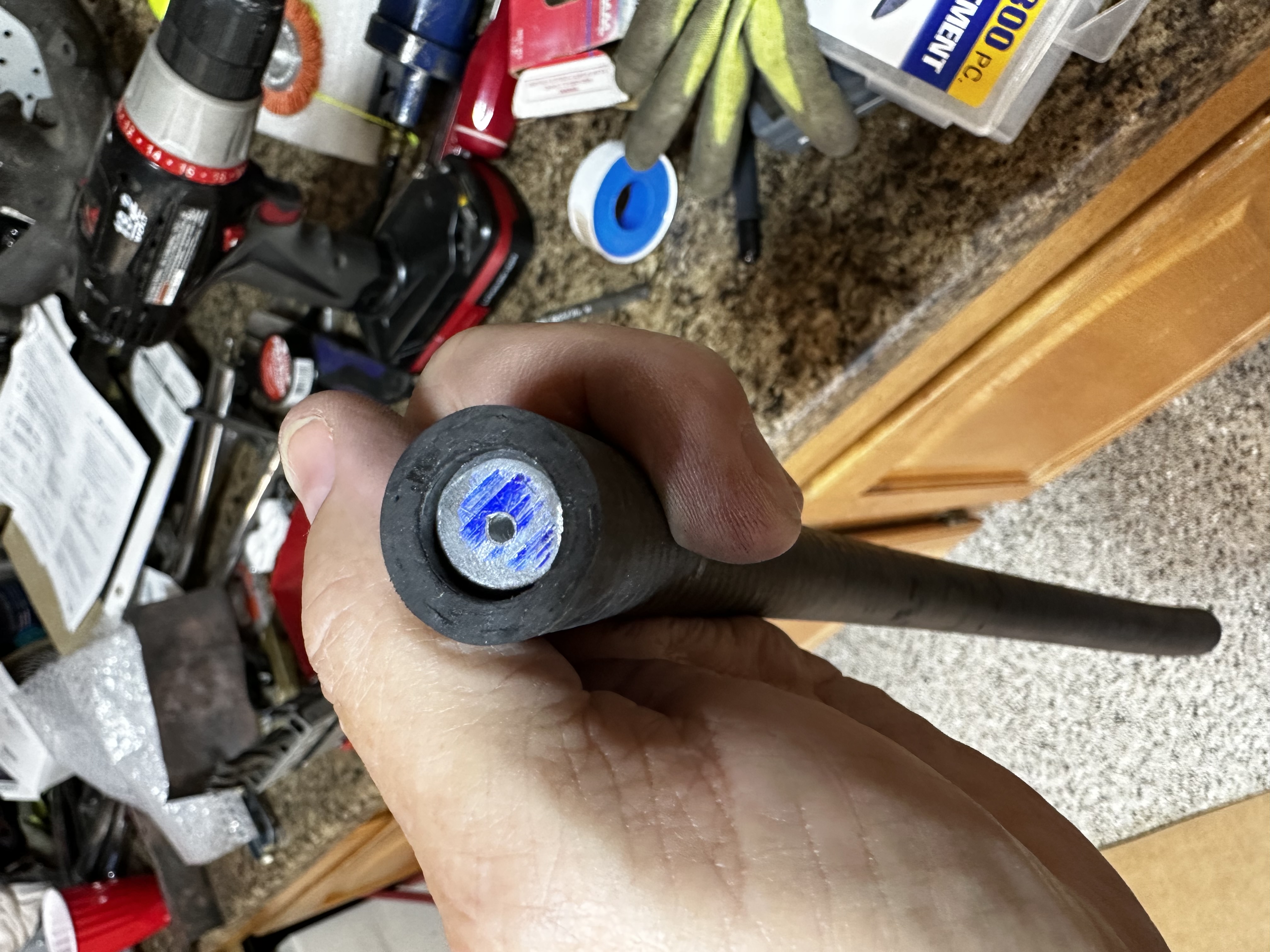

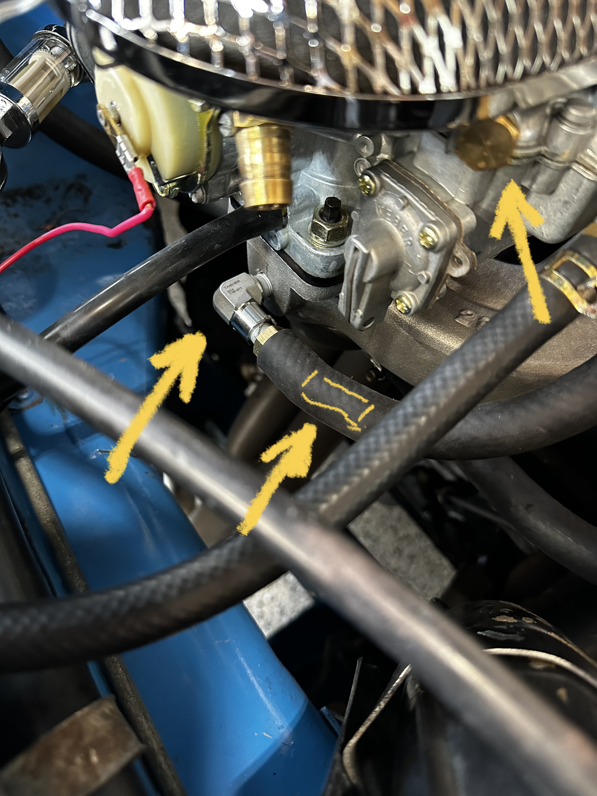

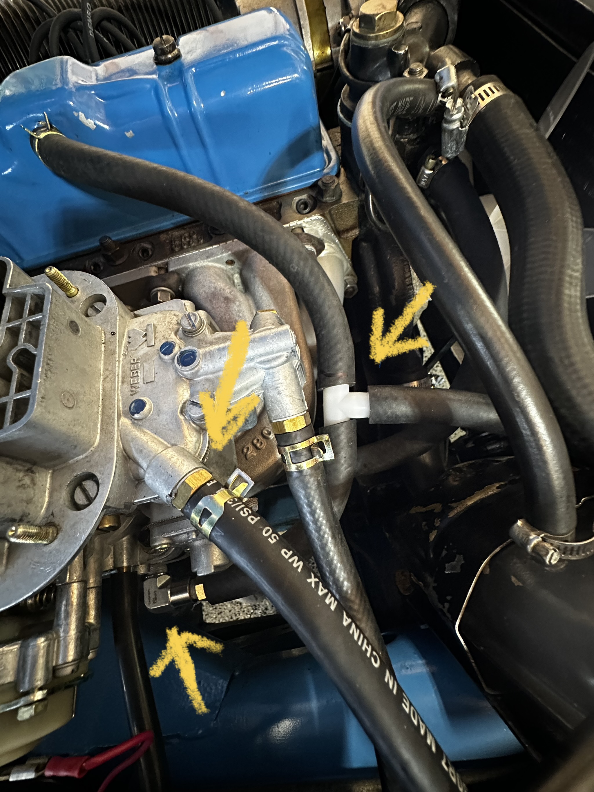

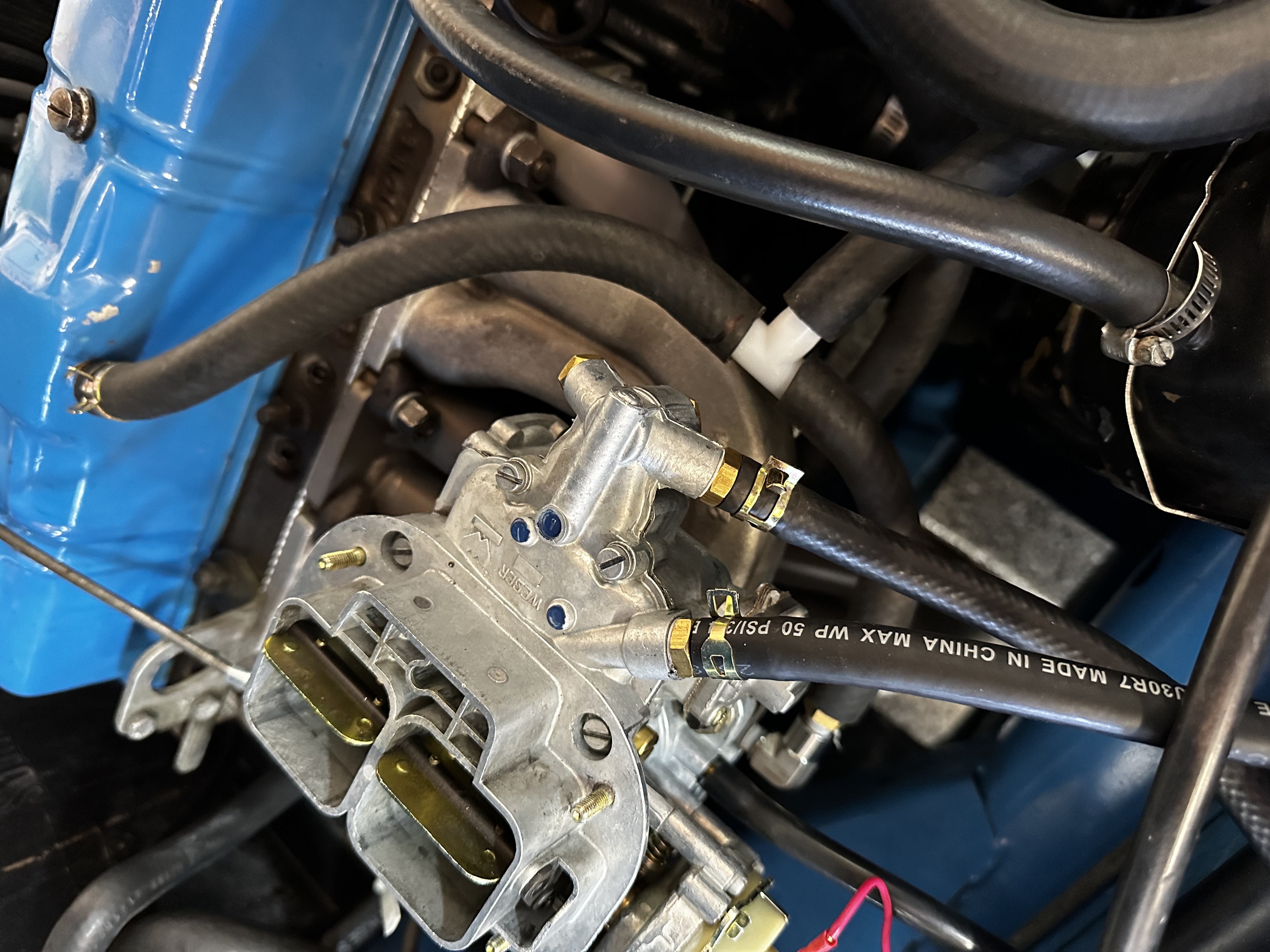

I put a 1/2” T in the hose from the valve cover. Run a new section of 1/2” hose off the T to the charcoal canister. Drill and tap a 1/8npt just below the carb in the intake manifold. This will ensure equal mixture goes to all cylinders. Add a 90 degree 1/8npt to 1/8npt at the manifold, then attach a 1/8npt to 1/2” barb fitting. Now cut an inch or so of 1/2” aluminum rod and drill a 5/64” hole through the center. Push that into the 1/2” hose that will connect to the new barb nearest the intake manifold. This will ensure both the crankcase and canister is properly vented into the intake. If you have the fuel bowl vent fitting add a fitting to the Weber and run a hose to the canister. After this mod you’ll address all your oil leaks and fuel smell. If you have oil leaks after this, then replace the gaskets or seals. I‘ve been running this setup for about 1800 miles and works perfectly on my 1500 with a Weber 38.
edit: apparently I can not post photos. Sorry.
mrodtn
This sounds promising. Considering doing this to my 1979 MG Midget 1500. I am running a Weber dgv 36/38 venting the valve cover port to the underside of the carb via the supplied elbow from the Weber carb kit. The alloy valve cover has a vented cap.
I currently have the mini mania mechanical fuel pump baffle vented to a catch can then to the charcoal canister. At idle if I disconnect the line coming from the catch can there is pressure and small amount of smoke coming out of that line.
I saw in the John Twist video where he had plumbed the valve cover vent to the side of the Weber air filter. I wonder what adapter he used for this.
dave99

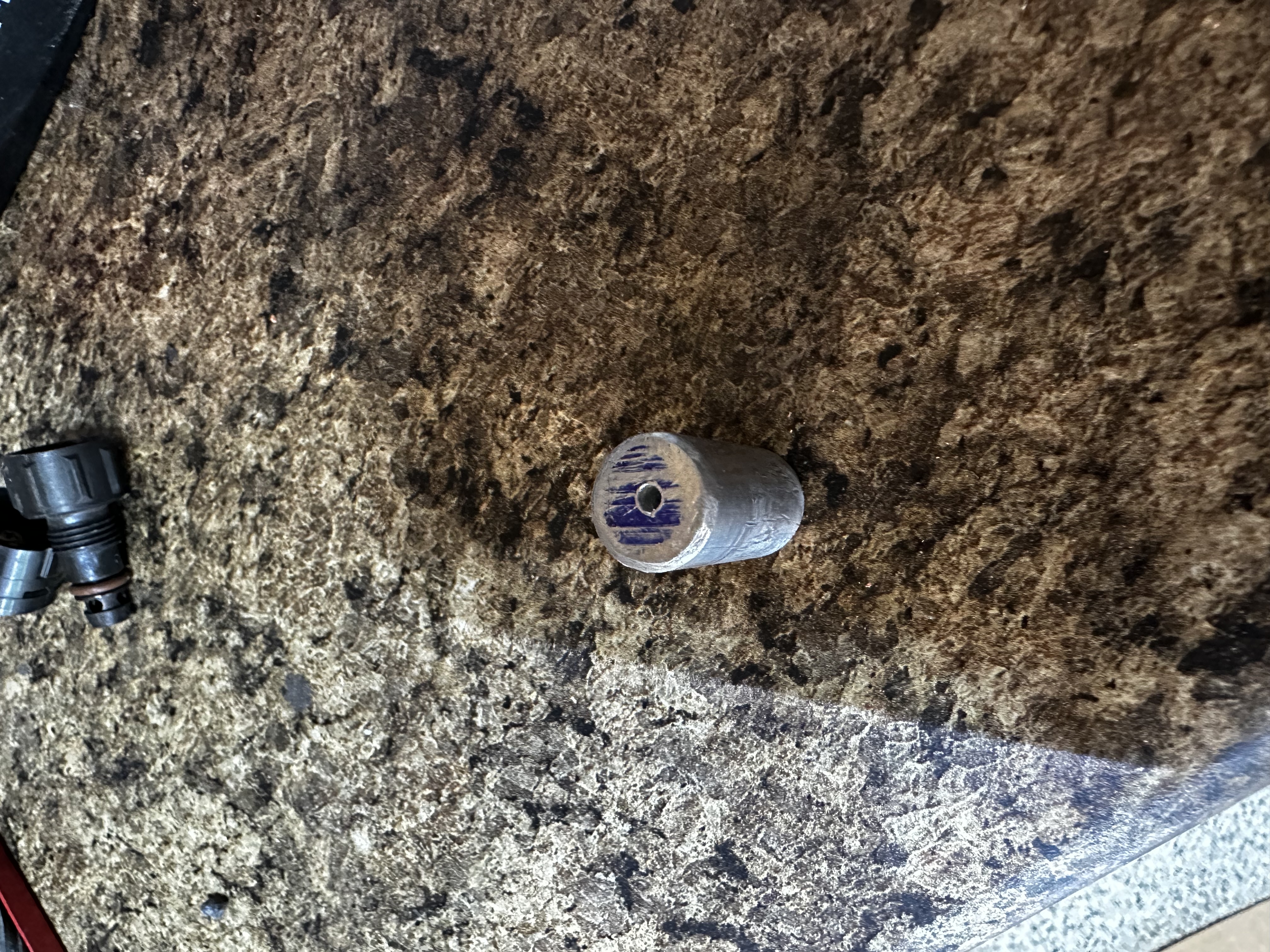

Ahh, I can upload photos. Here you go…. Just a tip, if you go larger than 5/64” in the aluminum rod you risk drawing to much air from the crankcase and this will affect your mixture and rpm response. Driving 40mph and taking your foot off the pedal takes the rpm forever to drop down If the hole is too large. So keep the hole as small as possible. I had a 3 foot section of aluminum rod and tried different hole sizes. The 5/64” worked best for the Weber 38. Have fun.
