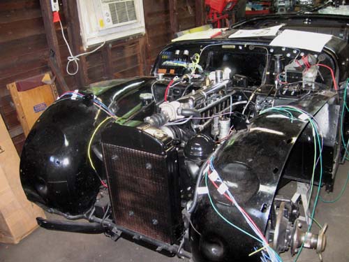

martx-5
I actually waited until shortly after I had taken this picture. I still had the nose off the car and the tranny tunnel wasn't in, so if I did have to pull the engine and trans, it would have been fairly easy.
