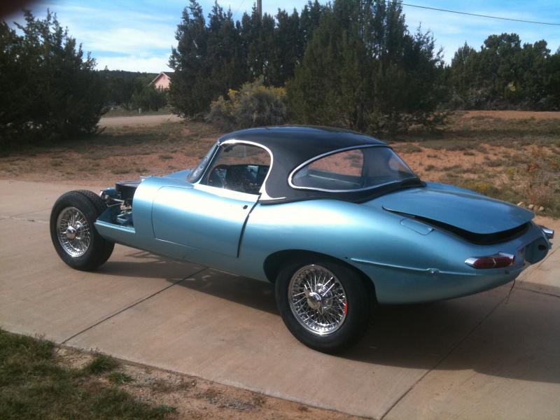

I personally like the looks and handling of the original 'skinny' tires:
One thing I'll note. At one point I had 205s on my series 1. Mostly wasn't a problem but I found that if I hit a bump or otherwise cause the suspension to flex while turning the front tires could grab at the back of the wheel well and bend the sheet metal. This was in the back of the well on the side I was turning towards. So in some circumstances wider in the front was an issue, never a problem in the back.
