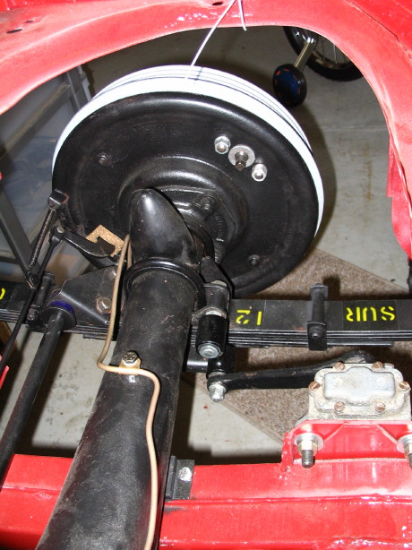

Johnny
[ QUOTE ]
I found a few P clips that are brass. One of them is the OD harness to gearbox clip which is a special size.
[/ QUOTE ]
I found two brass clips above the rear axle used to mount the brake lines.
See photo attached;
