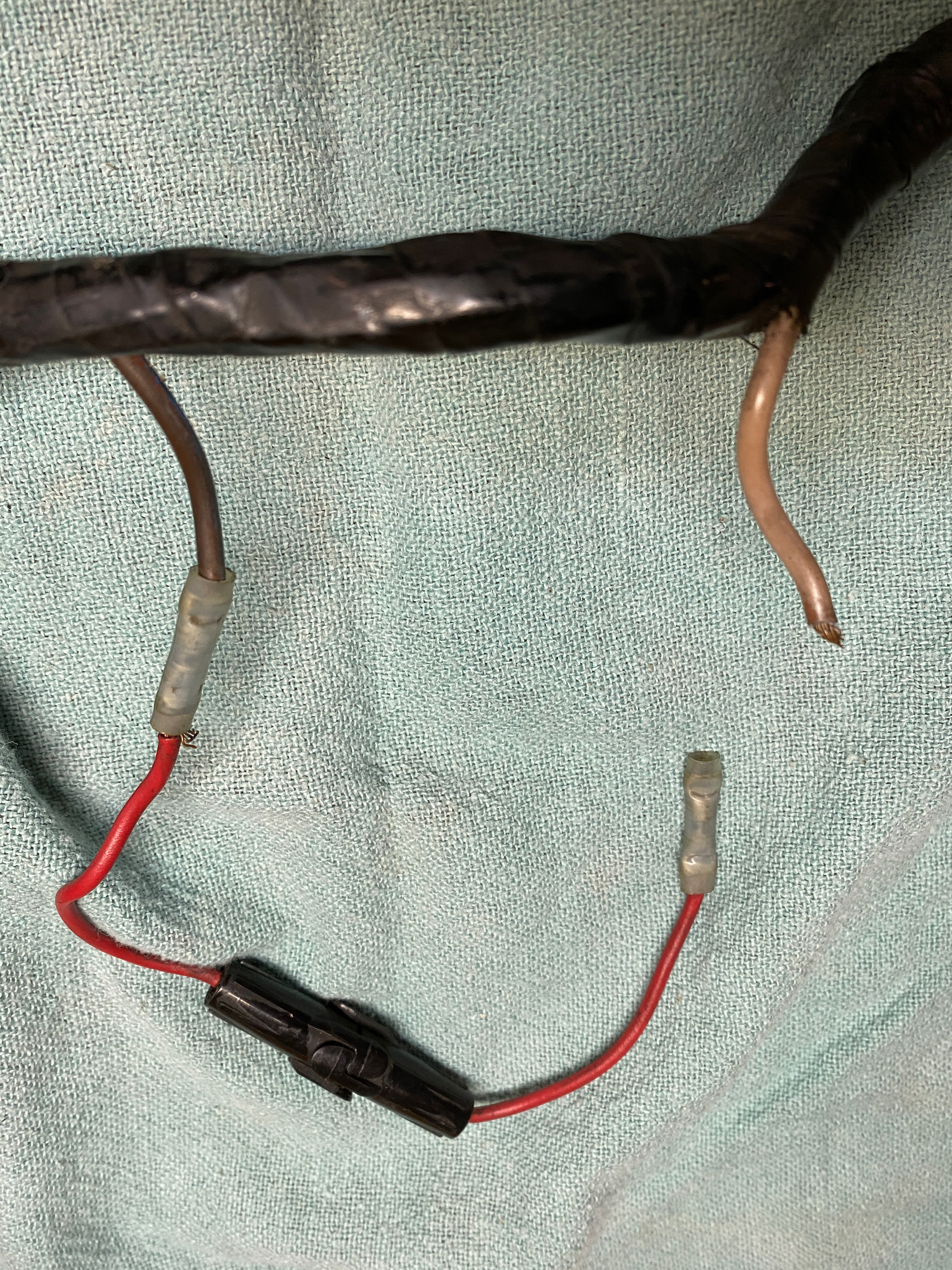

This is the headlight wire (brown/blue) and obviously had a fuse added for what purpose I don't know. But the wire that attaches to the other end of the fuse is white (pinkish/white). Why would that be? Bruce

Sarastro
Yeah, there's no limit to the weird things that POs do, and if you try to figure out what they were thinking, you'll probably go nuts. Best just to set things up the way you want it, return it to stock or make sensible modifications (say, more fuses and relays) and not worry about it beyond that.
