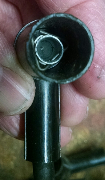

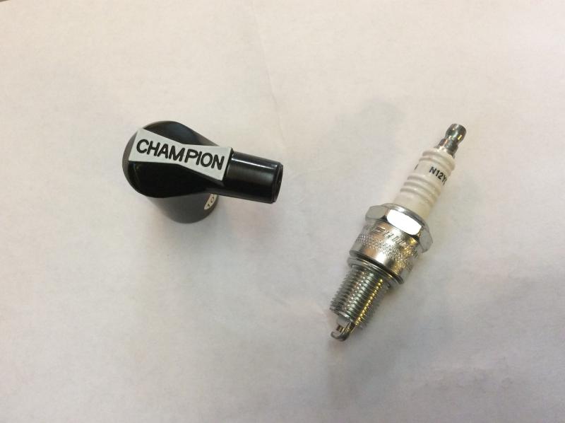

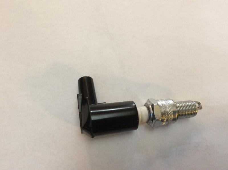

I bought these caps from a vendor in the UK, one of the well known suppliers. When the caps arrived, I placed them on some Champion plugs. They do seem to “click” onto the top of the plug, but once in place they wiggle. The fit is a little loose.
I asked the vendor, and they stated theat the caps should work fine and are the right spec for an Austin Healey 3000. I have generally had good experience with this vendor in the past.
I have seen these caps on other cars at car shows. As can be seen, I use the recommended Champion plug.
I am curious if anyone else has had an experience with them. I have not installed them yet. I would like to use them, but not if it compromises the cars reliability.
I would appreciate any feedback. As always, thanks so much.

I have them on mine and I agree that once in place they are a loose fit but don't come off without a tug and have never been a problem. I wouldn't worry.

I use Bosh plug caps and they do not wiggle and work a treat.

I once bought a set of 'bumble bee' wires with caps already attached, from one the UK major suppliers. The caps seemed too hard and plasticky and never fit as well as I thought they should. I removed them and now use NGK caps and plugs.

I wouldn’t assume they are genuine simply because they have Champion written on them. Like Lucas parts many are Chinese copies of variable quality.

Actually one of my concerns is that, even though they have the “Champion” name ... were they really manufactured by Champion?..... or a knock-off with the vintage look.
I appreciate all the feed back, and glad this spurred some conversation. I have to say that I like the way that they look, but not too convinced that it is acceptable to have loose fitting spark plug caps from a performance/reliability standpoint.

You already own them. Why not install them? You can test each wire with a timing light and see if it has a miss.
FWIW, Champion plugs are the plug of choice for aircraft piston engines (engine performance is a matter of some concern in aircraft). Champion oil filters are widely used as well.

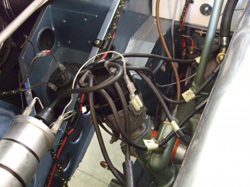

I have found that any of the hard plastic or bakalite plug caps do wobble after they have clipped on the plug. I have found no loss of performance due to that on a street driven engine. But one issue of the open hard caps is that they certainly are not water or moisture proof. When I was on tour this past summer in the Smoky Mountains I found that each morning after a bit of a night time shower, the Healey started and idled fine but sputtered around awhile till everything warmed up and dried off. I am still using the original style Lucas hard caps. No water proofness here.
