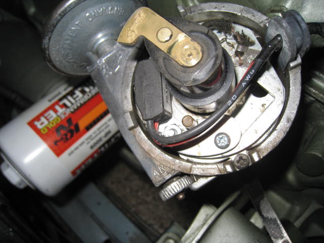

I'm negative ground, pertronix, lucas sports coil.
Champion plugs are gapped at .035
Lin
Roger, I am happy to learn that we use the same oil filter and have the same plug gap, but I don't have one of those frayed wires in my distributor: very un-Roger-like!
Just kidding Roger!
Lin
John Turney
Roger,
I, too, can't believe you have a frayed wire on your car! I also wonder about those wear marks on the top of your rotor; there should only be the one point where the carbon center post presses on the rotor. It looks like something else is rubbing.
