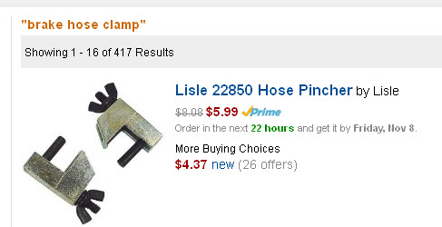

You can use one of these to pinch the flex hose so the fluid doesn't leak out when you're doing the repair. You can also seal the vent in the reservoir cap with tape. That way you don't have to remove the fluid.
Update: a kitchen basting bulb-syringe is an inexpensive way to remove the fluid from the reservoirs.
I agree with Steve. Unless you want to also change out all the brake fluid, you should not lose that much when replacing a wheel cylinder. It does not take long to bleed the air out of the system. Even though it might not be necessary, I might bleed the brakes at all four wheels after working on the system in order to get any air out.
