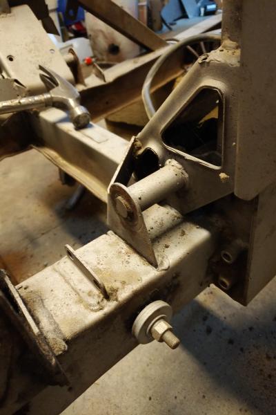

I am finally starting to get back to this project and this weekend I hauled out the frame to get a look at it and get it ready so I could start thinking about connecting the front and back clips... anyway, I noticed another shortcut one of the POs made. Not only did they cut every bolt they could find, but they also cleanly cut off the pins or whatever they are called that the lower control arms mount to. Are heat and patience the only solution here or, since I will likely modify slightly the suspension to this '56 anyway, is there a work around using a tr6 hanger or something?
Cheers,
kerry

Bummer. The through pin is available from the big three. Getting that old one out may be a job, though. I suspect it is tack welded somewhere near the center.
TomMull
Considering that the parts suppliers carry that pin, we might assume that replacement is possible and that someone has done it. As John says, there are two gussets on the inside that are not easily accessible so a plan for repair is not obvious to me. However, you have little to loose at this point.
Certainly a shame. Some people should not own a sawsall.
Tom

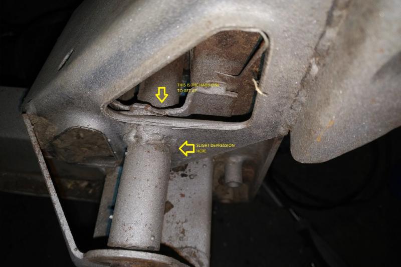

I am hopeful that there isn't a spot weld in there, I checked and couldn't see a crimp in the metal or anything.
My plan currently is to heat in two or three points and hope for the best - I was hoping there was a rubber sleeve that I could melt out, but no luck there. A short attempt with a puller and later a five pound sledge didn't budge it. If need be, I can get a grinder in to cut two of the three weld points but would then have to drill for a long time with many, many bits to get the third to release... and then repair all the metal around it for strength... ugh

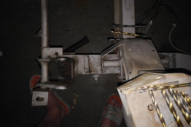

Can clear an inch in 30 minutes - but that is from the easy to access rear - there are mounts that are in the way of the drill on the front so that will be a challenge for another day. Will restock on bits for the weekend and give it another go then. By the way, for others doing this, don't drill more than a 1/4 inch with any drill size before stepping up... makes it easier to clear broken bits.
The first couple of inches are easy as this is the standard narrow drill bit length - will have to get creative for the rest. David, appreciate the bolt suggestion, this thing is so solidly in there, I am not optimistic of it releasing - butr may resort to that soon...

I have a 90 degree drill. I don't use it often, but it is indispensable when it's needed. In this case it may still be too big to fit. I can't remember if there is room to feed a long bit through the front bracket or not. Your first hole is looking great!

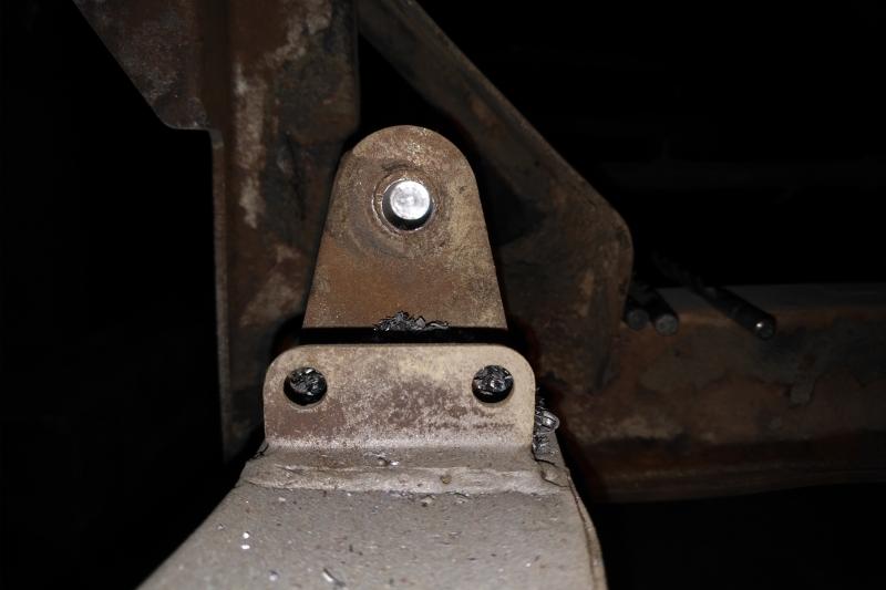

I broke a 1/2" bit last night and spent 20 min digging it out, so I do have some concerns about what to do it this happens too far into the bore.
Charlie and Tom, yes, I am considering cutting and replacing, 4 of the 5 major weld locations are accessible, the rear side of the front attached to the upright is not though and I am concerned about structural integrity if I have to grind for access from the front. A reinforcing plate from the front might remedy that though, but it would show.
The weld on the front side of the strut has a slight depression - if there was a tack or crimp, it might be here. If I give up on drilling, I will first try and grind here to see if the pin releases.
Going to try and source some longer bits and go from there - I am at the limits of the ones that I have already and am just shy of half way. By the way, even with a 90 degree attachment, I would have a hard time fishing the bits in there given the limited space.

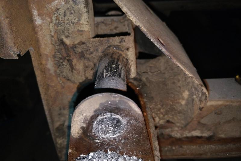

100$ worth of drill bits got me no where - currently cutting the DS apart (slowly) angles are brutal for all my tools. Using a combination of drilling, grinding, burr bits and those small drill-base cutting discs to break welds. The forward upright is really in the way, I could easily cut and fold it over, but I want that and the rear one to remain my guides for the re-install...
For the pieces I have cut out, the pin and sleeve are fused - I see no way they were coming apart without drilling completely through.
One option would be to remove the front assembly and crossbar so you could drill from the front - I opted to cut before I realized how difficult the angles are...not sure which would have been easier....
